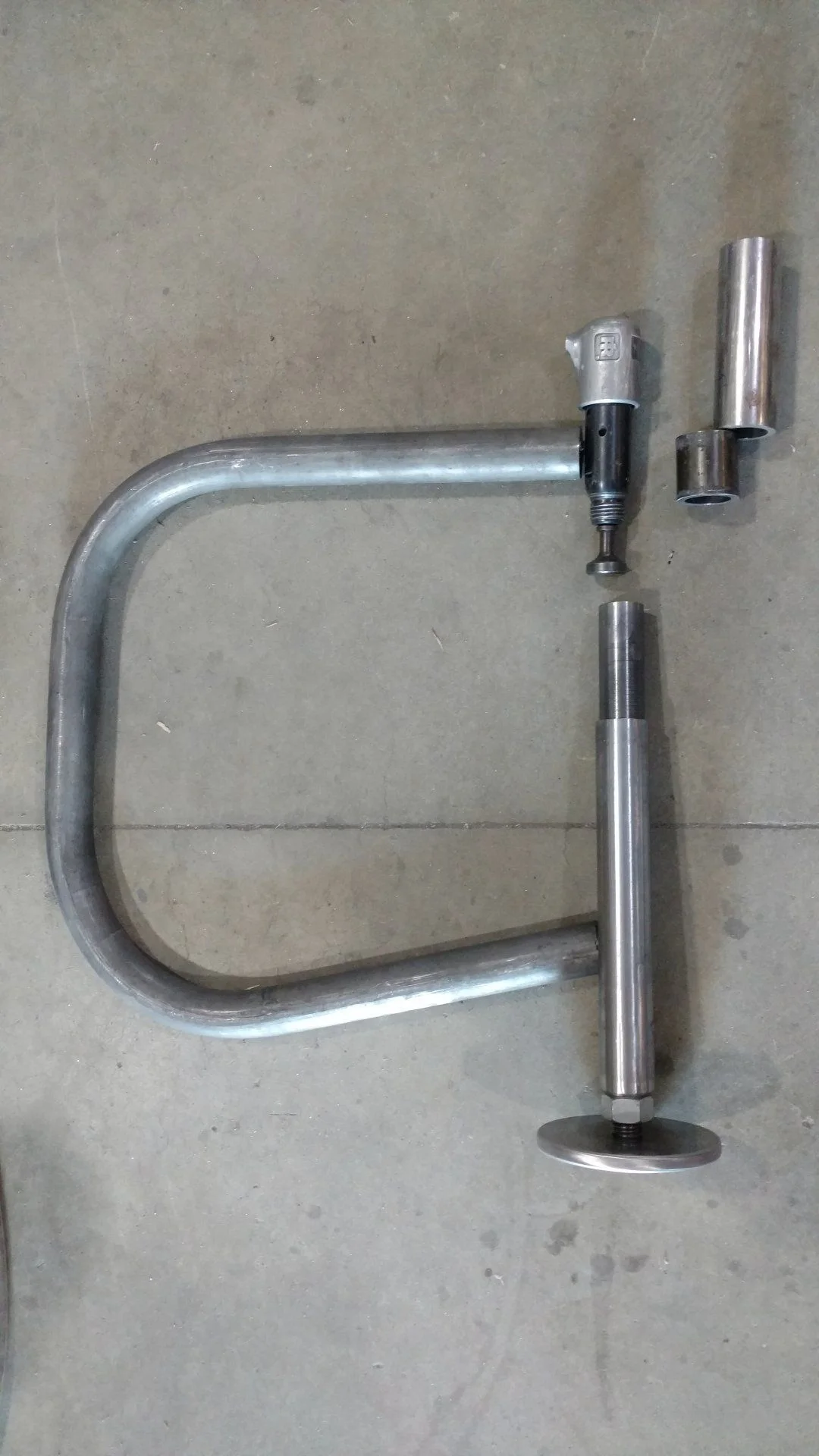

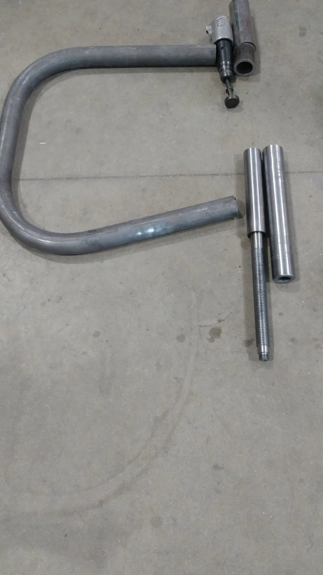

Made a little progress today.
Finished machining the adjustable lower die holder with a shrink fit to the threaded shaft.
I think this will work ok for what I need it to do. Little bit more machine work to the top mount then weld everything together.

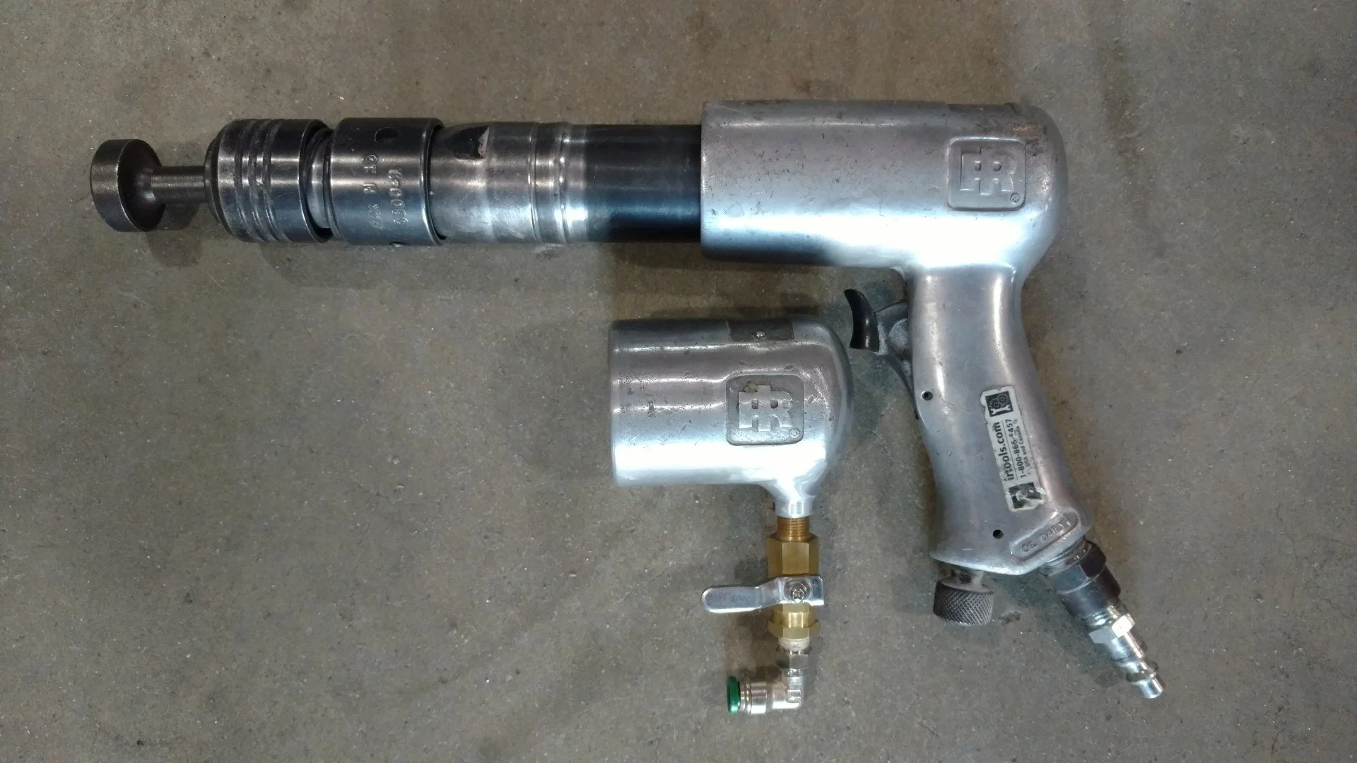

Cut the grip off an old air hammer and shortened the shroud then drilled and taped it for an air fitting.
