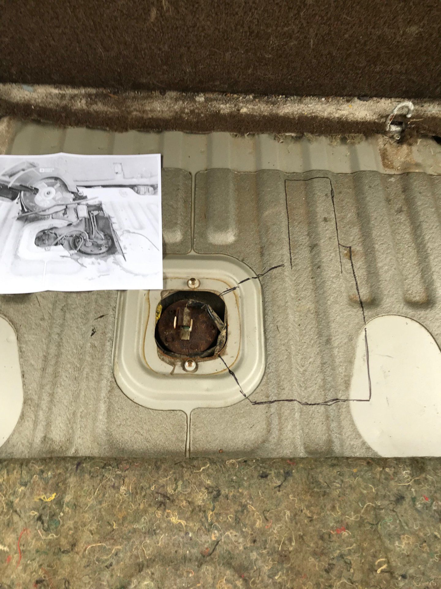

Plotted the cut to get at my fuel pump from topside. *note the very rusty screws in fuel sending unit. This will be a battle. Soaked with PB blaster, but this may not happen for a while.

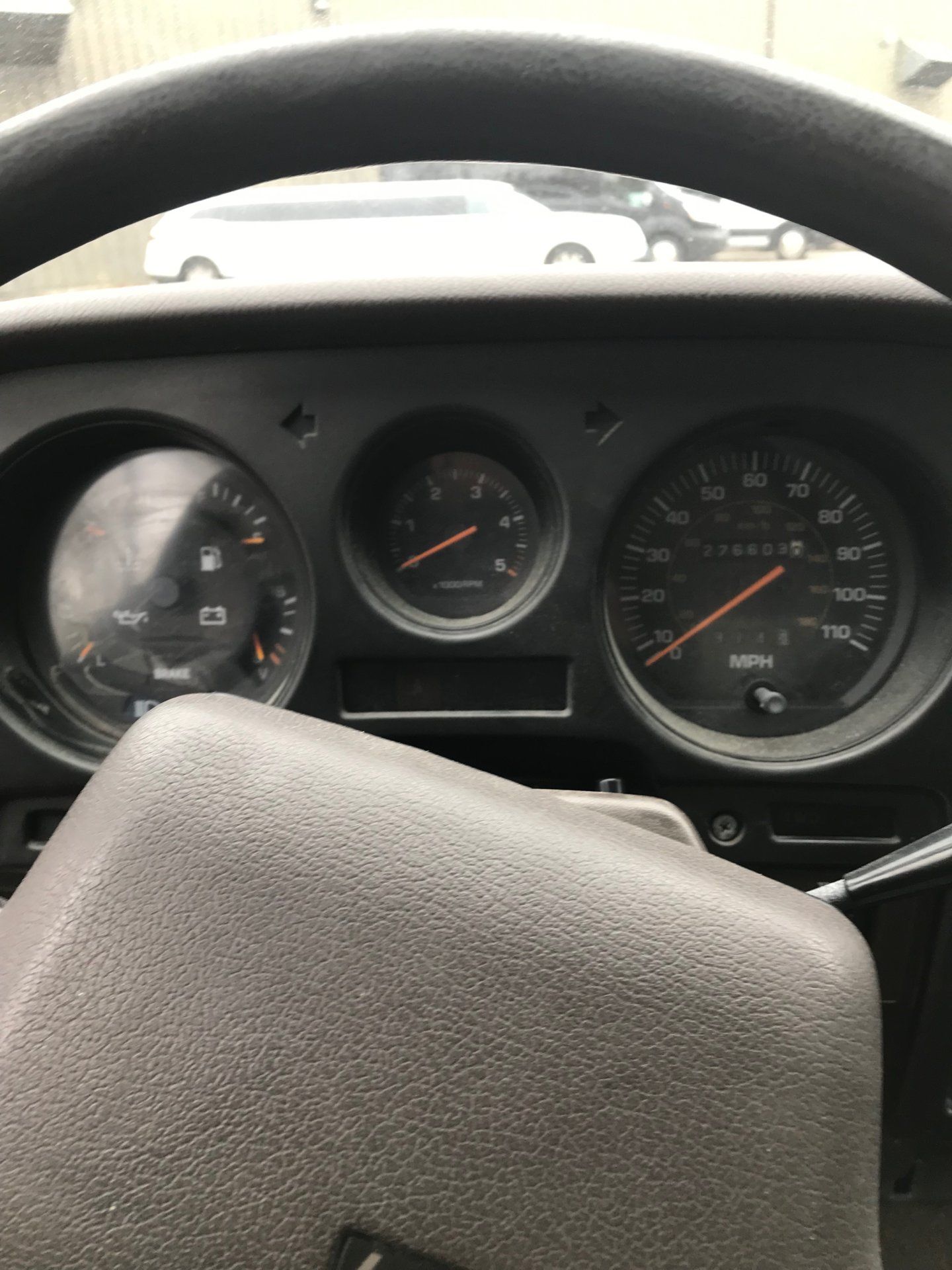

I had a strange thing happen this morning. Turned on the headlights and the dash lights came on for like a half second then immediately went out. All the dash lights, shifter light, etc.
All of my exterior lights still working, but dash lights just wont come on. Checked all fuses and they are good. Replaced a few thinking they could be bad but despite looking okay. Dash lights still only flash real quick when turned on but go and stay out.
Checked relays but kind of stumped right now. Last time this happened I had a blown fuse and that took care of the problem.
I did just replace all my lights with LED, but this also happened with incandescent bulbs before. So I'm not really thinking it was due to the bulb changes.
Any thoughts? Thanks
Check the ground junction in the harness that comes in the drivers side firewall. It is above the relays. You may have to take the relay panel loose (one 10mm screw at the forward section then it hinges down). then cut into the harness. The ground junction looks about the size of a match box and has several white w/black stripe ground wires running to it. If you see any burned wires or if the junction looks burned you know there was an issue. Also I believe the dash lights are on the "taillight" circuit so double check that fuse and make sure your tail lights work.
I tried to think of a good lie to type in here about why my dash lights were not working, but I'm no liar, so I'll tell it straight.
Went back out to solve the issue. Thinking it was a ground issue, but had been through this same issue with a quick fix before, it had to be something stupidly easy. Checked the ground bolt on the fender to be sure it was tight, since it was the last thing I worked on when changing the battery tray.. It had the slightest play so I tightened it up and put battery connection/corrosion spray on it. Went and turned on the lights, still nothing but a flicker. Immediately then reached for the rheostat and it was all the way down. How dumb did I feel then? Well, really dumb. I must have recently turned the knob all the way down for some reason and never turned it back up. Problem solved, but not really because you cant fix stupid.
