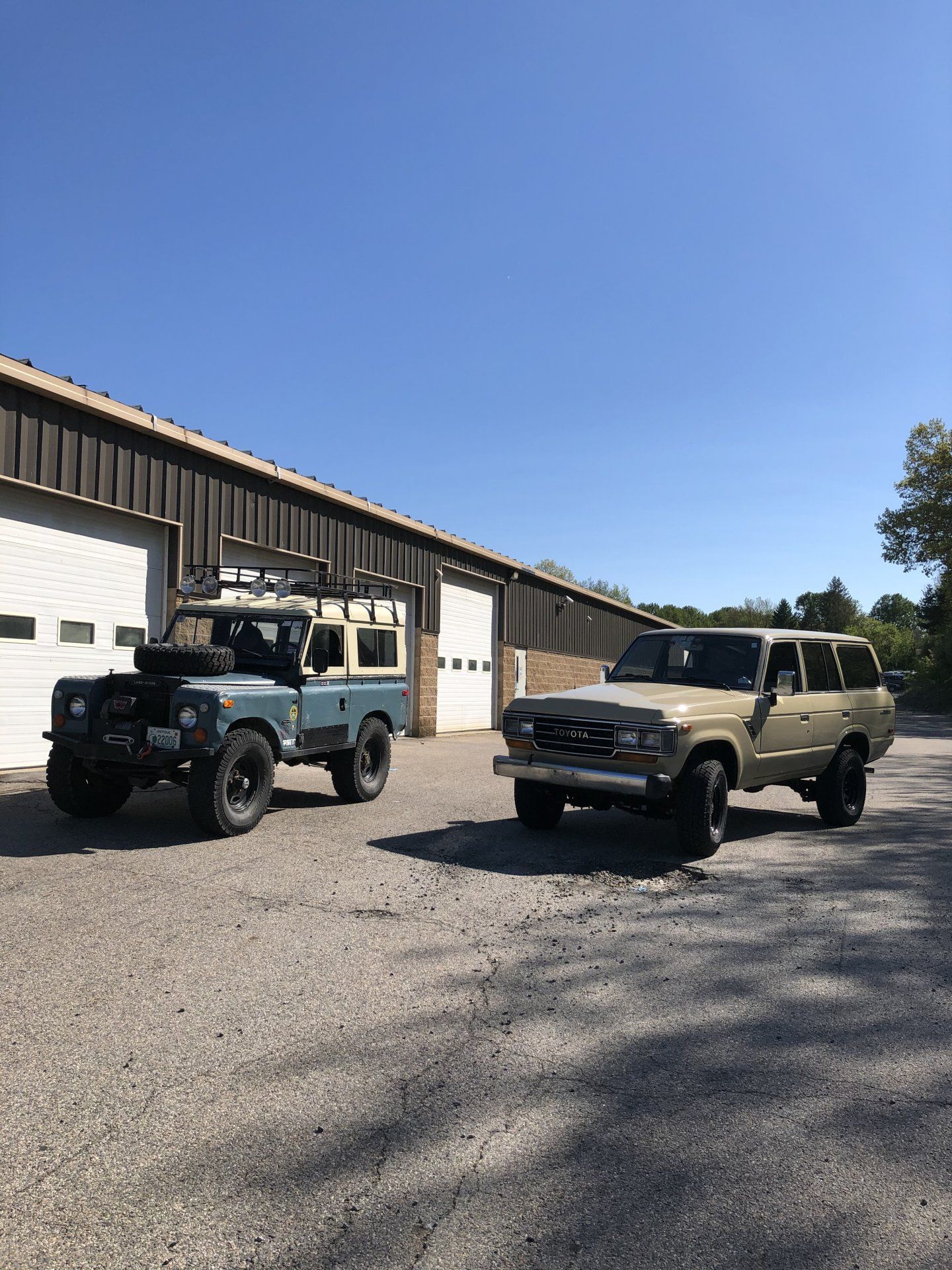

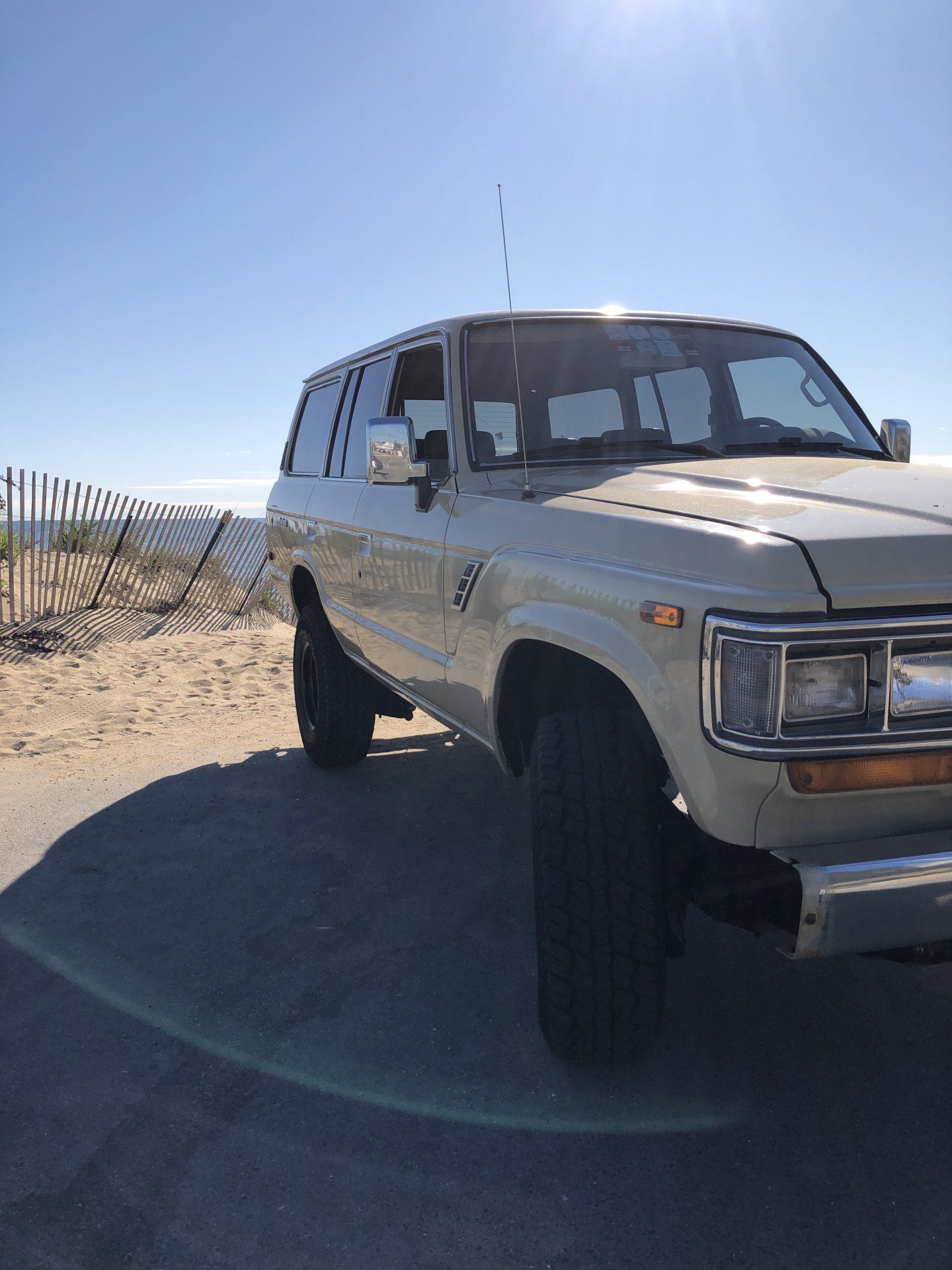

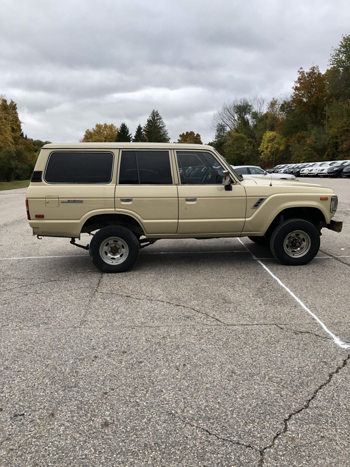

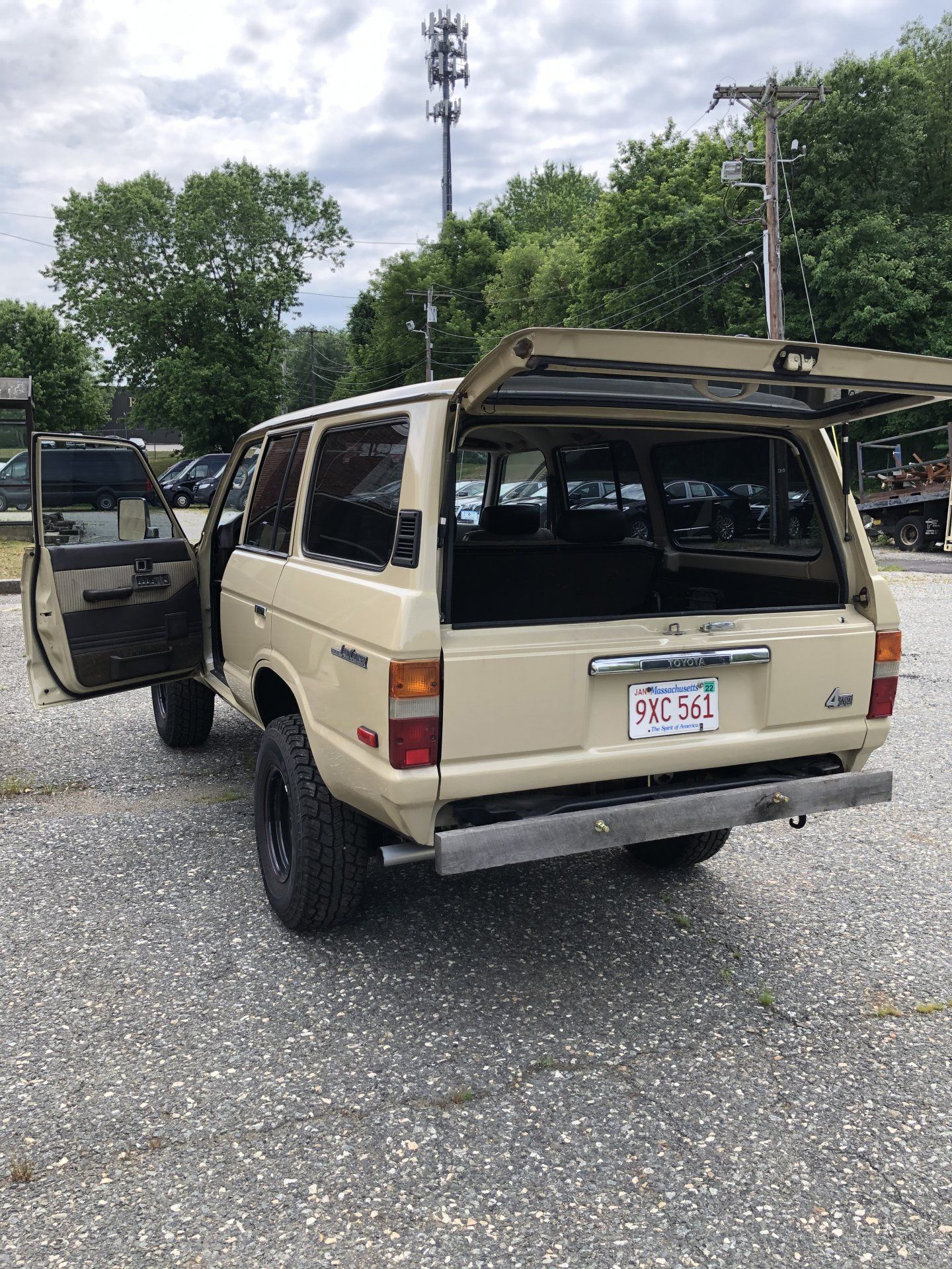

She’s not really done, and far from perfect. But she’s legal, registered and driven daily. It was my only vehicle for months until a couple weeks ago. I bought an 07 sequoia. Meh..
But this is how the cruiser looks and it’s fun!
That’s my buddy’s Defender with an LS engine in it. He does all our window tint. He’s one of the best Tinters in the world. The last one is the new kid hauler just before the 2.5 inch lift went on. We tested it out up north over the 4th
