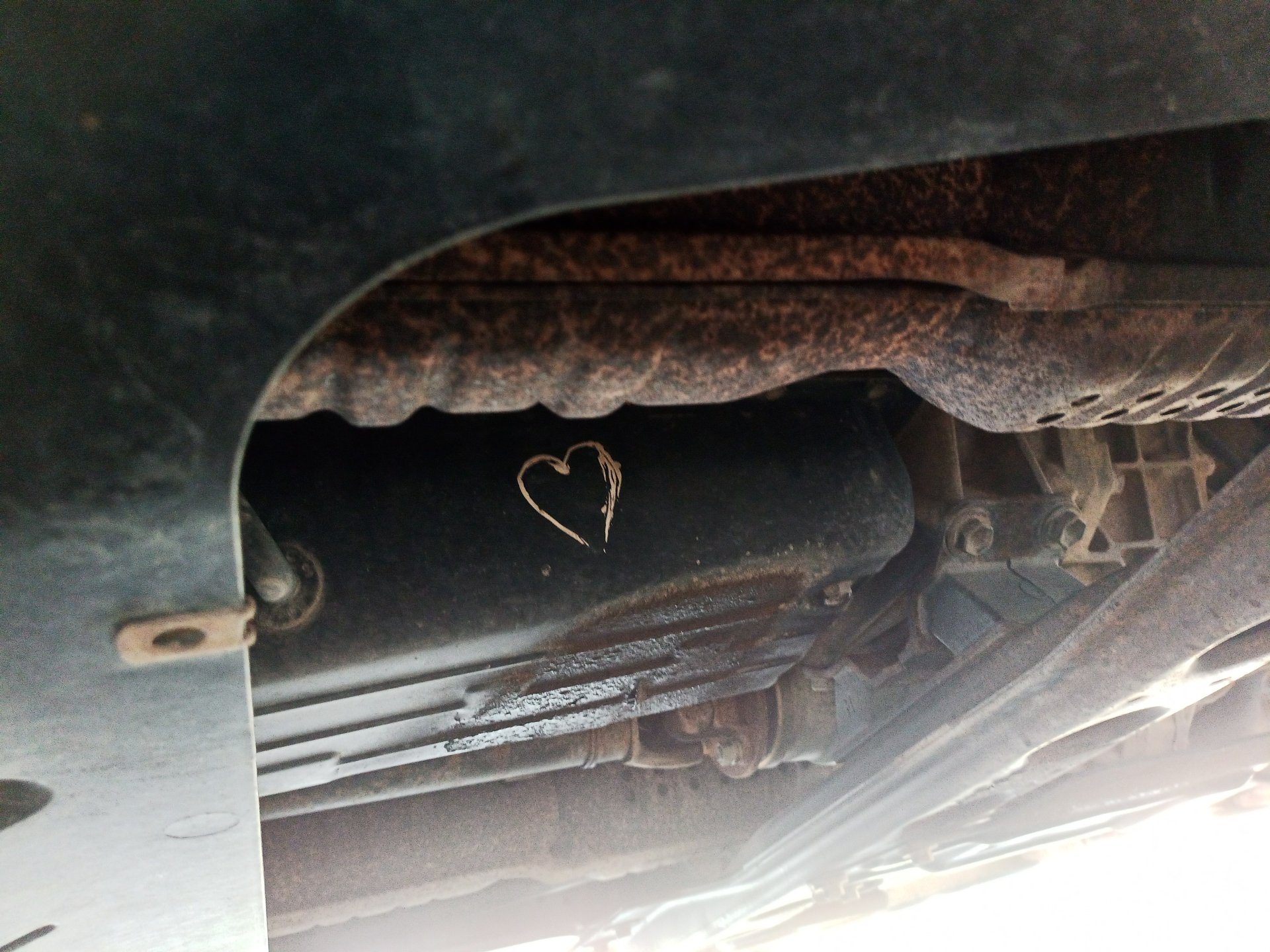

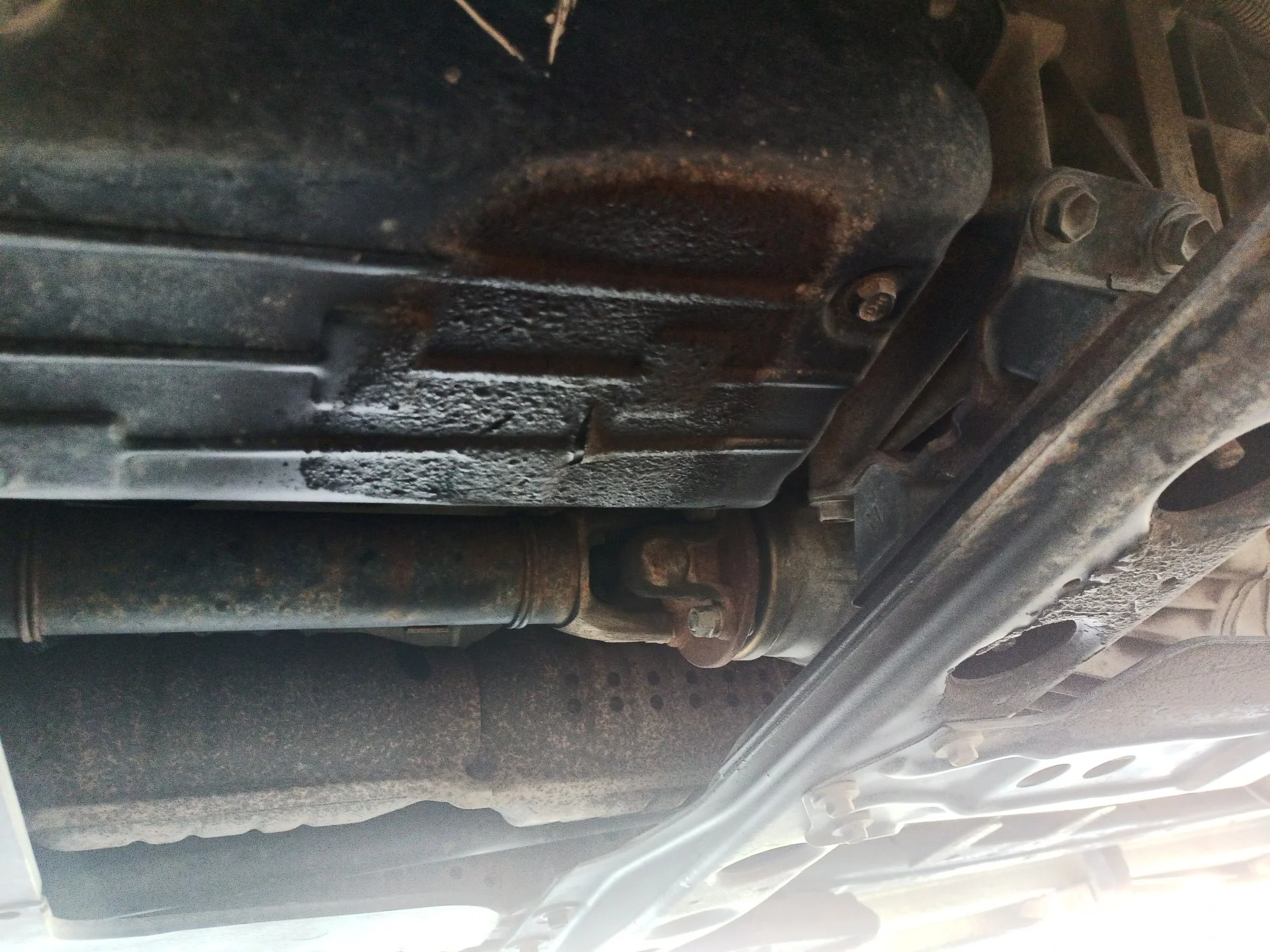

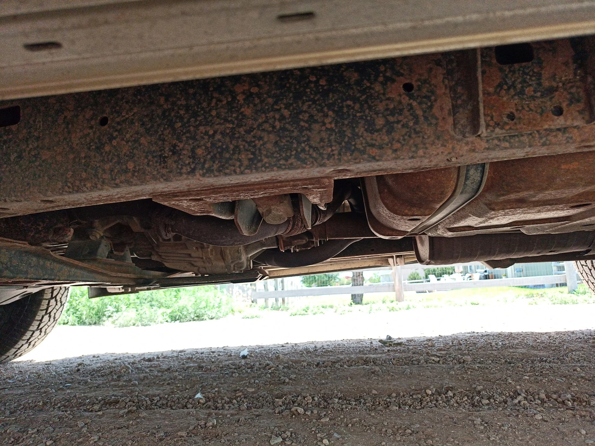

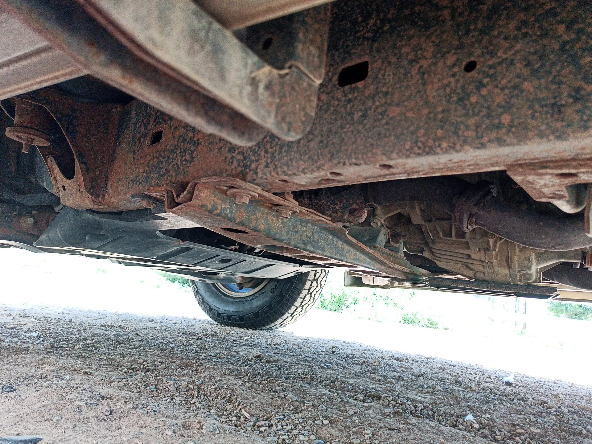

Underneath there's varying levels of rust I need to do something about. And then I noticed an important looking component that's really rusted through by rear passenger side tire.

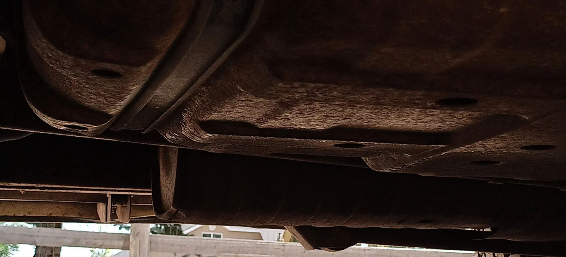

I think I found the problem. I heard hooves and looked for a zebra, but it was a horse...
This is my muffler, isn't it?

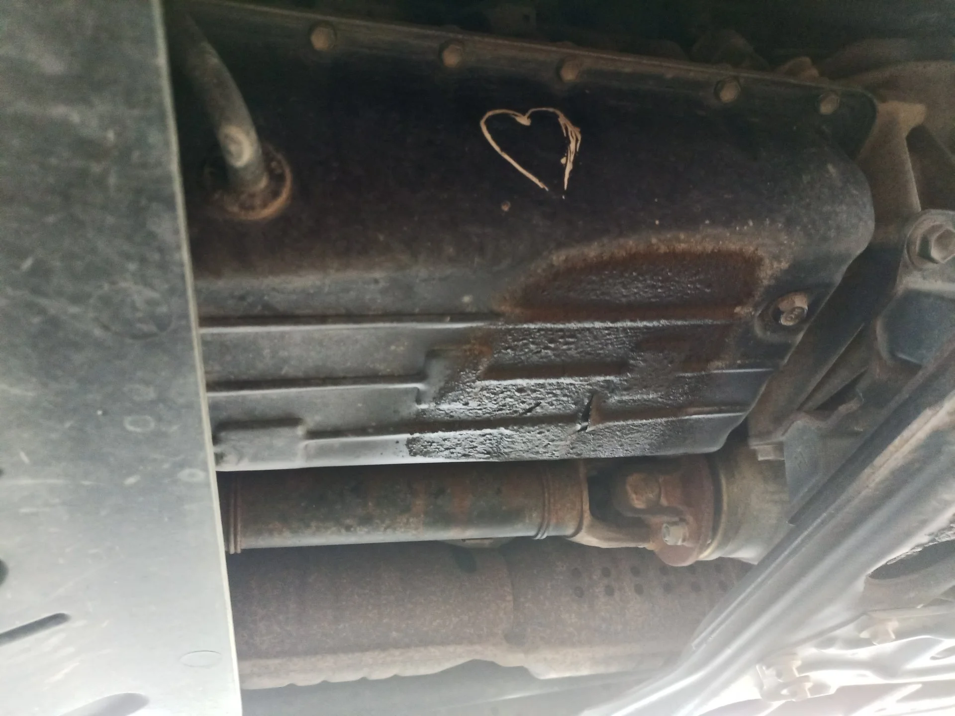

False alarm, it's just the paint.

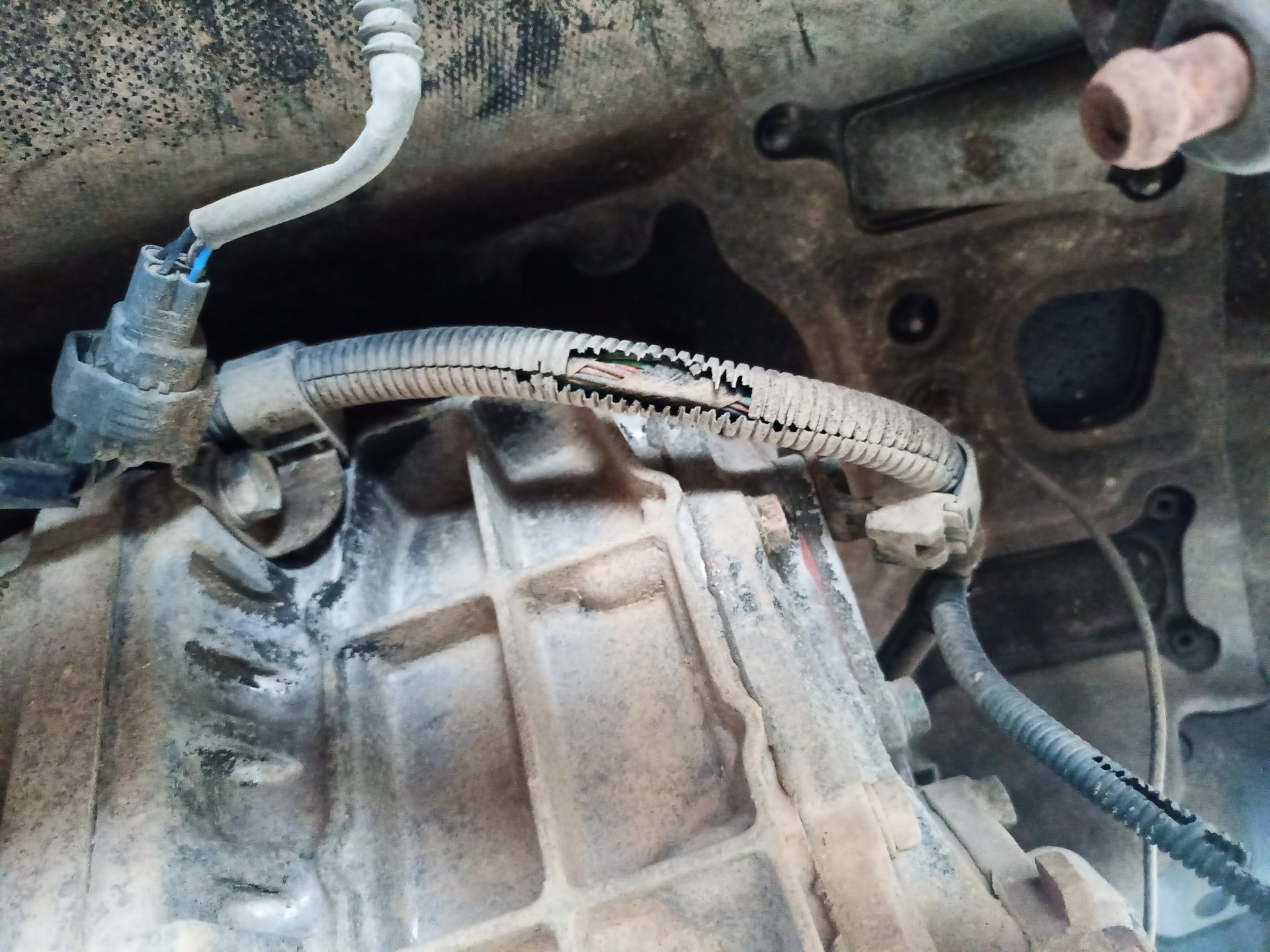

Another rusted out component, and a previous owner surprise, there's a heart drawn on it.

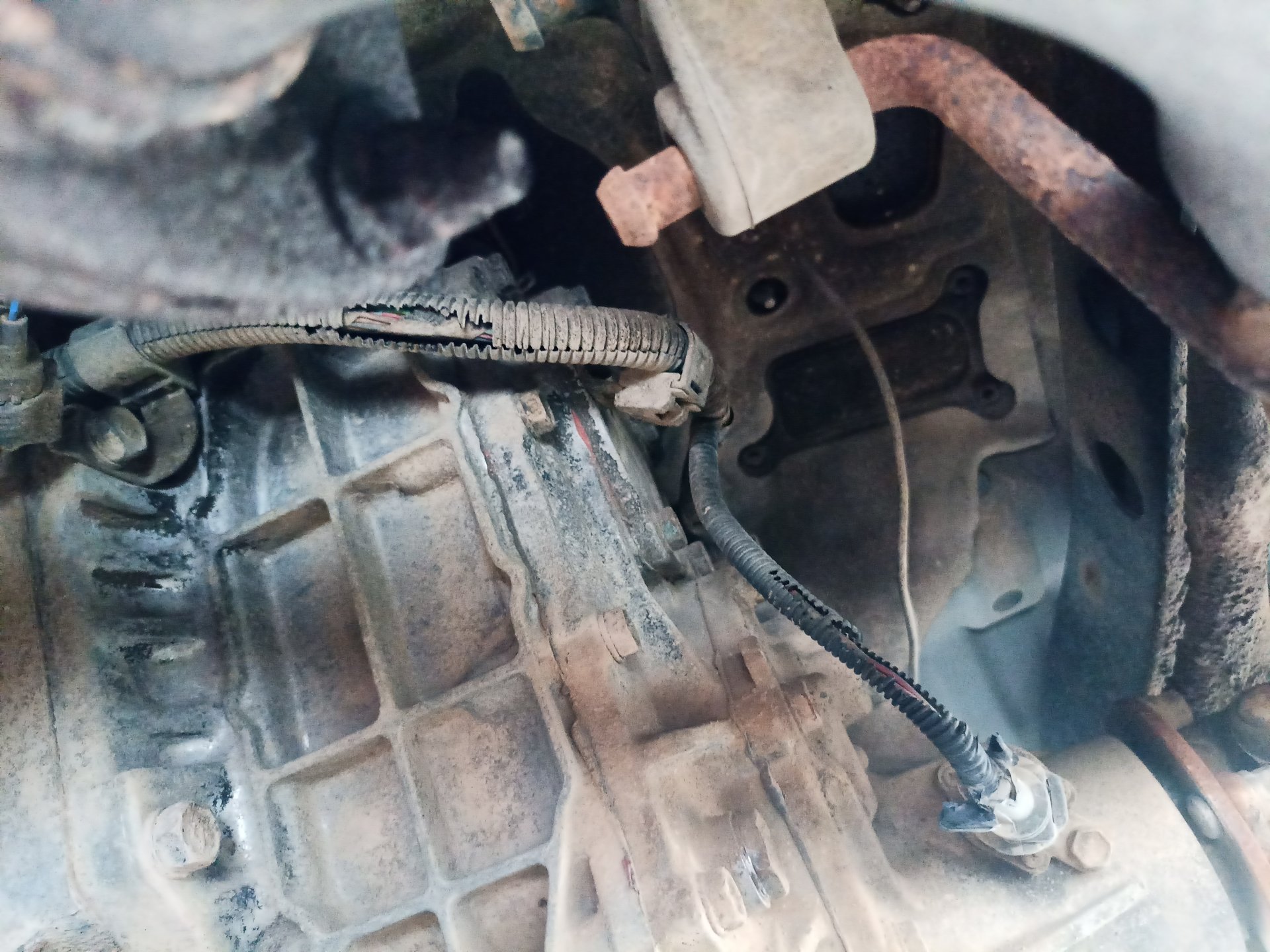

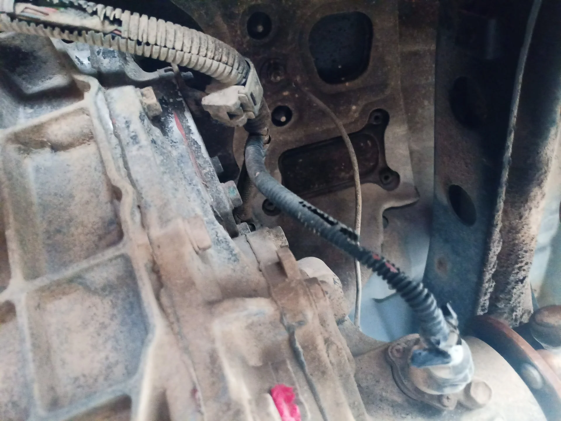

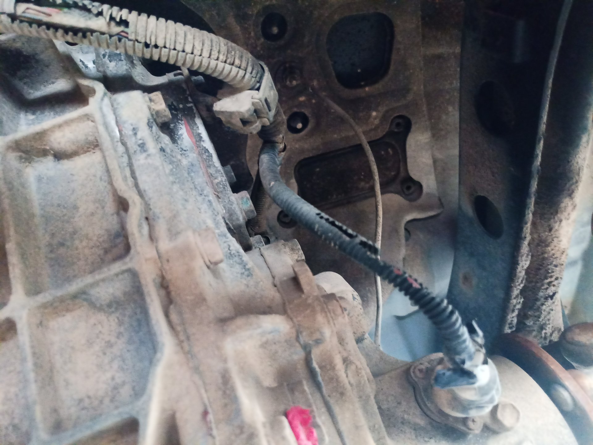

I wouldn't worry about the wire loom, unless the actual insulation is cracked. You can replace the split loom or wrap it. It's just there to protect the wire insulation from abrasion.
The actual wires are looking a little brittle, I have to take a closer look and make sure they're not bare.

I'd have a good look at the rest of the exhaust system before ordering just a muffler.
I'll give it a better look when I get time to crawl back under. I put some rust reformer on the underside last night to try to delay the inevitable. Found a spot of rot under rear driver mudflap. :mad: So much for my unrotted body.
I'm hoping to continue putting off replacing the catalytic converters indefinitely. A can of cat clean usually goes in and the codes reset and she's golden. The whole exhaust is covered in rust including them and they didn't get any rustoleum since I was told not to paint any exhaust components for safety reasons.
