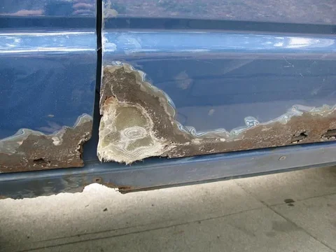

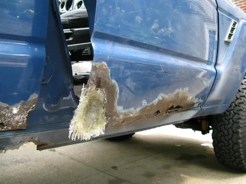

Haha, here is the status of my arts and crafts project. I have a few more layers of fiberglass to go before I can start with the bondo.
Not the most beautiful but the epoxy gets real hard and it's not going anywhere.

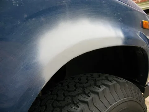

I did a little bondo action on some of the smaller rusty areas.
Here's the end result on the fender. I think I need to sand it a little more to get the lines out of bondo...first time using the stuff, so I'm still learning.

I re-did the front fender and it looks much better now.
The fiberglass patch is still curing and I will soon be able to trim it with the cut-off wheel and then start with bondo. There are at least 20 layers of fiberglass.

I just trimmed it with the grinder. I am going to put some more layers on and make it a little nicer before going to bondo. I think I'm pretty happy with the progress so far.

I don't mean to be a downer so much, but IMO, all that work will be trashed within a year or so if that rust was left untreated before 'glassing. Now, if you want to treat the work as a simple learning project, then I'm all for that, but if you are expecting a long-term solution I think you'll be bumming soon. Even treated, any remaining rust will still rear it's ugly head eventually.
If you aren't cutting back to sound metal, I say stop now, remove the glass you've done, and use phosphoric acid wash along with a quality rust abater like Rust Bullet, Zerorust, etc.

Ok Wile, thanks for the heads up. I'm going to pick up some phosphoric acid wash and some rust bullet. I'm not trying to make a garage queen, just want to impede the inevitable death by rust.
Sorry to be a buzz kill but unless you cut out all the rust it will come back. Painting w/ Rust Bullet or POR15 (or similar) will work for a long time but probably not forever. Simply grinding off mostly to bare metal and glassing will allow the rust to come back. If its just a beater and/or wheeler then its not a problem - if you want something more I would suggest cutting metal out and/or buying panels.
The rust is always worse than you think.
Those rear wheel well lips have rust inside the layers of metal - the rust will come back from between the layers.
