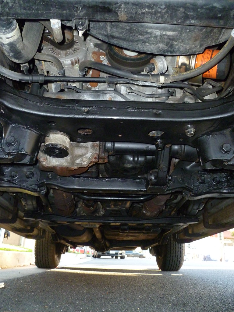

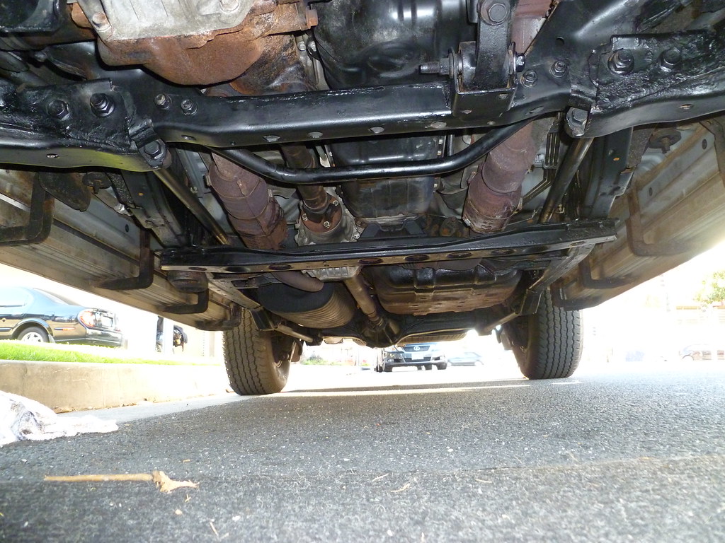

Rust bullet paint. Hands down best stuff money can buy. I painted the whole bottom of the lc. See below info.

I've used Eastwoods rust encapsulator, rust converter and chassis black paint. It all depends on how you apply it. I used a wire brush on an angle grinder to scrape away as much of the rust as I could, then used rust converter then rust encapsulator. It didn't hold up.
On some spots up front I just went with a simpler approach. Wire brush, then sprayed the area down with self etching paint prep chemicals I picked up at homedepot and let it sit over night. Then hosed it off in the morning. When it was dry I used Rust Encapsulator. It's held up great. The self etching paint prep seems to be some sort of muriatic acid that dissolves the rust.
