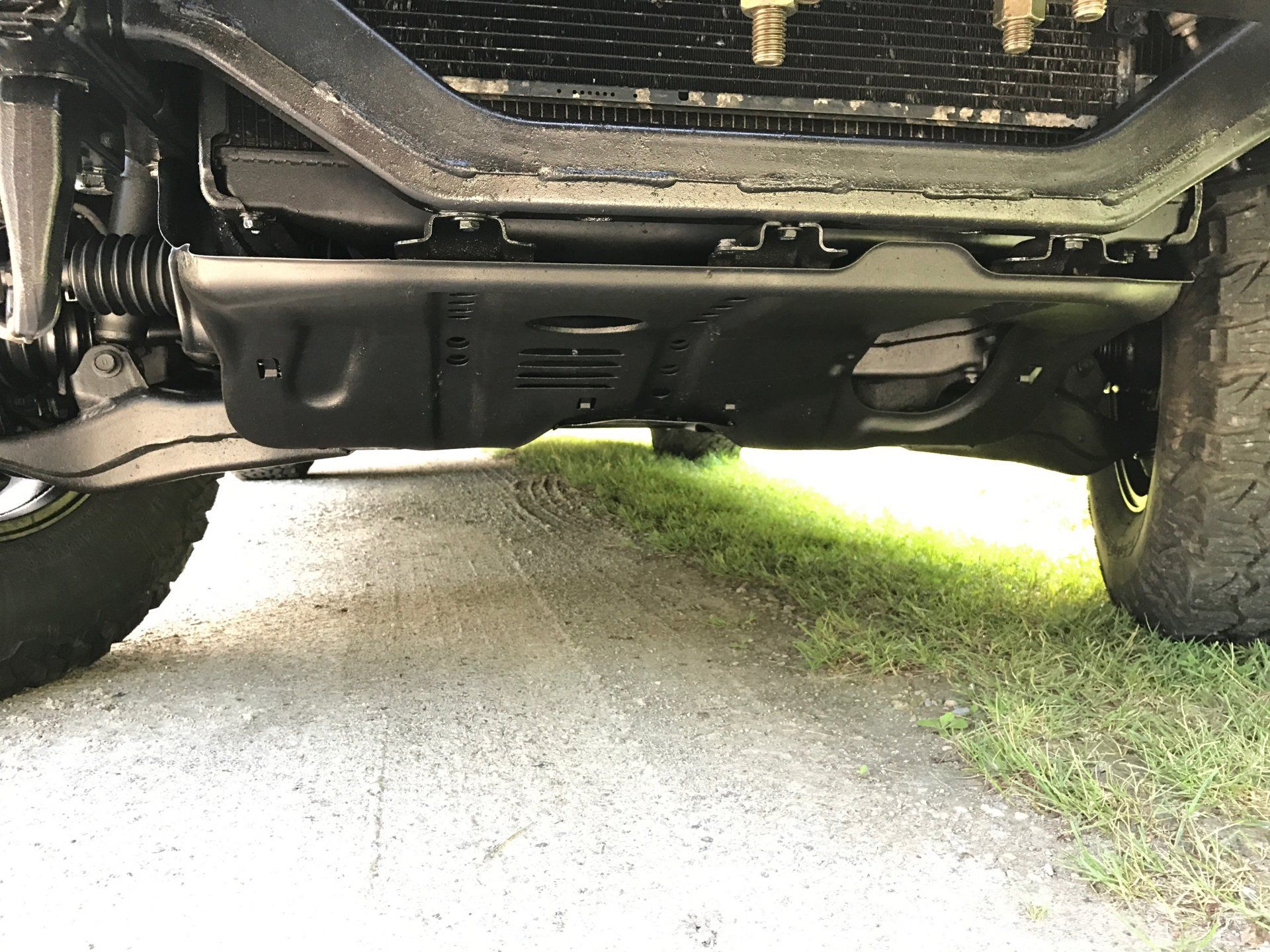

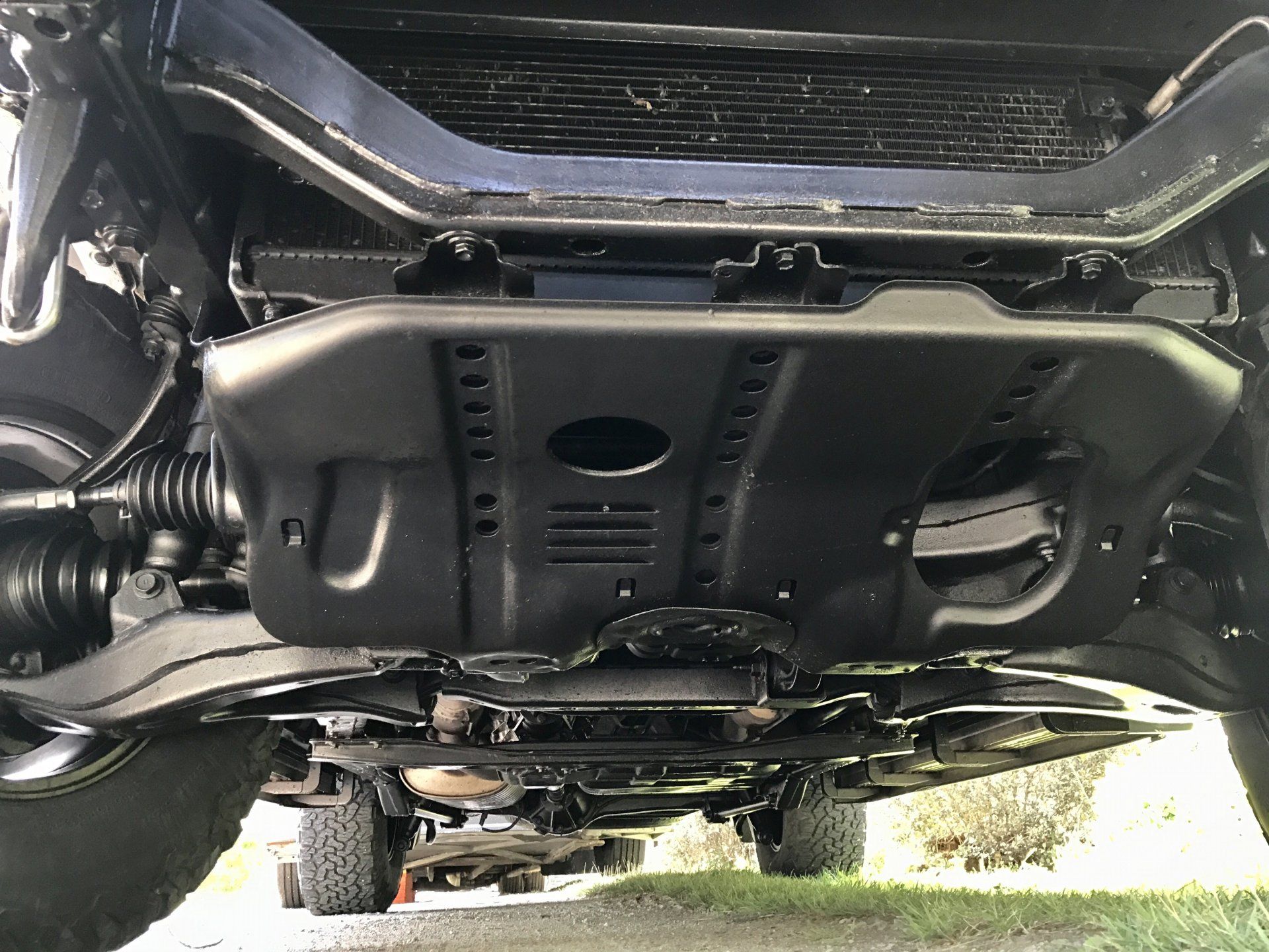

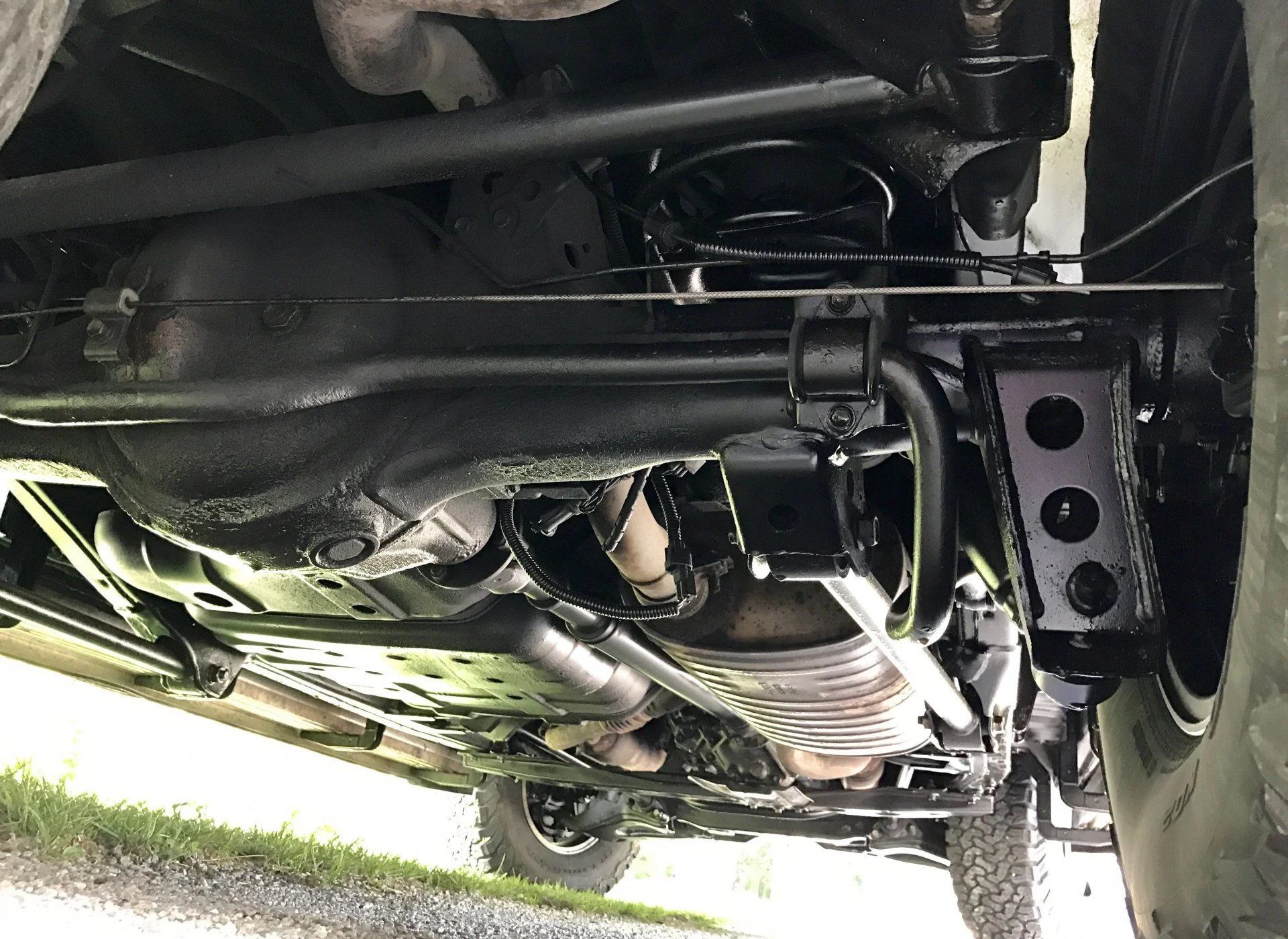

My neck of the woods in Michigan so I know some of that water sitting in there could have been an it salty :) even with water sitting there from the drain, the oil would have helped to displace it and maybe prevent the rust? This is my 1998 with 260,000 miles and several winters, and a few ocean beach drives under its belt. And no, I've never painted the undercarriage...

Never been painted. But assume what you want. The bolts may appear black because of the dirt accumulated on the Krown mist. Funny how many other people who have never seen my truck assume things about it. Anyway, to answer the earlier question, Krown charges me $120 to mist the truck. This includes drilling the holes the first time and misting every body panel cavity as well as inside the frame, undercarriage and engine bay. Every subsequent application is the same price. They just remove the plastic plugs and then replace them when they're done.

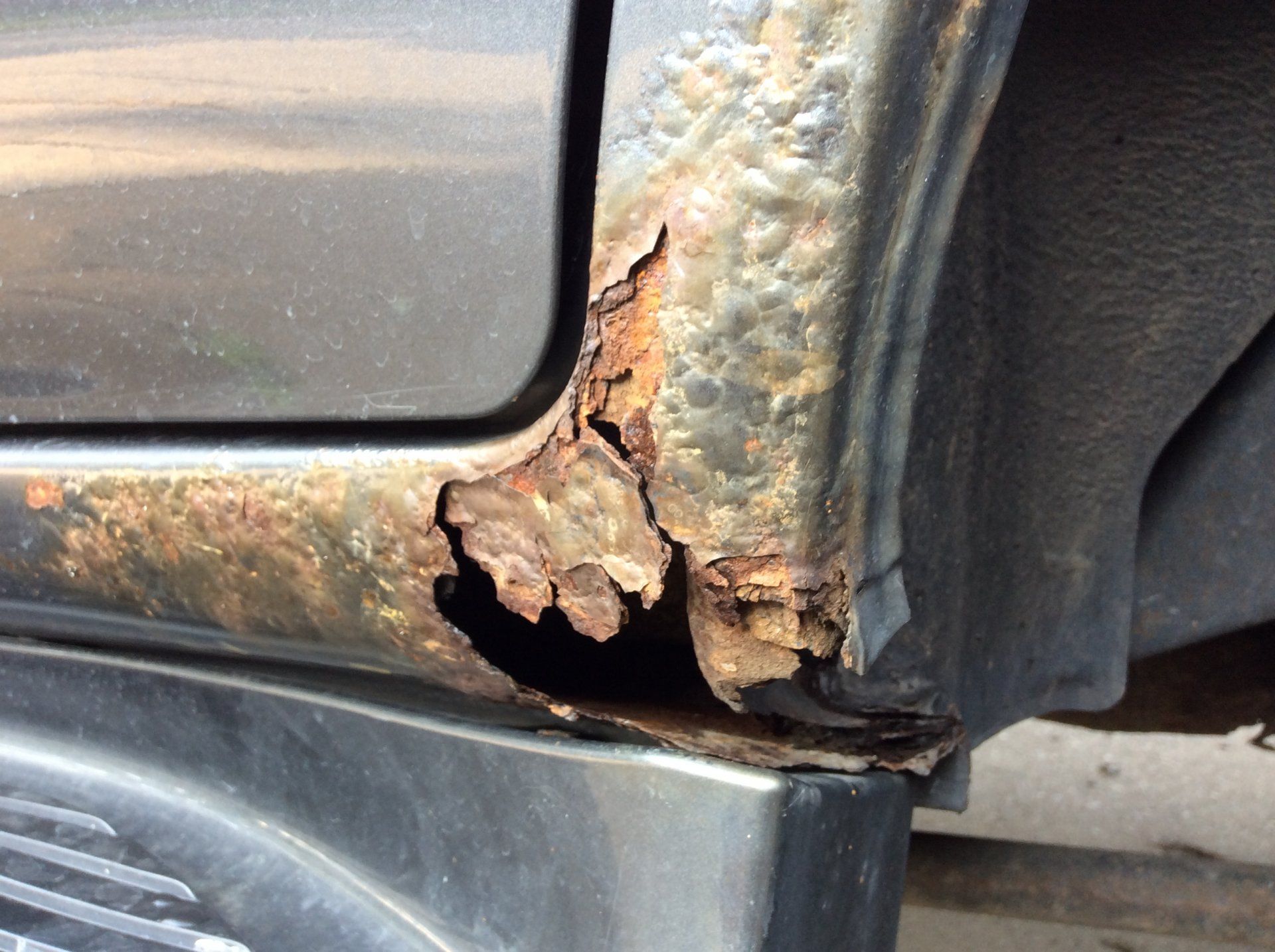

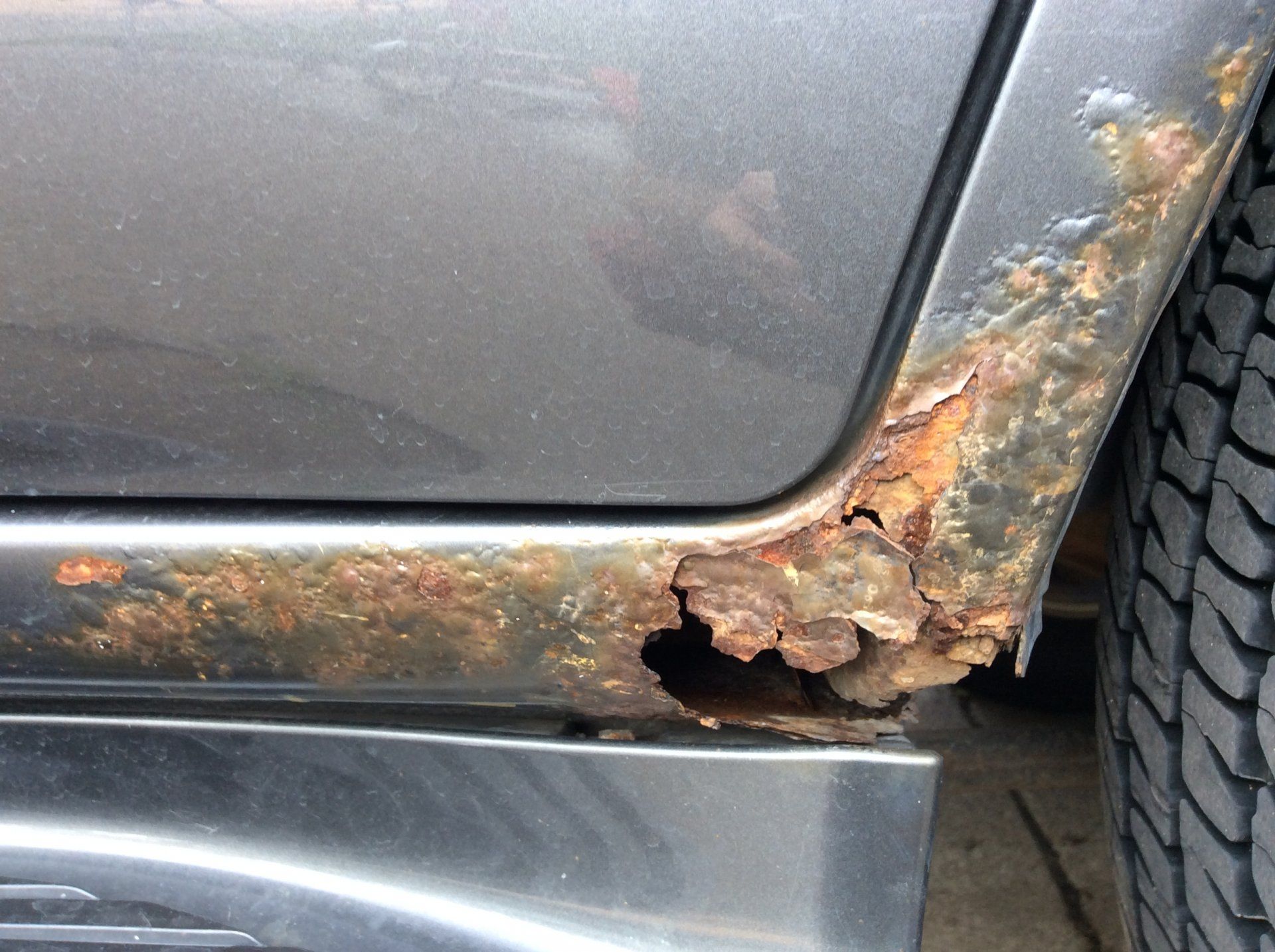

So starting last year I noticed some paint bubbling right in front of the drivers rear tire, didn't think to much of it with the idea that I'd take care of it in the spring.
Well spring came and there was a small hole, then it kept getting bigger and quick.
I could not figure out why it was happening there and not in the same spot on the other side.
Well, figured it out...the front sunroof drains dump into the rocker panel, the rocker panel is boxed and there are drain holes placed along the pinch welds.
Mine were clogged, not the sunroof drains, but the drains in the rocker panel, so water was just sitting in there eating away at the steel. It dripped extremely slowly so I do not think there was ever a ton of water in there, but still, enough to rust it out.
I ran the left rear tire onto one of my ramps, stuck the garden hose into the rust hole and turned on the water. The rocker filled with water until it overflowed.
Scratched my head, went inside ate lunch, took a nap...then I had a idea. Grabbed some hobby wire and the creeper and started at the back poking the wire into the drain holes and I got drenched.
I bet that thing held 5 gal of water.
My dad is a retired body shop guy so he and I are going to fix it before winter.
But I guess at least now I look like every other car on the road in the Rust Belt.
