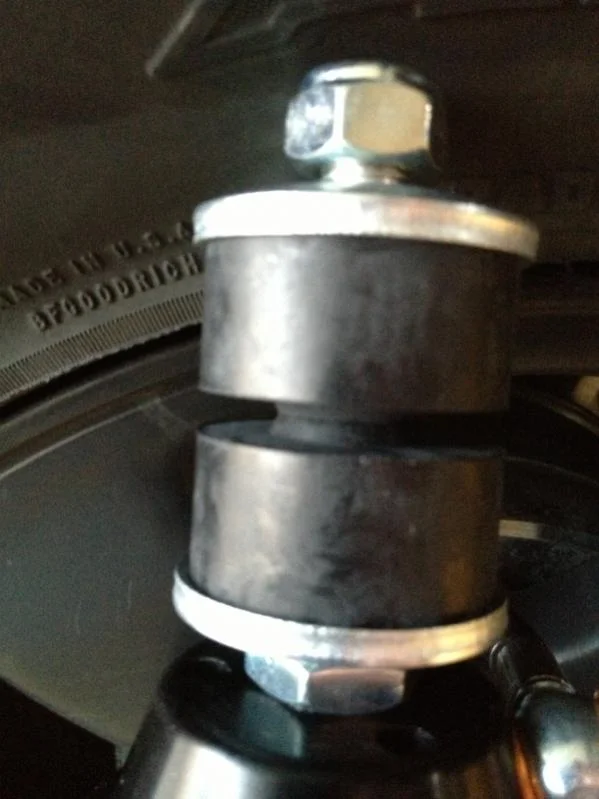

Ok. So i received new bushings on thursday from Glenn. They are the same as those in SDC's picture. Here's the pic again.
attachment.php
Couple of things to note... I honestly think my truck rides much better than it ever did even when i first installed the radflo's. I really think that the original bushings that they came with really didn't do the shocks justice. I will say though that I believe that I feel that the bushing could still be a tad bit larger (diameter wise) as I had to install, unbolt, reposition and rebolt my left shock as i kinda felt that the bushing wasn't quite wide enough the way the shock was sitting and it seemed as if it were missing the mount hole in a very small section. Then again, i suppose that if i had another person holding the shock and guiding it along as i tightened the bolt, then perhaps that would have made everything align the first time.
Another thing was, with these new bushings, it wasn't the easiest thing to get the nut threaded. I kinda had to create a lever of sorts to push the shock body up just to get it threaded.
I made sure to be mindful of the caliper, and any zerks (lca, caliper)
Now my bushings look like this.
