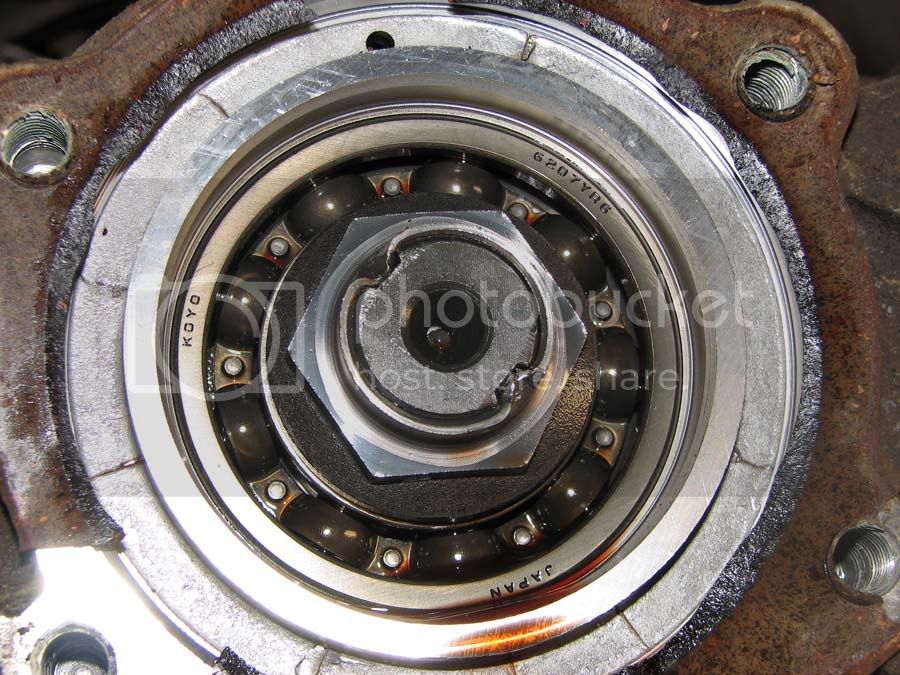

Hey guys, who's got a good method for removing staked nuts. I'm tearing into my t-case, and I've got the rear output nut "un-staked" but can't make any progress with the nut on the back of the tranny input shaft. Any suggestions?

It looks like there may be cracks in the case around the bearing. John

inkpot - I think those "cracks" are casting flash, but I'll take a closer look.
I definitely would. Them s***s don't look pretty.

Oh, and the "cracks" in the photo are indeed just casting flash. :cheers:
