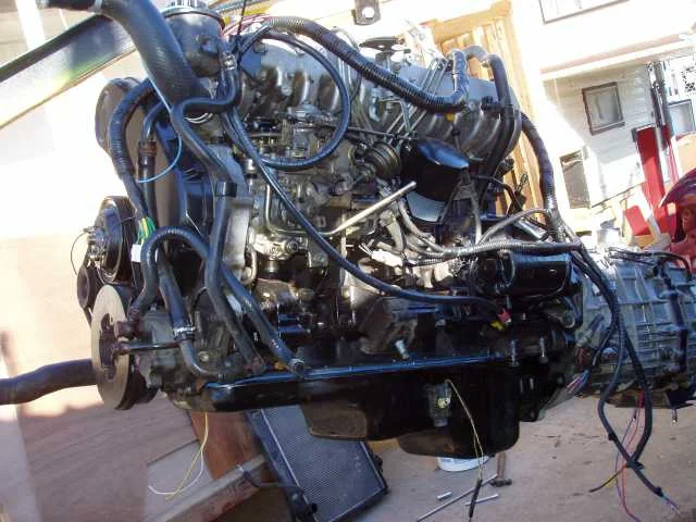

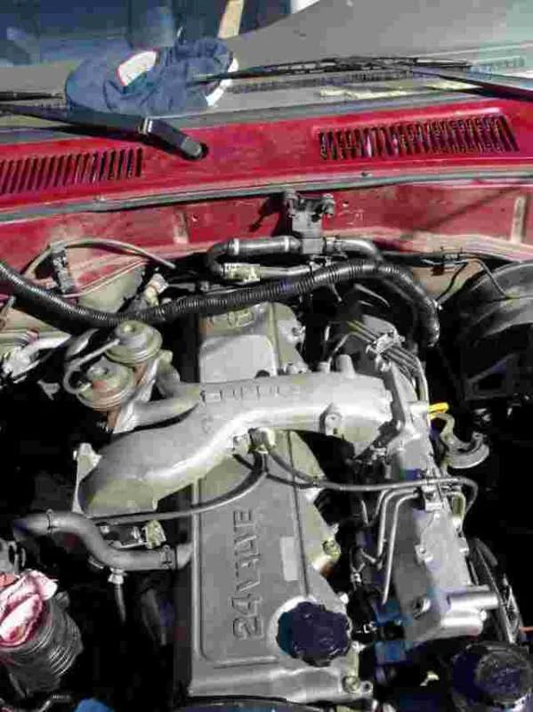

More
More
Thanks for celebrating with me!
Yup, it's the 5-speed.
I wanted to run SVO but I have heard concerns with coking associated with indirect diesel injected motors. Right now I'm running Bio Diesel 100% Virgin source.
As soon as I figure out my attachments I will share more photos. Cheers.
