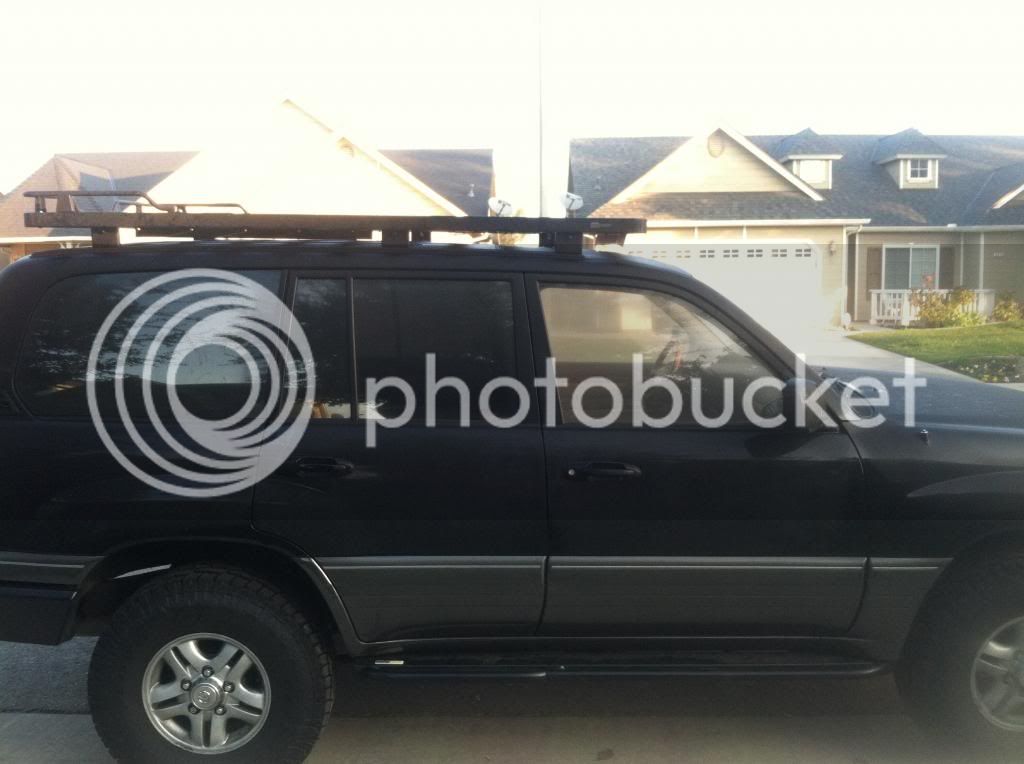

I just installed the FR Slimline II with the tall legs this weekend. I'll try and take some pics tomorrow. I'm glad I went tall as I really like the ability to mount a table underneath.
I skipped the expensive stainless table sold by FR (about $280 if I remember right) and found a 48" by 28" table at Walmart for $30. It won't last near as long, but I can replace it several times over for that price.

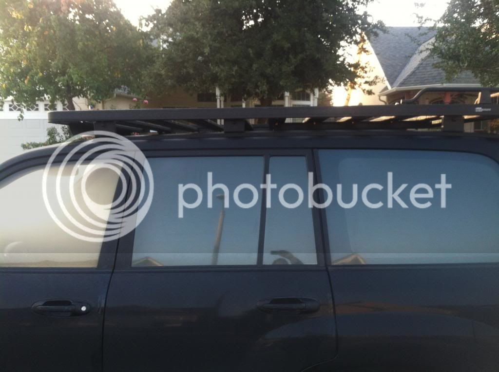

Sorry, my wife has the camera. I quickly shot these as I was heading to work.
Right side. Shows the mount for table, wind deflector and expedition rail.
Left side - even less clear
I hope this helps.
LCTom, HUGE help. Thank you for the photos! That is the set up I am going to with now.

I purchased from frontrunneroutfitters.com because they are here in California and I was in a hurry. Super quick delivery, so I only have minor regrets over having to pay sales tax.
The instructions show mounting points for 6 mounts - tall ones (70mm) at the ends, smaller one (60mm) toward the middle. You'll notice that there is a bigger gap between the second set of mounts and the rear mounts, than there is to the front. That is per the directions and I'm pretty sure it's calculated to conform to the roof line. After I had assembled it, I found another set of smaller mounts (60 mm) tucked away in the box. I'll probably install those later, but the rack seems rock solid as is, so I'm in no hurry.
The install is straightforward. Plan on a few hours. It took me a while longer because I'm uncoordinated and usually have to do each step two or three times before I get it right.
There are a lot of great racks out there, but you can't go wrong with the Front Runner. I'm amazed how much gear fits up there.
