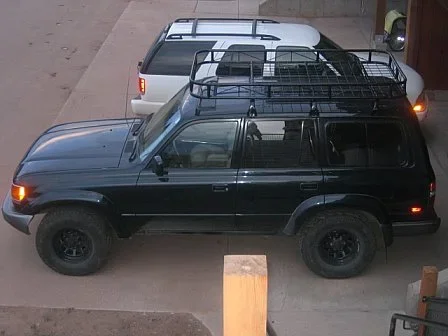

OK, finished with the rattle can over several days. I'm happy with the results as I've accomplished my 3 goals with this project:
1. Stay out of trouble while the wife is out of town.:)
2. Create a functioning roof rack that can hold my spare & plenty of other gear in order to pursue a high clearance, receiver-integrated rear tube bumper.:D
3. Fool people into thinking I know what I'm doing.;)
Hope you guys enjoy!:beer:
Last but not least...
P.S. COMING SOON...
My next stolen idea: I have 68" sliders from Adam at 4xinnovations.com, some 3/8" plate steel, and some more beer!:beer:
This idea is stolen from Box Rocket's bargain sliders which have proven themselves. I also got the hot rolled steal from Adam (because he had them sitting around), and am planning cat protection.:cool:
Also a trip report on the Aspen area trifecta the weekend before last: Taylor Pass, Italian Creek, Schofield Pass (NOTE: Pearl Pass is still closed by snow).:doh:

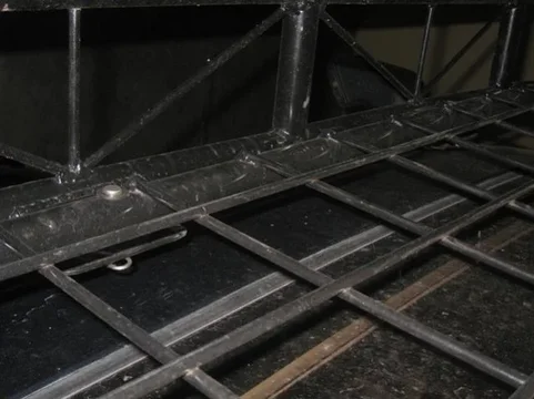

Finished up the hatch and was able to try it out on a trip to Great Sand Dunes NP. Here are a few pics:
1. Here's a not so great overhead view of the hatch. You can see the welded hinges in the foreground and the frame for the hatch that fits inside the outer frame of the entire rack.
2. A close up of the SS pins I used to secure the hatch. The stops for the hatch have neoprene attached to them to avoid any noise.

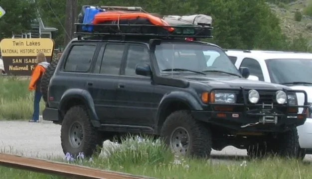

3. The rack loaded up on our way back from the Sand Dunes at Twin Lakes. There is roughly 1/2" clearance between the rack and the roof now.
