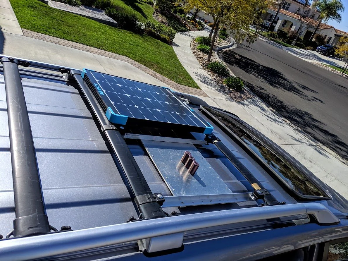

At least a mockup of what 100W and 50W of solar on the roof will look like.
I'm setting up a portable solar briefcase with a couple 50W panels. Since I car camp, tent camp, and RV with a travel trailer, I wanted this portable for use in any form of travel. Other factor is that I park under shade when possible, which means having a portable panel is the only way to go. That said, no reason this couldn't be setup for both mounting and portable use with the right mounts. With some Anderson quick connectors.
So what does 100W or 50W worth of panels on the roof of the LX look like?
1946392
1946393
This would be exceedingly easy to install permanently. Some mounts, and run the solar wire down the rear hatch between the weather seal. Would be adaptable to a hard mounted dual batt setup, or a portable Goal Zero style unit (which is in my plans for future... once they upgrade the Yeti 1000 model with USB-C).

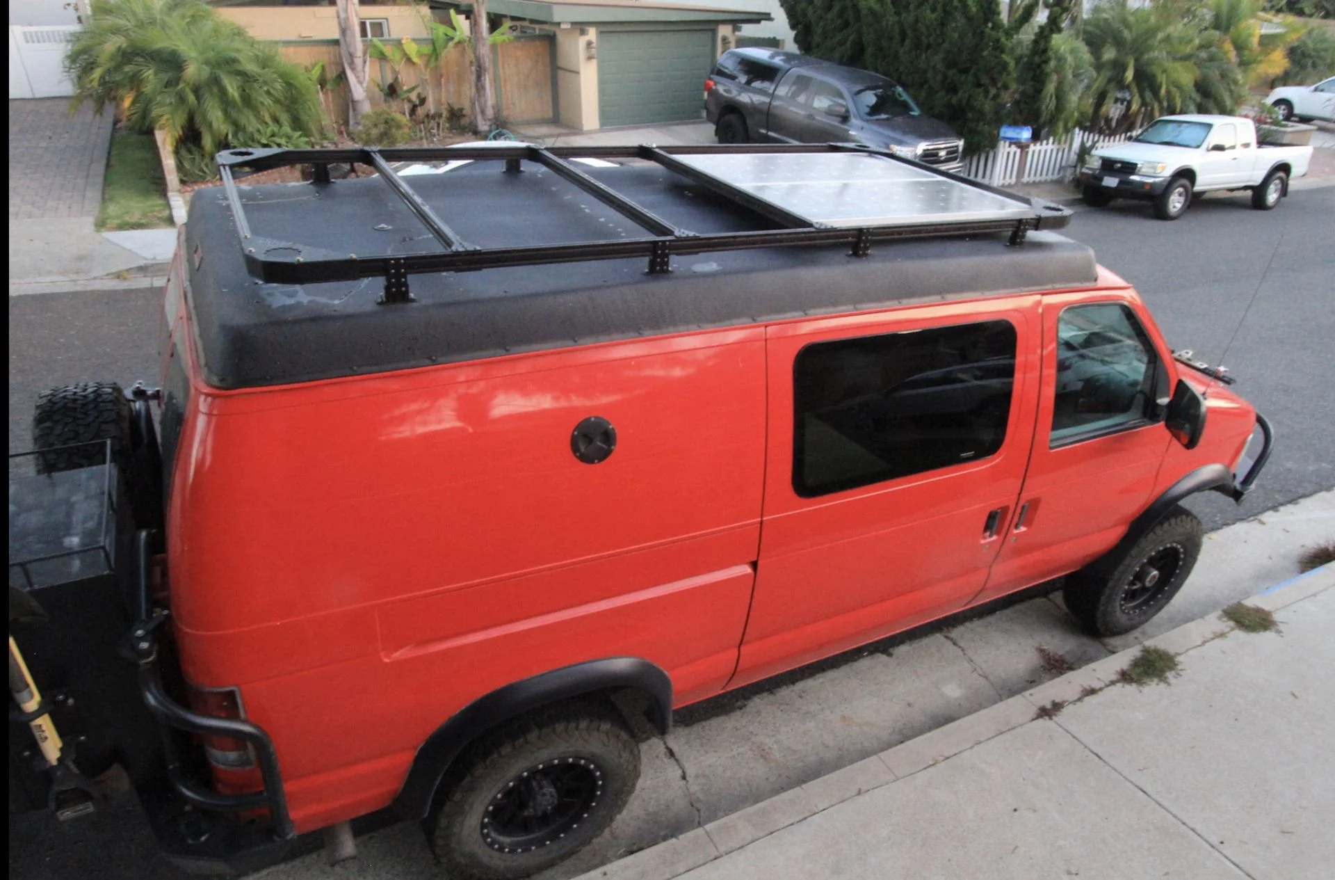

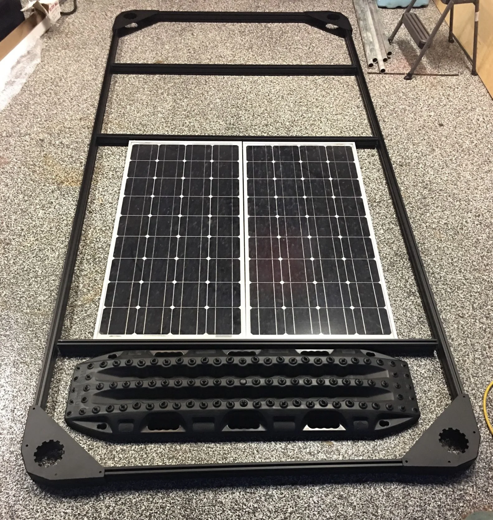

As for low profile, on my previous van build I had two 100 watt panels mounted inside my 80/20 T slot rack. It kept them protected and also allowed me to use the full rack when needed. Could use the same idea with some of the 200 series T slot racks. Or even just two 80/20 cross bars as shown elsewhere in this forum.
That's a great looking....rack!

I have the structural t-slotted extruded aluminum to follow @tbisaacs recommendation for adding capability to stock roof rack

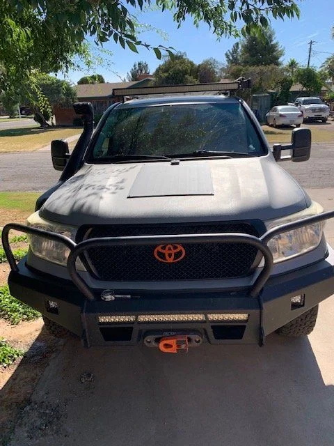

I found some stronger than the 3M, Gorilla molding tape and mounted it directly to the hood, I can always scrape it off or use solvents to remove it.

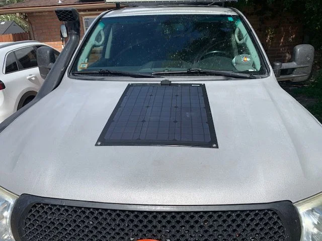

Here's the 55W panel I put on at the beginning of the summer. I carry too much crap on my roof to put panels up there. I upgraded to a big Group 31 battery and this keeps it well topped off with the ARB in the truck all the time
IMO hood mounted solar is the way to go. You've got flexible panels out there above 24% efficiency which is great. The Trailpower team is getting over 160W from their hood setup on their GX and our hood (well pre 15') have about the same amount of usable space.
