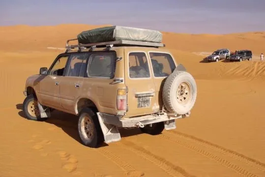

This is the only pic I have of my ladder, sorry it is not a good off road shot or anything. Not even me in the pic...
I am pretty sure it is Jaos (same as the rack).
It is pretty sturdy, but does add a little weight to the hatch, possibly stressing those components. I don't leave it on all the time...
Sorry, just re-read OP, you were looking for SIDE mount!
