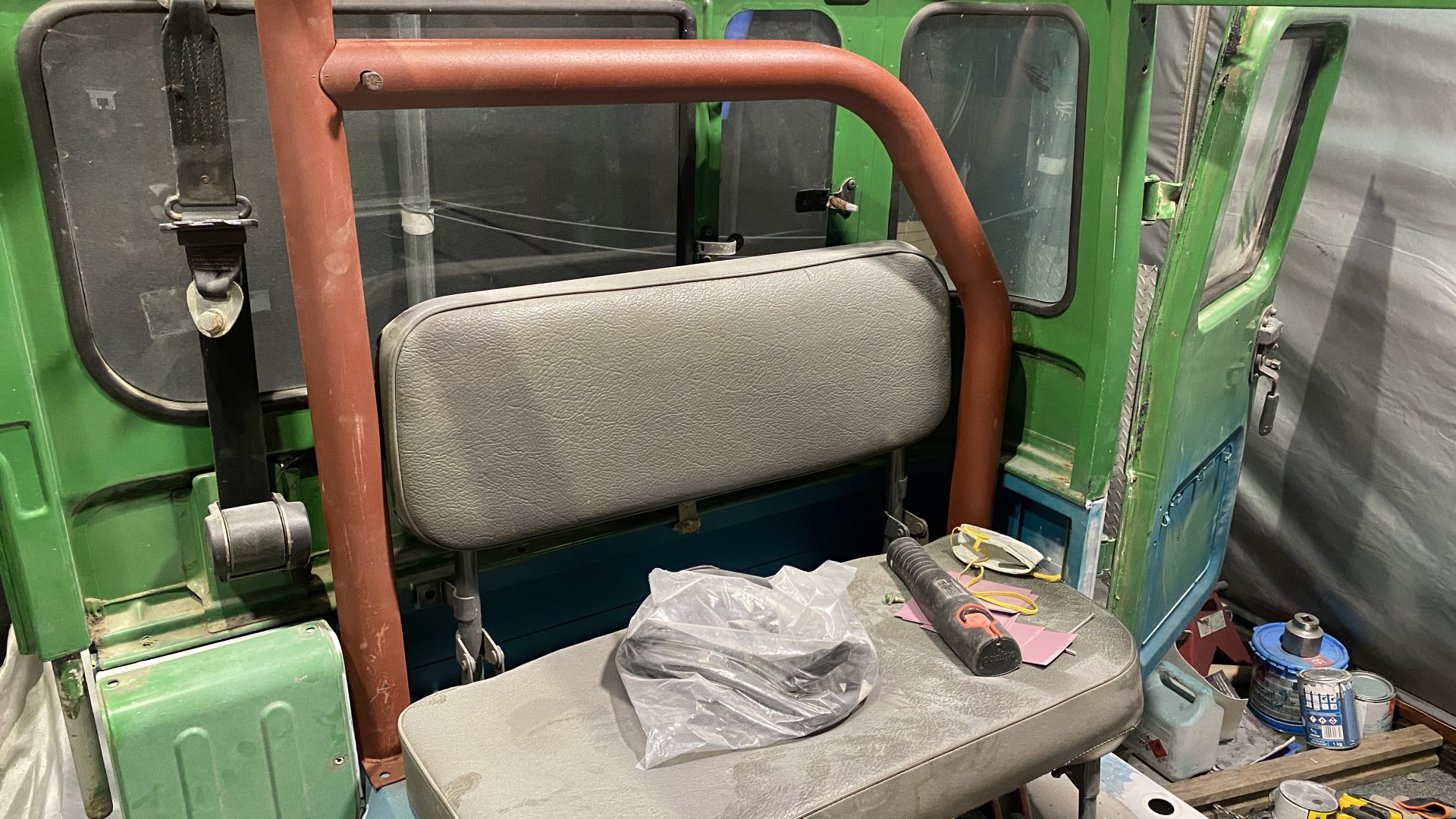

This is the roll bar that came with my 68' FJ40.
I don't know who made them but as you can see, the double bars and the angle iron that runs along the base makes it impossible to mount jump seats in between the front & rear bar.
But they seem to be pretty stout so I am inclined to use it instead of my jump seats. However, mounting the seats inboard on an adapter plate is still a option unless they would end up knocking people's knees against each other.
I believe I would need to move them in about 2" in on each side.

I'm pretty sure it's a smittybuilt bar. I seem to recall the double bar was for running in the sand.
Conferr had a double bar like that. They also sold bench seats to replace the jump seats.
Smittybilt made a “sandbar”. I’ve had 2 from what I could tell and they looked the same as this one. Double bar with flat plate welded between the two bars. Thinking was if you rolled in sand it was more surface area so you wouldn’t just bury the single bar in the sand, crushing and suffocating all occupants and countless beers being lost as well.
When I bought my Smittybuilt roll bar (1974) from Man-A-Fre they also sold that Sand Bar. Still have Man-A-Fre catalog with it. My Smittybuilt has tabs at the top of the tub. Set a small piece of angle iron bolted to the roll bar and to the top of tub. That require drilling holes.
