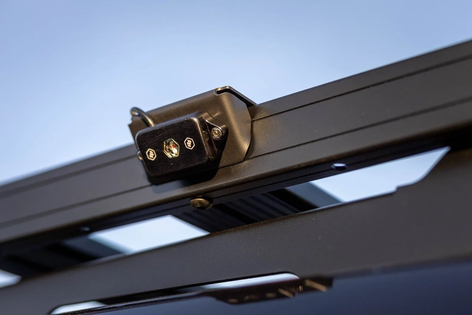

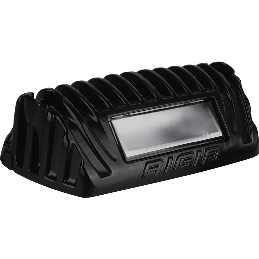

I've spent a considerable amount of time working on this exact solution. The type of rack you have is the biggest variable in lighting choices, sort of.
If you have an area on the rear of the rack with a flat surface (perpendicular to the ground), you can mount flush or surface mount Rigid Industries SR-L spreaders:
SR-L flush:surface mount.webp
Custom mounts can also be made to accommodate whatever:

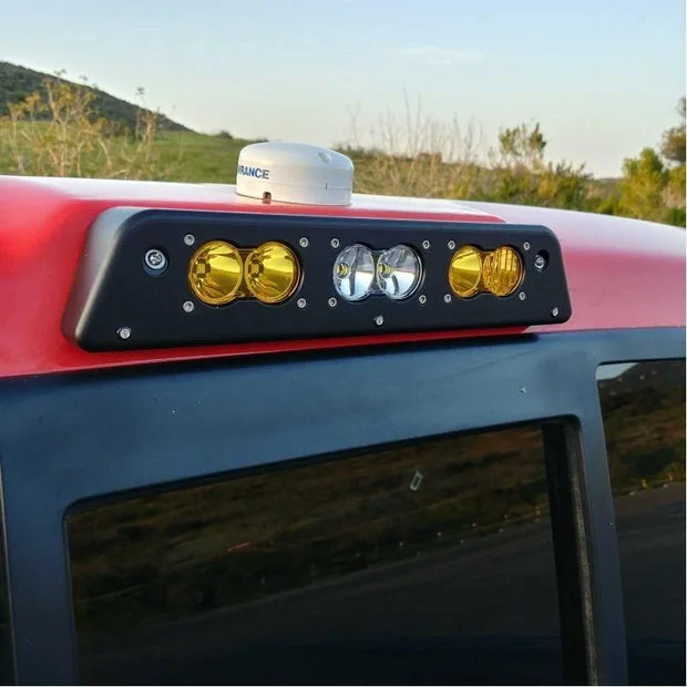

A few other ideas:
Baja Designs Rock/dome light mount

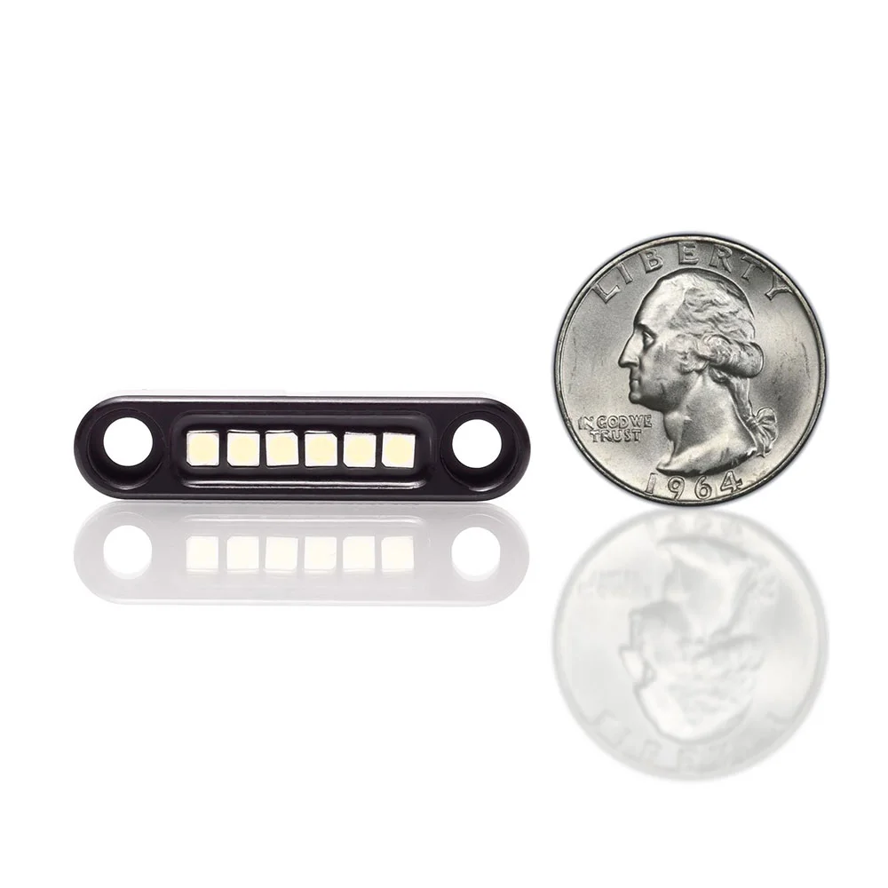

Limited space, good option:
And this is the one I'm hoping @TRAIL TAILOR can do his wizardry on:
