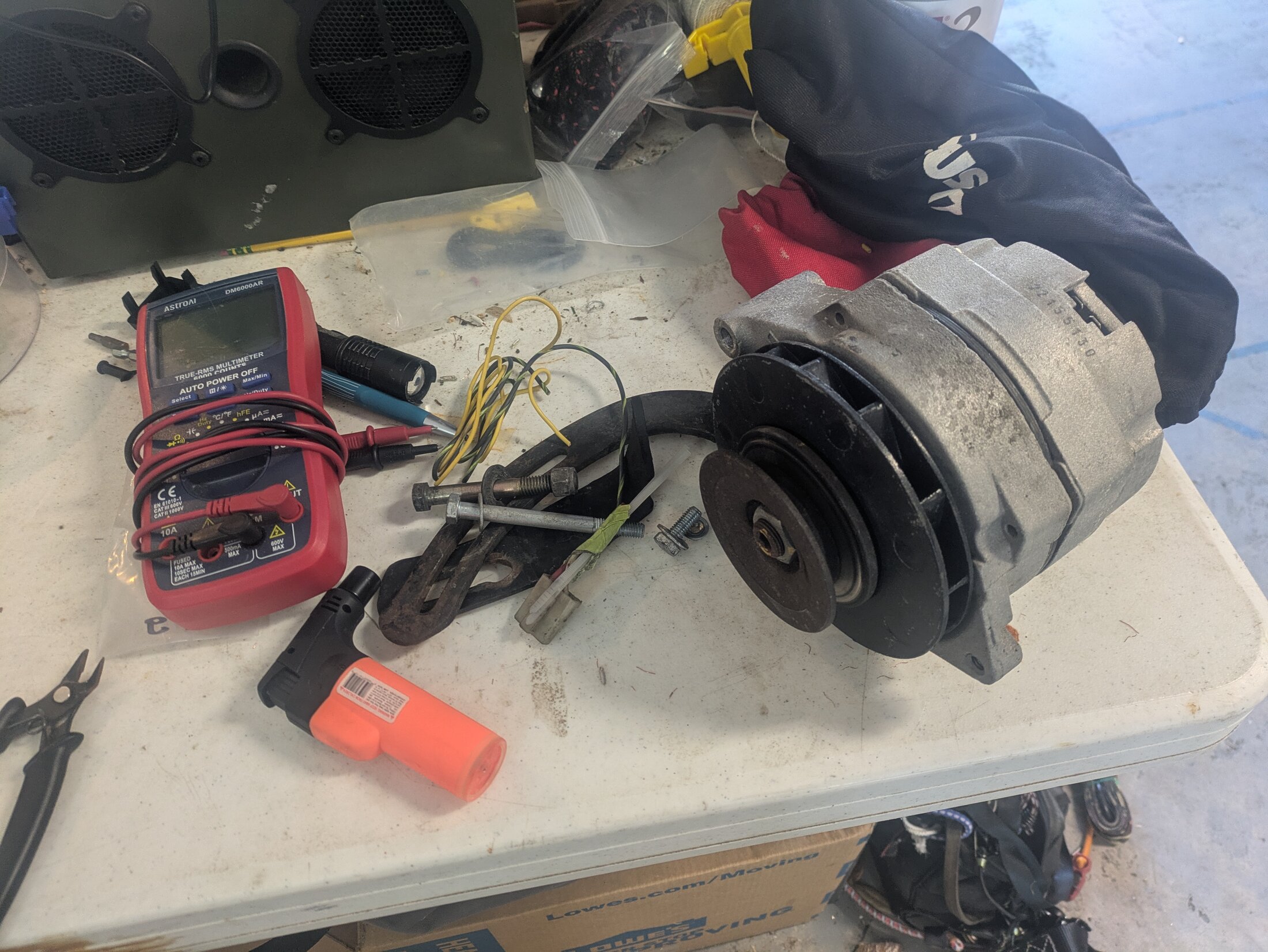

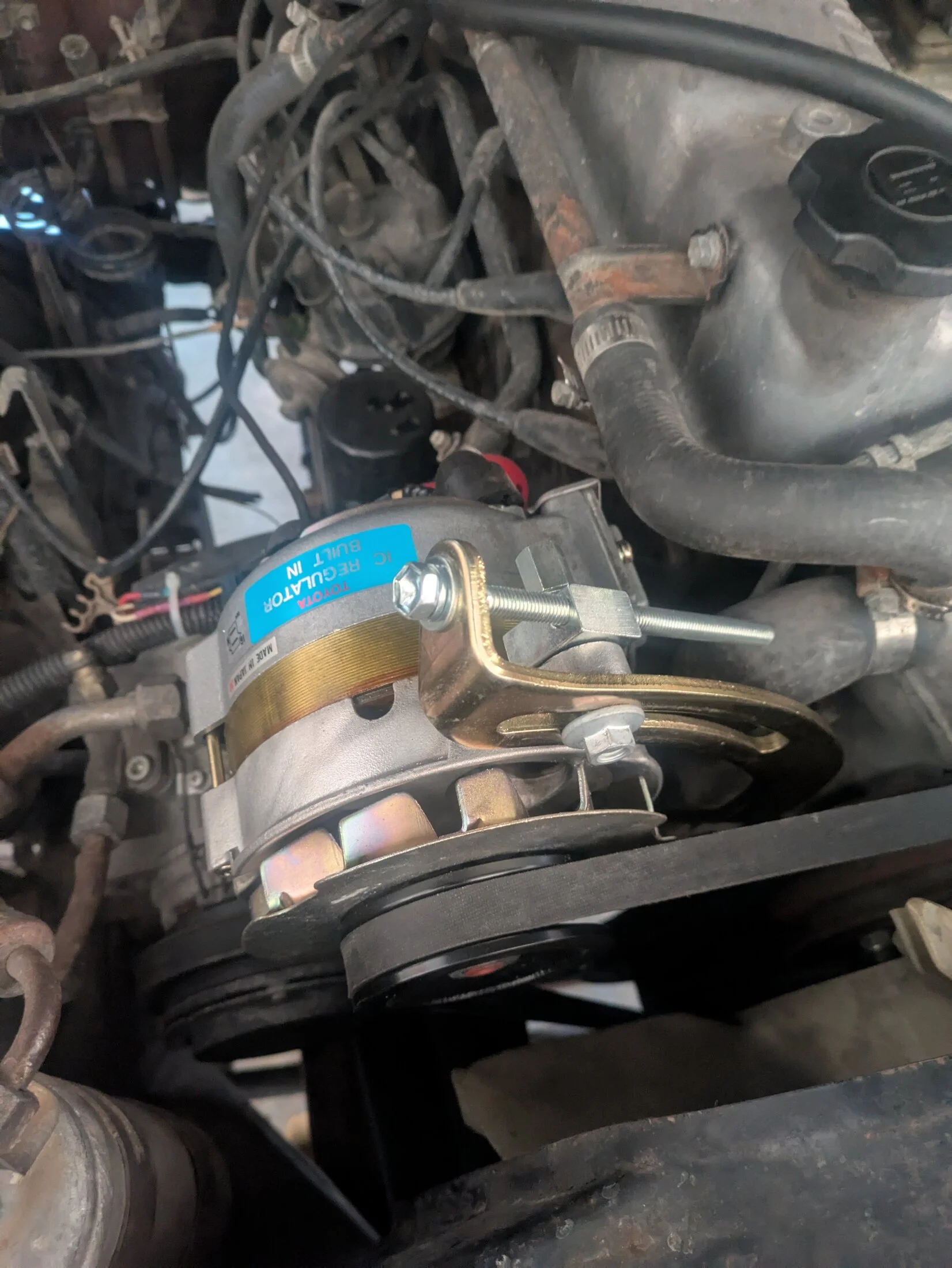

To put a bow on this my rheostat was
turned all the way down for some reason. Turned it back up and all is well. I did still have this shiny new Denso alternator and parts to go back to OEM and I did.
Crappy alt that had been installed
