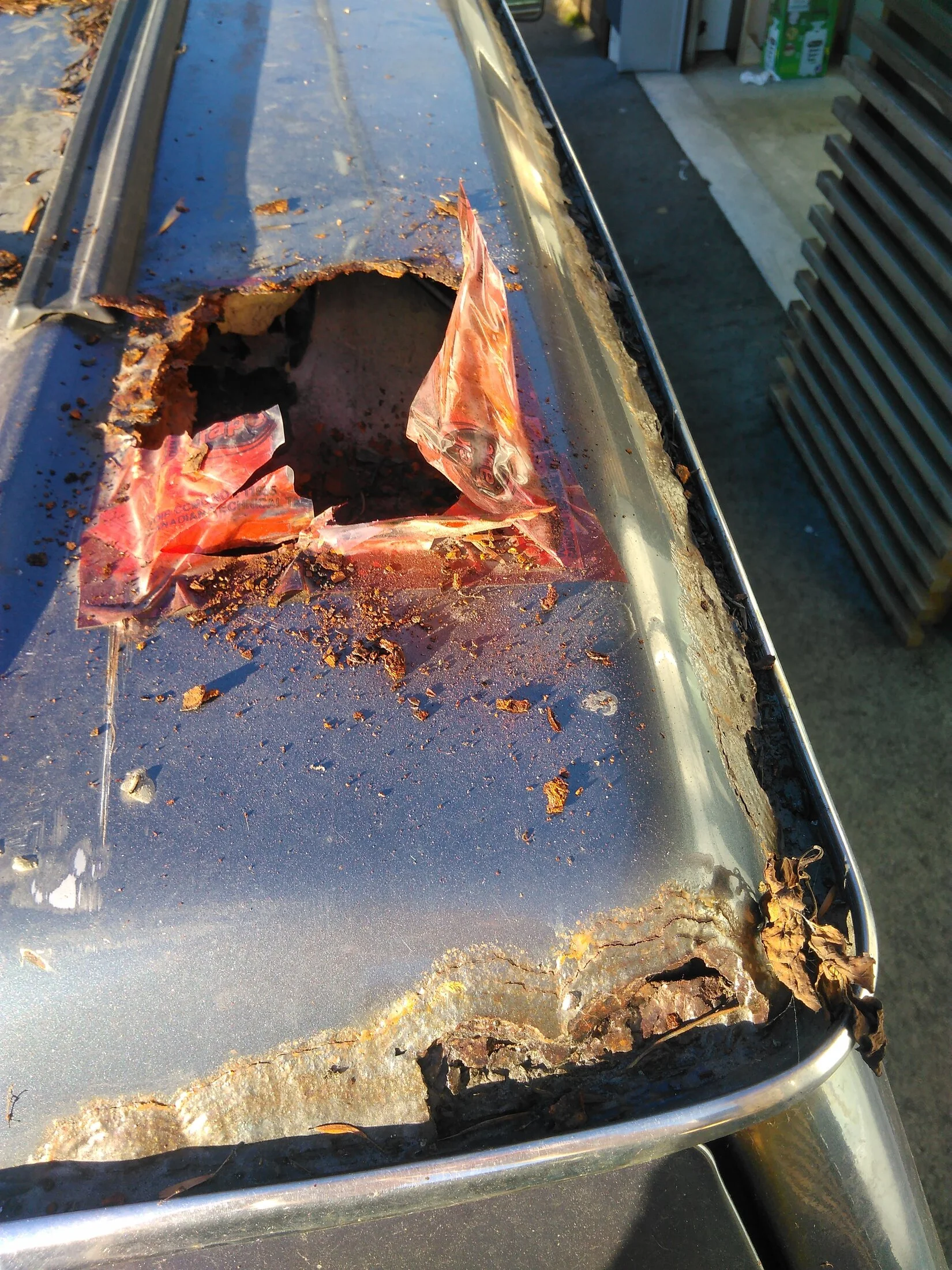

For others searching about roof racks, all Canadian BJ60’s and HJ60’s came with factory installed roof racks. They had threaded reinforcing plates welded under the roof to bolt the support to. I have a picture somewhere and if I can find it I’ll add it to this post.
EDIT: pictures attached. Don't mind the atrocious rust going on here. This is odd by the way - most Canadian trucks rust from the bottom up, not the top down like this one (actually this one rusted both ways).
