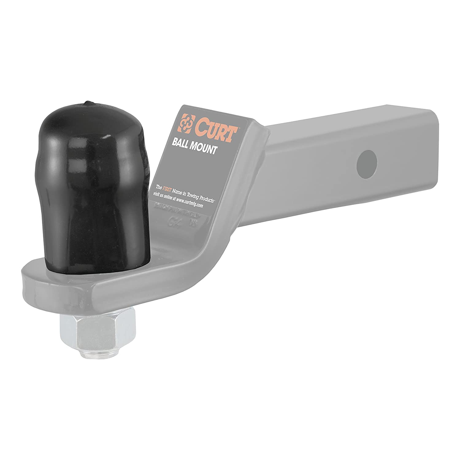

I'm gonna chicken out on the install and have this done at a local shop (Main Line Overland: Auto, 4x4 Specialist for Cars, Jeeps, Trucks, SUVs) about 45 minutes away. But for the time being I'm gonna leave the swingout off, until I have time and energy to deal with the camera and plate mount/lights. So my question: Do you folks know of a weather-tight cover for the spindle that protects it when the swing-out is dismounted?

I talked to James about a tube to cover the swing out stud. He didn’t have anything pre built.
It would be a piece of pipe with a cap, that fits tight enough not to rattle and allow grease to stay in place. Easy enough to fab from pvc plumbing pipes.
If you leave the stud uncovered it will rust. Mine spotted up in just a couple days.
Depending on how long you need it covered and your tolerance for plastic I've seen pliable sleeves that cover trailer balls? Or black ABS pipe with a cap glued on?
I'll try the PVC pipe option. Truck is white, so a white cap won't look too out of place. Will report what I come up with. It will be on all winter at least, so needs to be very weather tight.

Schedule 40 in 1 1/2" with a glued on cap, perhaps wrapping the spindle in a greased rag before slipping the pipe over?

This is kinda what I'm thinking, maybe even drilled and tapped with a grease zerk, and a schmear of caulking around the bottom.
Or...
Or maybe...
:rofl:
I used a ziptied nitrile glove. Ultra classy.
