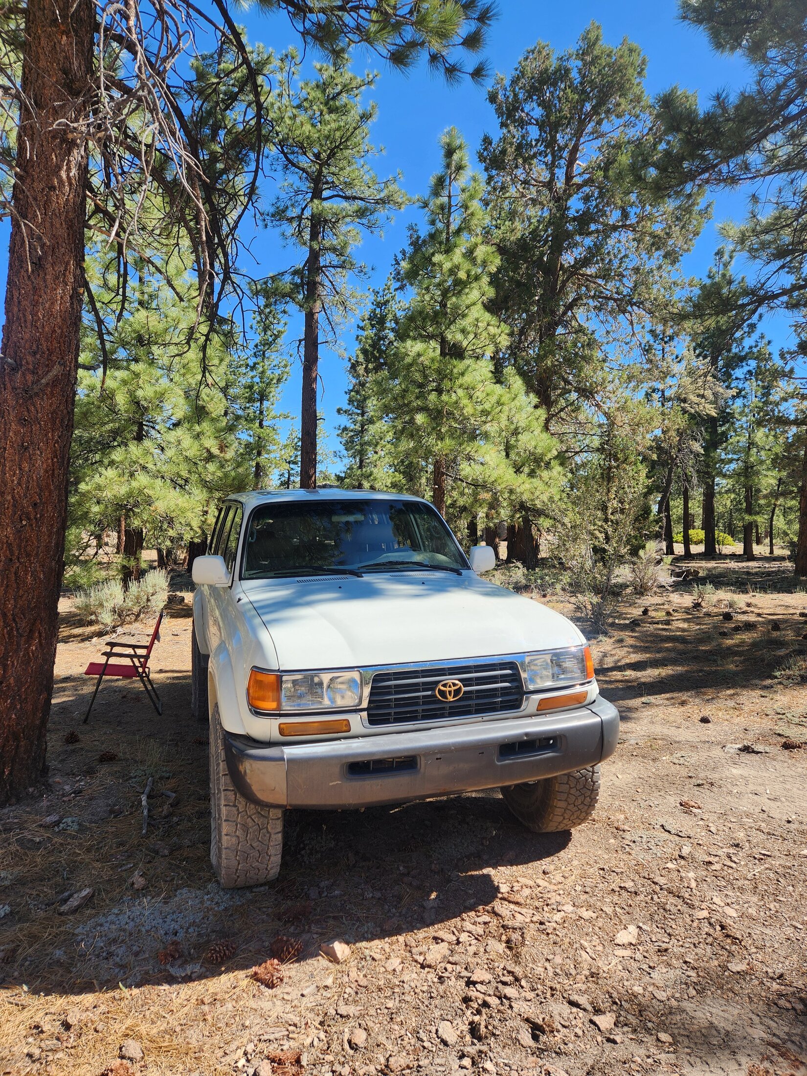

Just wanna source opinions as to what you guys would prefer. No full rear bumper for me for now to save weight and I don't think ill hit features way above my paygrade but I do run 35s. My car will be used for maybe 2 days camping a couple times a year and definitely some daytrips out in the mountains (Big Bear etc). Also no roof top tent for me as I will be sleeping inside or get a tent if im with the wife. I will definitely invest on some sliders (WhiteKnuckle as I used to run them on my old 100 series) and front bumper (ARB) to protect my front end.
Drove up to Holcomb Valley to escape the heat over the weekend.
Please feel free to post your spare tire setup as well.
TIA!

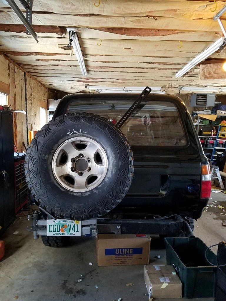

I have a Dirtcom swing out on my Hilux and its awesome. Similar to the Rigd. I prefer a driver side swing out and only Dirtcom does that so it fit my needs. The Dirtcom swingout is robust and you can bolt on accessory arms so you could hang fuel cans in addition to the tire, the Rigd swingout is probably similar. The Dirtcom tire carrier was worth every penny, the space taken by a 32x11.5 inch tire inside the bed was intolerable.
Regarding my 80, i went with the Summit tire carrier as its light, bolts on, swings open on the driver side, and the price was nice. Made a huge difference on my rig, i have 4x4 labs cargo racks so i needed my tire on the outside.
Hope that helps.
