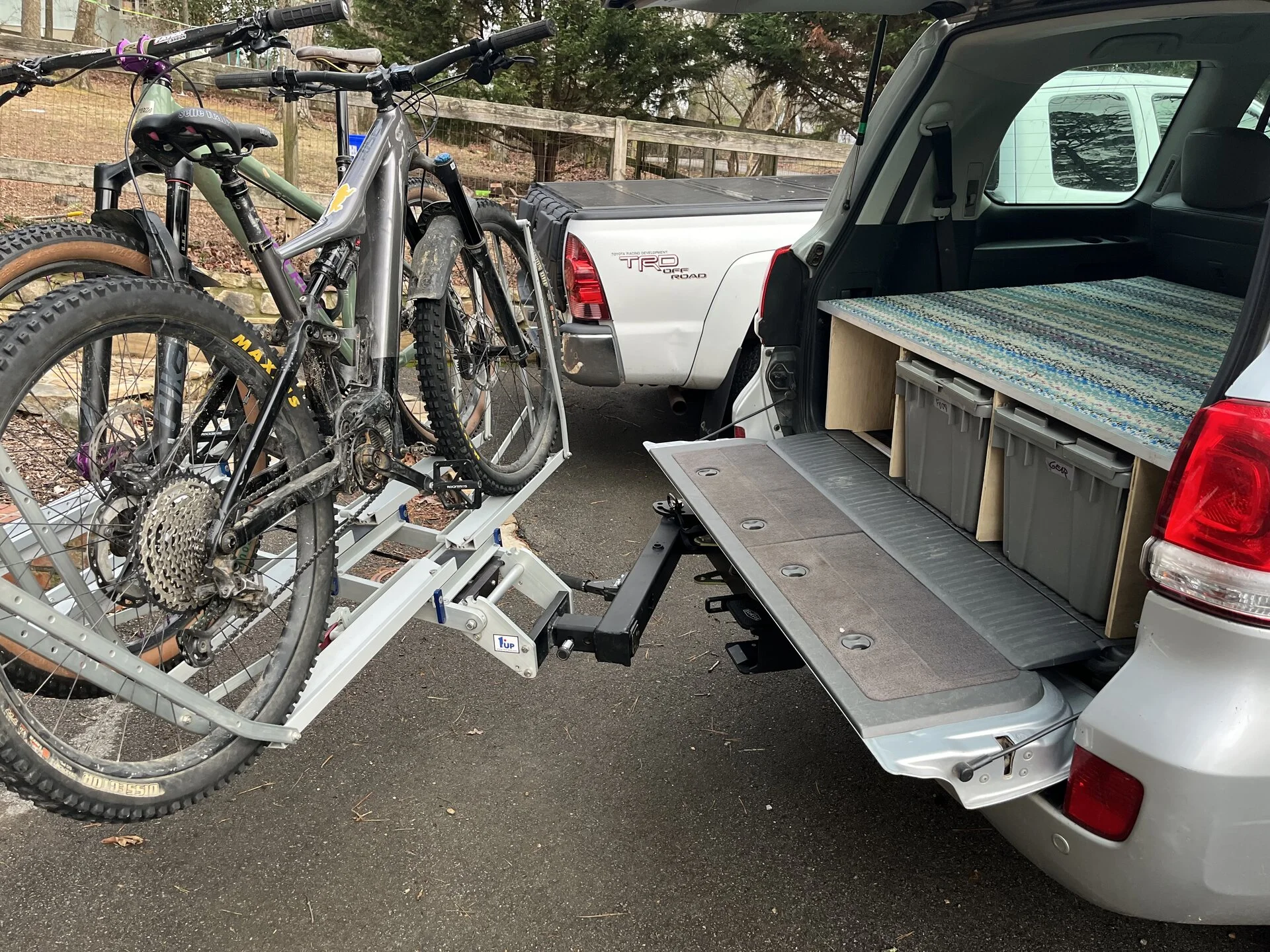

From a 200 series perspective the main limitation for swing away accessories with the 200 is the high receiver and tailgate. Many swing away accessories have interference with the tailgate that would prevent their use, including RigD's Ultraswing series. The Rambleswing has no such interference as you can see below, either opened or closed. View attachment 3548297
From a length perspective, the 4 bike 1up is already pretty long. The Rambleswing adds about 8.5" of length to the 1up rack when installed in the furthest in hitch pin hole (There are 2 positions). The 1 up has to hang about 3-4" out of the receiver to not hit the tailgate without the rambleswing, but it can slide all the way into the Rambleswing, so you gain some benefit in length there.

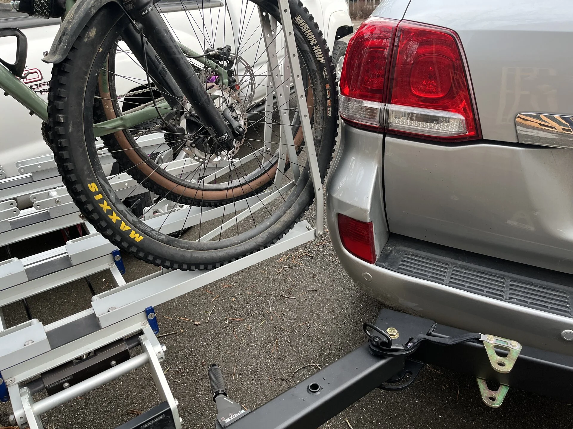

Negative #1 - With long Slack MTBs with big 29" wheels/tires, you have to cheat the bike pretty far away from the pivot side or the tires will hit the bumper/tail light before you can lock the swing away open as shown. This may or may not be a big deal for you. Positioning the Rambleswing further out, or putting smaller bikes closer to the tailgate would make this a non-issue.
The above issue really isn't a big problem for us, except maybe on a severe side hill, as you don't have to open very far to access the rear of the vehicle.

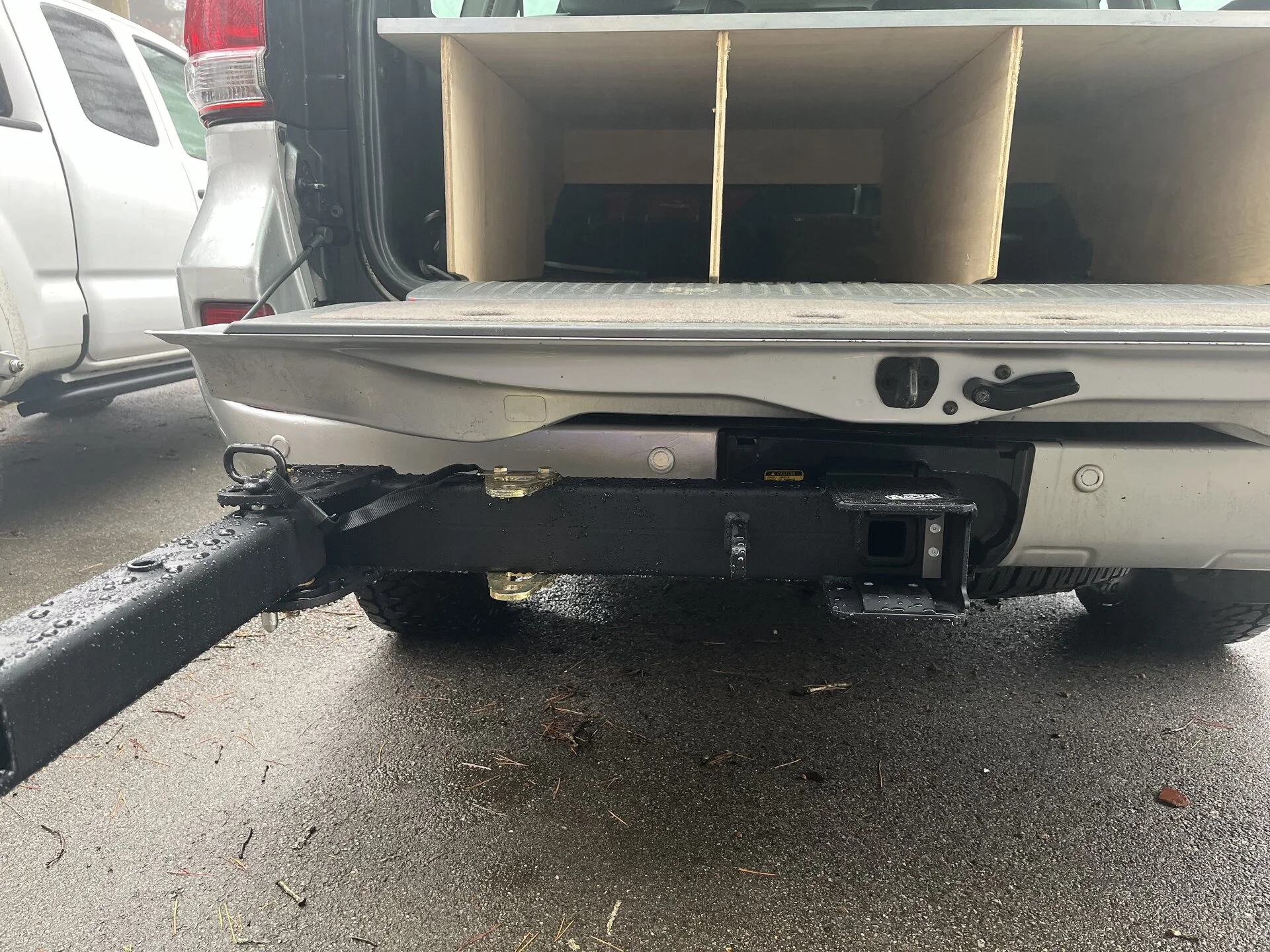

Negative #2: The fit in the receiver is VERY tight. I needed my deadblow hammer to persuade it in all the way even after cleaning and greasing the tongue and the receiver hole. Also, due to the length of the tongue of the Rambleswing, I initially couldn't get it in far enough to get a full size hitch pin in the shallower hole (There are two hitch pin holes on teh Rambleswing). I decided to lower the spare and move the Rambleswing into the deeper hitch pin hole, and this necessitated moving the spare forward about an inch, as shown below. This isn't an issue for me with a 33" spare, but those that are pushing the boundaries of spare size may have issues.
In the deeper pin position, the tongue has about 1.5" deeper it COULD go before bottoming out on the hitch. This is close enough for me, but if you're looking for every little bit of length or departure angle with the swing on, this may bother you.
