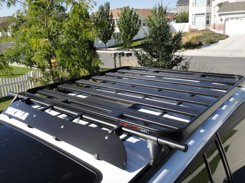

What does everyone think of these? Anyone planning on ordering one? I like that they are completely modular, with the ability to add side rails and loads of accessories.
Rhino Rack - Pioneer Alloy Platform Rack - 42104
if it mounts to the oem rack in any kind of way, just try to avoid it. Do you know how it mounts?
It does look good, I wonder how much added height it has
I like the Rhino stuff but a platform that long would overhang the front leg a lot. Front leg sits just behind the sunroof. I'd have said 1600mm - 1800mm is about as long as would work on a 100.
Good point. It looks like it's available in several shorter lengths.
There are mounting points further forward to accommodate a longer rack, however Rhino will not use them since Toyota in Australia does not recommend using those. Some load bearing issue and roll over issue. Could never get the final answer on that, but that is what they chose to put out in the market. We worked with them on the rack, but we did not get all the features we wanted. The engineering dept overruled us :(

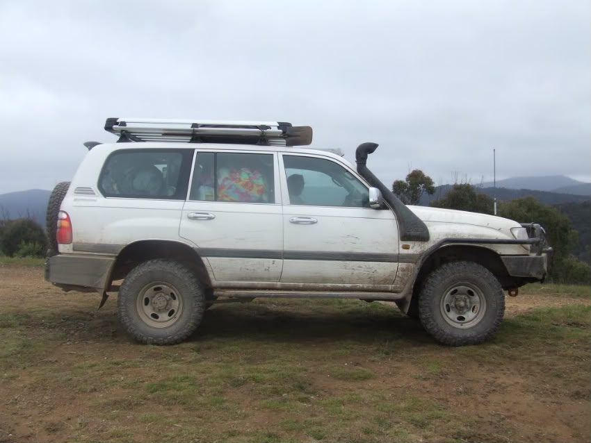

i have the rhino rack (3 cross bars) on my 100 . i like it because it's a 3min job to remove the cross bars (small feet are left on the roof mounts then, and rhino provide caps to cover them). However the feet are made of molded plastic - not very strong. If you want a strong RR go with an ARB.
