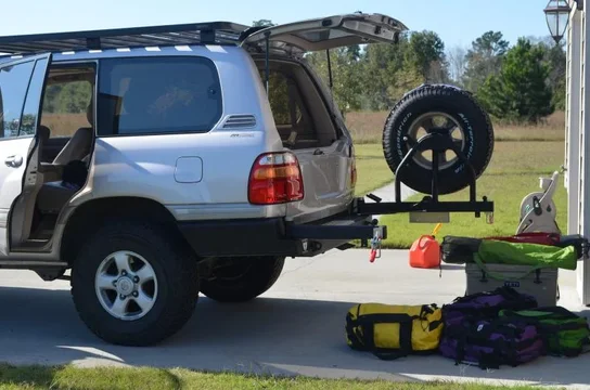

I ended up getting the pioneer platform, foxwing awning and hi-lift/shovel combo all from Rhino Rack. I'm going to start a seperate thread once everything is installed.. I did get the platform mounted up and I'm very impressed with the mounting system, overall build quality and strength of the rack..
So CK, did you get rid of the plastic strip or cut it to get to the mounting points?
The black strip has a thin layer of metal and snaps into place. I unsnapped it just enough so I could cut it with a metal shear. I reused the bolts that I found under the metal strip and moved them to the forward holes to prevent leaks into the cabin. Finally I covered the holes with toyota plastic molding covers P/N 75557-60010.
