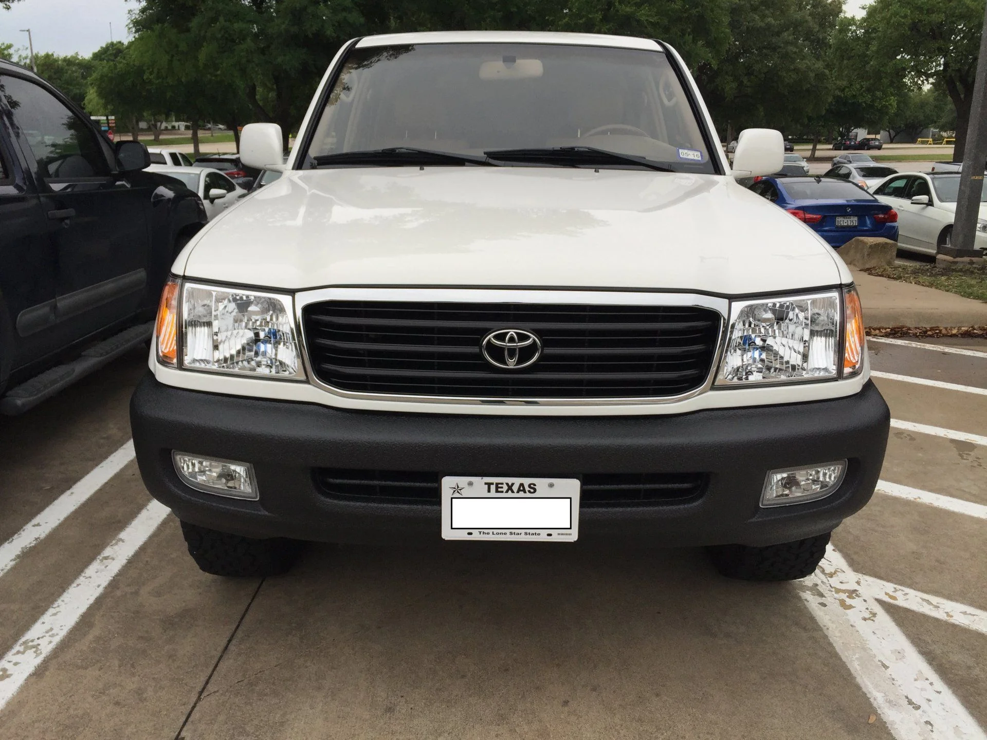

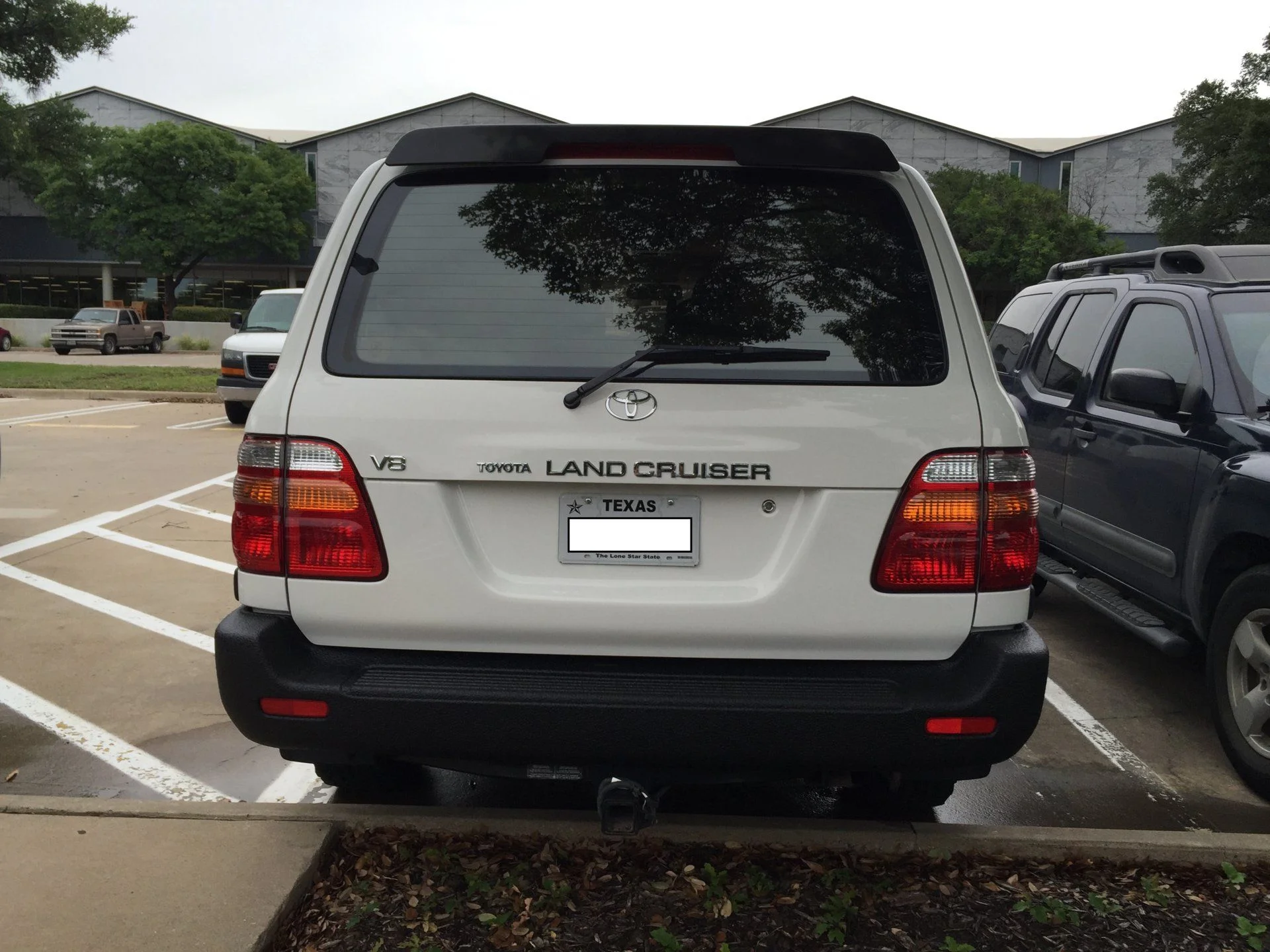

I opted to do a full repaint... But I did have the bumpers sprayed by a local guy with product similar to the name brand bed liner, I think it came out looking great!
That's pretty cool looking on just the bumpers. I saw a Rhino demo where they coated a watermelon and dropped it from 45 meters, it just bounced and the shell was completely in place. How much did it cost for just spraying the bumpers if you don't mind me asking?
It was ~$275 if i remember correctly, this included a top coating of UV resistant material to prevent the chalky look. I provided the shop just the bumpers off the vehicle. I removed all ancillary parts, scuffed up the paint with scotch-brite and used a primer suitable for plastics on areas where the paint had been worn through from parking lot skirmishes. It's important that there is good paint prior to coating as the liner materials don't adhere well directly on plastics. it's been over 2 years since I had this done and there have been no issues with bubbling or peeling; they look just as good as the day I picked them up.

Thanks for the approval! Like I said, this wasn't a name brand product, just a guy in a local shop (On-Site Hitch; Rowlett Texas 214-794-0771). I just called him to ask if there are any shops in the Austin area that use the same product and as luck would have it, he actually gets his materials from an Austin based company. He recommended Georgetown Bedliners 512-572-0771, Call and ask for Brandon, let him know Richard from On-Site hitch sent you.
I did inquire about having the side moldings done since I already had them off the vehicle. He was reluctant to do them since the coating needs to wrap around the edge of the trim and this would interfere with the application of the double sided tape. I ended up using rattle can bedliner that others on this site have used, and lets just say I won't ever do that again. It bubbled off in places, and the texture was inconsistent. I ended up dropping 1k on all new pieces but changed to the part numbers that are xxxxx-xxxxx-K2 variant. This gives it a unique look as well since this trim never came on the white trucks. My suggestion on this is to consult with a local body shop about painting just the trim on the vehicle, Many here have done that and gone to a color matching the body which also looks really good! From what recall reading getting that paint done would be in the 300-400 range.
Now to sum things up, i don't think the line-x quote is horrible, me = 275 on bumpers and others 3-400 on painted trim comes really close to that $800, especially if that extra 1-200 covers the labor and materials involved in masking up and or removing installing anything...
Another poster mentioned rough texture, and cleaning it would be like using your wash mitt on 120 grit sandpaper. Depending on the product and application this is certainly true. My '02 Tacoma has line-x and it truly is like sand paper. As for the coating on my cruiser bumpers, it's got texture, but the space between peaks and valleys is much much greater. I have not had any issues with dirt settling in, and when cleaning with the wash mitt it never snags fibers. I'll try to post a close-up of it in the next couple days. Whatever shop you go with just ask to see what one of their finished products texture looks like, hopefully they'll have something in the shop that was just done for you to see.
