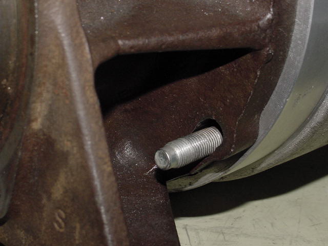

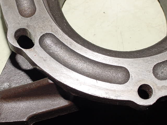

i soon discovered that i did not have all the parts to put the 60 together so i decided to work on the t-case insatll instead. i will be going with the stock gm cast adapter afterall. i grabbed one, chucked it up in the mill and slotted the one hole so i could use it with the atlas. only took a couple of minutes and worked out pretty well. after a quick test fir i bead blasted the adapter and painted it as well.
while that was drying, i got all my hardware and the trans jack ready for what i hope to be the final atlas install. i had to cut part of the tub (reinforcement rib) off so i could tuck the t-case as high as possible. that took more work than expected and i ended up having to use a cut-off wheel for most of it. what a mess.
next i bolted the adapter to the tans and then mated the atlas up to it. all that went without a hitch and pretty much killed the day.

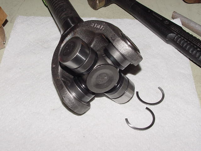

tonite i spent some time on the short inner axle shaft. the old u-joint did'nt wanna budge after almost 30 years of corrosion so i ended up heating it up with a torch and then banging it out. one cap still had good grease in it, theother 3 were bone dry and pretty chewed up.
i also installed the new u-joint in the 35 spline outer but did'nt have time to put the inner on as well; gotta blast the rust and crap off first. i love how beefy this stuff is and how well it goes together.
