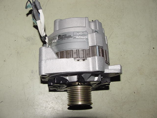

man, it feels good to come home from a tough day at work just to find some more "christmas presents" on your door step. got two of them today. one was my pimpin alternator from premier power welders, the other was my york accessory kit from kilby's (www.onboardair.com).
after unpacking and checking out both goodies, i just had to install the alternator and lay out the serpentine belt to see how it would look. the only thing missing at the front of the engine are the modified york pulley (my buddy jeepindoug is machining down the 2 groove pulley so it'll work with the serpentine belt) and i still have to get a new PS pump; don't wanna take a chance on the old one, it was leaking ever so slightly already.

i ended up going with the 175 cause i did'nt want to have to deal with the larger case. i have had the welder for a while but have'nt had it on a rig in about 5 years so i figured this would be the perfect platform for it. self-sufficiency is hopefully gonna be the name of my game.
i could have gone with either cause they owed me an alternator and a favor, but figured the 175 should be ample for my application and i really did'nt want to have to modify/change the bracketry on the engine. too much other stuff to finish.
