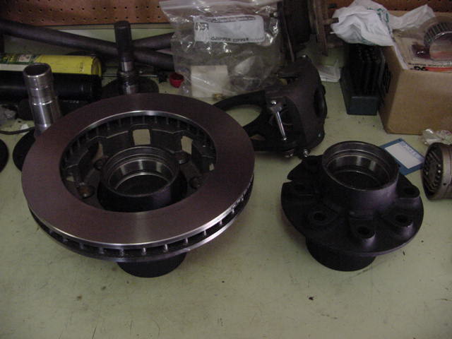

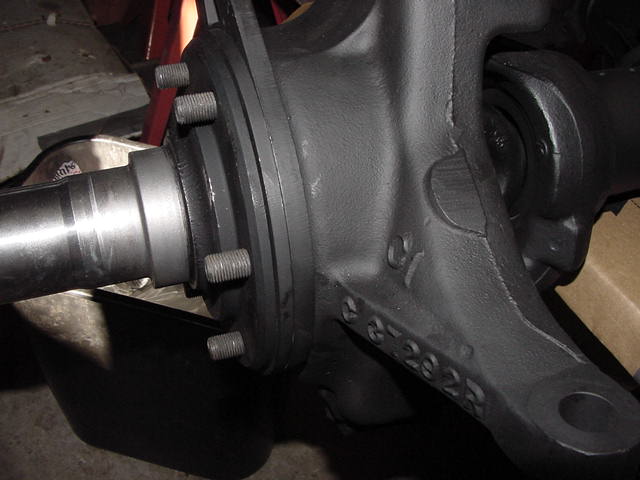

i got the new rotors mated to the hubs without any probelms so i went on to the knuckle assembly. i replaced the lower trunion bearing races and sealing flanges (or whatever you call those). next i installed the knuckles. i had bought some new grade 8 hardware just bacause, could'nt find the old bolts either way. then i went on to install the caliper mounting bracketts and spindles and that's where the trouble started and it would'nt end.
i had bought a "3/4 ton disc brake conversion kit for 15" rims" on ebay. the parts looked like they were nicely made and pretty good quality. they did however not include any instructions nor was there a contact phone # to be found anywhere. :o
on the first knuckle i decided to go in this sequence:
knuckle-caliper brackett-spacer-spindle
and this went together just fine but spaced the spindle an extra 9/16th away from the knuckle so the pivot point of the knuckle and axle u-joint would either be on different plains as long as the axle shaft was where it's supposed to sit in the spindle and the outer retaining snap ring was installed. this would mean having the axle shafts moved towards the outside and in turn sliding the inner axle part way out of the spider gear. not cool. i had assembled it this way because i had found a pic on deadenbear's website showing their conversion brackett mounted in that order.
so on the other side i tried to mock it up as:
knuckle-spindle-spacer-caliper brackett which was the only logical way of doing it. well, that did'nt work out so well since neither the caliper brackett nor the spacer ring would clear the spindle. the center hole in them was not cut quite large enough. on top of that, the caliper would hit the spindle doing it this way so a small radius would have to be removed from the spindle to clear the caliper.

just talked to paul at "hard on off road". he's tellingme that they run the arms between the knuckle and spindle. i don't like that idea at all. he offered a full refunbd for the bracketts if i was'nt happy with them. i then talked to j.b. about the bracketts and he has the ones i'm looking for. they mount on the outside of the spindle in the stock location. they are bent to locate the caliper in the proper position and yo do have to "clearance" the spindle some for the caliper to clear.
