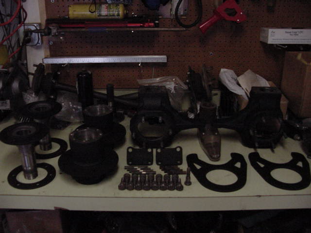

today, sunday, i wanted to prepp everything for the front end so when i get the housing back from my buddy rodney, i'll be ready to go on with the assmebly of the "outers". rodney is setting up the 4:56 gears and power lock limited slip for me over the weekend. since i've only done a handful of differential gear setups and he has done literally hundrets, i figured i'd call in a favor and have him do it for me.
i finally got to use the bead blaster and it works awesome. problem is, the air compressor has a reallly hard time keeping up. i'll just live with it since i don't do that much beadblasting. a new compressor would take away some of the "pocket money' i have set aside for this project so it's gonna have to wait.
i got all the parts cleaned up, bearings and races knocked put, grease wiped out, threads chased, blasted and painted. i also wire wheeled the wheel studs and cleaned up the threads on them. last thing i want is to run into a bad thread or other preventable trouble during assembly.
that took pretty much all day, including cleaning up the mess i made.
here's an after pic:

Thanks for sharing all teh pics. I was happy because I cleaned out a box of radom crap from my old garage when I move da year and ahalf ago...how about a pice of teh blast cabniet...It is on my list someday..thanks

the bead blaster i jave is a snap on model, not a benchtop but free standing. i can dig up the part # and take a pic if you want.
bought it from a guy on the pbb right after i joined that board. :grinpimp:
Georg,
Thanks for the info. I would like something that nice but will probably end up with the Harbor Frieght Special of the month..So I could afford a nicer compressor...

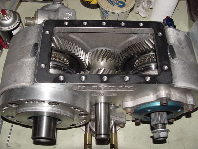

got home tonite and found a package from AA on my porch; the new 27 spline atlas input gear. after dinner with my wife, i snuck off to the garage and pulled the atlas back out of the cruiser, installed the new input gear for the th700 and did the prelim mock-up of the atlas shifters. here's a pic during mid-assembly of the atlas.

In the pic you show the early dodge bolt on hubs/lockouts (dates the axle 89 and earlier), but to my knowledge there never was a 35 spline warn bolt on lockout????? or do you have some internal splined hubs that you are going to use?
BTW is that a th400 short shaft there on the bench? lol 203 version looks a bit shorter.
