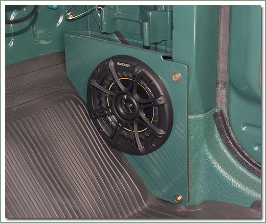

Here's a shot from SOR's website. While it is a clean install (looks like you have to drill a couple of holes), as far as sound quality goes it won't be great since it is not enclosed. Doors act as the enclosure for speakers mounted in them. You could put a small foam baffle behind it which would help some - like this: XTC 5-1/4" Speaker Baffles (Slim-line: 2-1/2" depth) . Would also help protect the speaker from the elements some when your kick vent is open. I just went with a cheap water proof speaker that has its own enclosure and mounted them under the dash and low on the roll bar in the back. And of course an 8" subwoofer under the driver's seat to really improve the sound quality. Some will argue that sound quality isn't that critical as the inside of a 40 isn't exactly acoustically ideal. But some of those deficiencies can be overcome.
I also have one installed and it is very nice. Like you said it feels like it belongs there and works great with phone and radio. I didn't hook up any good speakers just some cheapo ones I got for like $20 put in the door just so I could have some sound. But I'm pretty sure it even has output for sub if you wanted to go that route. Overall I like the function of it and the aesthetics look great with the vehicle. I say do it and don't look back.

RetroSound Model 2 in mine. speakers installed with SOR kick panels shown in @ginmtb post above. Also some "motorcycle" type speakers attached to the roll bar. Actually sounds pretty good for a non-insulated tin can with a tractor motor.

5.25-Inch Premium Ultra-thin Replacement Speakers
Above is the link to the speakers I used. Had to enlarge the center hole & redrill for the mounting holes but it fits very well. The speakers are very shallow to allow for the minimal depth.
I honestly didn't know what to order. Based on this SOR diagram, they somehow put a 4 1/2" diameter hole within a square that is only 3 11/16 wide. Must be magic, not sure how that works.
Either way, the speakers above will fit with a few mods to the kick vent panels.
View attachment 1600987[/QUOTE
To get the actual idea your picture is not accurate for the dimensions given. The speaker is 4 1/2" dia, and the bolt circle is 5 1/4" dia. That is only 3/4" difference. If you use a piece of paper and compass to draw circles at those two dimensions, and then place four equally spaced dots on the 5 1/4" circle (3 11/16" apart) you will see the difference. You will have four holes in a much smaller pattern than in the drawing you show. It's hard to see if you aren't a visual person, so draw it out and it will come to you.
