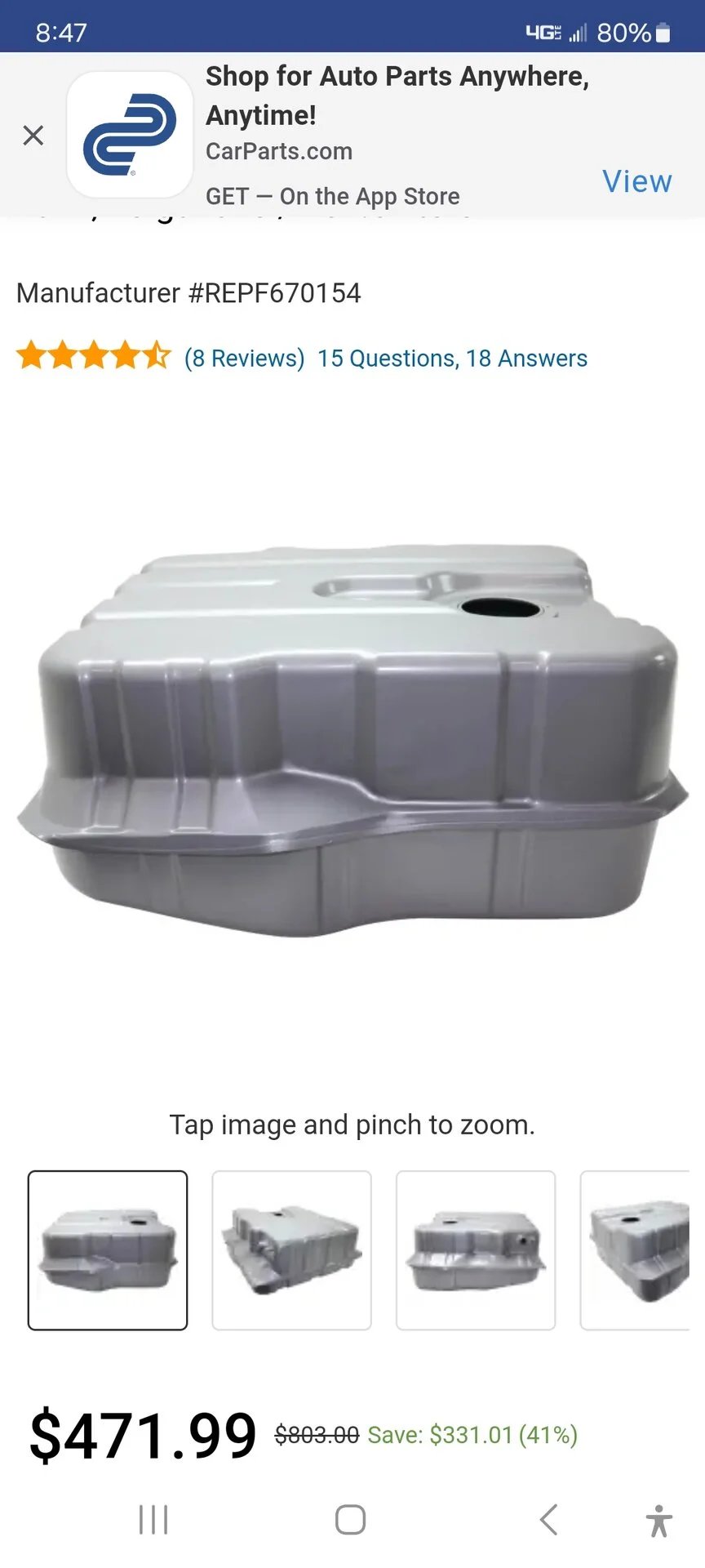

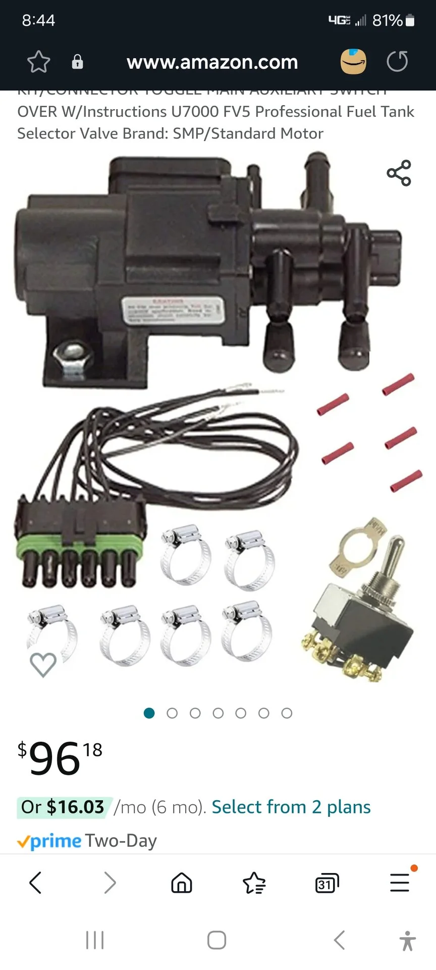

It was from a ford. I just measured and took a used one. I didn't want to spend around 2000$ which, if I remember right, was the price for an after market company that makes tanks to fit. I kept the skid plate/metal under case it came with and bought a diesel filler neck used some pipe from the hardware store that is used for fuels and solvents. Was about 20$ for the filler neck that had a fuel cap and lock. (Bought online for diesel cause it's a bigger throat) this is the type of fuel swith I used and this is what the tank looks like without the metal skit plate I think an f250. I fit it in sideways. It's 40gal but more usable 32 gal for my application maybe my pickup isn't low enough
