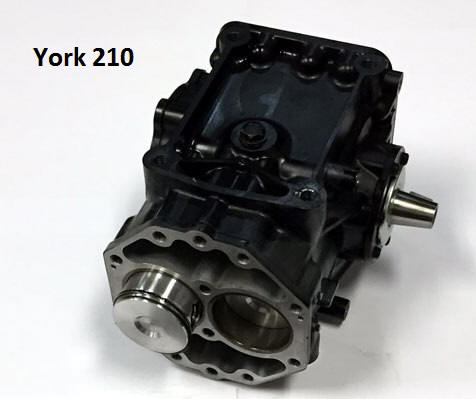

Stick with the York. It has a proven track record and has an oil reservoir for lubrication. No need to try to reinvent the wheel or press into service something you might have 'on hand' but not well suited to the task.

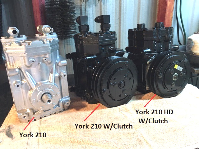

I have three sitting in my shop right now.
I picked up a modified York from Off Road Only. They are set up to act as air compressors vs AC compressor pressed into service.

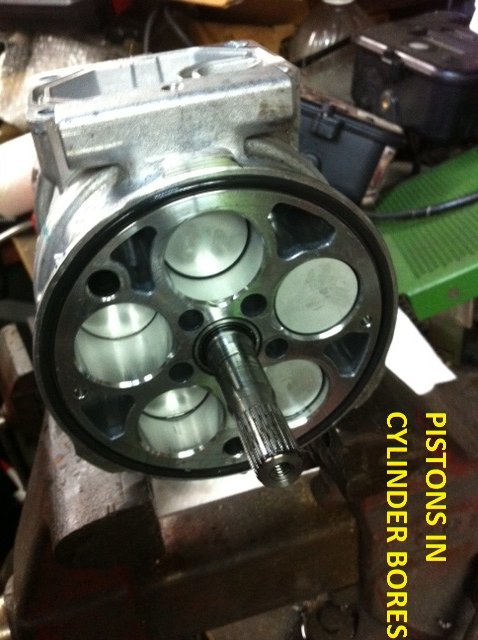

@flintknapper , which of the ports in your pic, are linked to the back end ? I assume the front has an electric clutch ?

There is no 'back end' per se to a 10pa (or 17pa) compressor there is the clutch side and rear plate. These compressors use a Swash Plate type crankshaft. The Swash Plate is roughly centered in the housing and drives the pistons BOTH directions. There are not single pistons moving up and down as with the Sanden compressor. Instead the Denso uses what is basically a 'carrier' that has a piston head on each side. The carrier is driven by the Swash Plate on the crankshaft. Each carrier has two half moon bearings that ride on the Swash Plate. The pistons (10 in all) move back and forth in the axial direction (no push rods of any type).
In order to grease/lubricate the Swash Plate (CORRECTLY) you would need to disassemble the entire unit. It is a Screaming Bitch to get the bearings and carriers back into the bores as you can only do one at time and only in a certain position. The first 2 or 3 will line up no problem. After that.....you'll be back here saying "I see what you mean".
You can pull the case apart while holding the crankshaft snout and leave all of the carriers intact. You could wash everything down with brake cleaner and do your best to grease what you can reach and put it back together. It will probably run OK for short periods of time....but this wouldn't be the right way to do it.

The easy answer is that 99% of all vehicle AC compressors are lubricated through the refrigerant. The York is internally lubricated.
York's are bulletproof. You can re-ring them (if needed) very easy to work on. Oil attenuation is easy to do, can be mounted vertically or horizontally, come in different sizes if space is a concern. The clutch is easily replaced and a very robust design, comes in two different diameters and different offsets to suit different vehicles.
For On Board Air...it is the pinnacle. But a Sanden 709 is also easy to work on and will last most folks a good 10 years (oil-less and greased).
I've run a York 210 on my Early Model Bronco for over 20 years now and use it frequently around the ranch to run air tools (have a 3 gallon tank rigged up). It is flawless.
