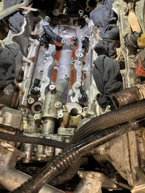

I thought I would share what I just paid to have the valley plate on my GX resealed since it's the most common major repair on the 460. This was at a very reputable Land Cruiser specialty mechanic in PHX.
I took it in for an alternator replacement and my mechanic noticed the leak in his inspection. I talked to him about changing the water pump/thermostat at the same time and he said none of that has to come off to reseal the valley plate so we should wait until they show signs of failure. Just mentioning that because I saw another thread here where someone took off their water pump and put it back on, saying that fixed their valley leak. Total cost for valley leak reseal - ~$1400
The alternator replacement was also a bit pricey (~$1K all in). $350 for the part, the rest labor. I know that sounds high for an alternator but it's a real pain on these. You have to change it from under the truck and it requires removing the sway bar (which means all four wheels up and KDSS issues). Toyota calls for removing the radiator to make the repair. I guess that's what you get when you shove a giant V8 into a medium-sized hole.
Very glad the alternator went out in town, not on the 3K mile road trip I'm about to do or out on the trail. It took a couple of days to get the alternator in as they're in short supply lately. Alternator symptoms were: whining noise between 600-1K RPMs for a couple of days, a slight burnt plastic smell, and a dead battery.
I'm at 184K and have done all regular maintenance at sooner-than-recommended intervals. I'm the second owner, and the truck had complete Lexus service records from the first.
While these repairs stung a bit, they were only my 2nd and 3rd repairs in 50K miles of owning it. I bought it with 134K. The only other repair has been a throttle body replacement which Toyota broke while doing a fuel service right after I purchased it (which is why I go to a LC specialty mechanic now). I was happy to pay it and keep wheeling.

So last weekend when I changed my oil I noticed I was like a half pint low of coolant. No other signs. Didn't even mention the top up it to the mechanic when I took it in for the alt. He just noticed it in his inspection. The water cooks out, so the only thing you can see is red residue around wherever it's leaking. I think he saw some red scoping around my intake as part of his normal inspection (Desert Toy Shop in Mesa, AZ - very thorough, highly recommended) because he mentioned that he couldn't get his camera far enough to see where the leak was from.
I don't think it's something that will go catastrophic quickly though, it's not like it's leaking into the oil system. Just leaks out onto the manifold.
FIPG is under $20. I paid $14.59 from oemvehicleparts.com.
There's different kinds, and different opinions on what's needed for various jobs (water pump, oil pan, valley plate, etc). The 1207B is indeed 20 bucks-ish, the 1282B is ~75 bucks, smart shopper price. Haven't seen any reseal failures with either, according to the google. Big thread on CL that'll put you to sleep...

Leak confirmed. I'm currently at 119,000 miles on a 2015. The quote for my repair is $1200, which I think is pretty reasonable. Will get my indy to change the plugs and the PCV valve while they are in there.
Looks like this leak is a matter of time for all GX's. Hope everyone is regularly checking their coolant levels!
