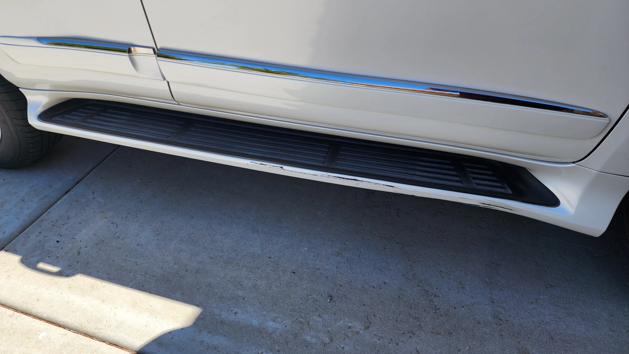

Mud members, I am usually - okay normally - well almost always in the 80 section, so please forgive my ignorance. I was out mall cruising a few weeks ago and decided to scrape up my running board pretty bad on the driver's side. Would have not been a problem in my 80 but alas, the GX is my DD and stock.
So, I need a replacement. It is a white GX and according to Toyo DIY, part #51774-60211-A0 is white (AO paint code). Am I correct in assuming that the part will have the factory color before I order it?
You may want to also ask if anyone on this forum is getting rock sliders and has any take-off's they need to get rid of!.
Could get them for the cost of shipping?
Or, just go with a simple solid step slider, like Slee and paint if factory with some rubber grip tape. To the lay-person, they'll probably never notice it's not stock and you'll have plenty of protection from any further misadventures.
