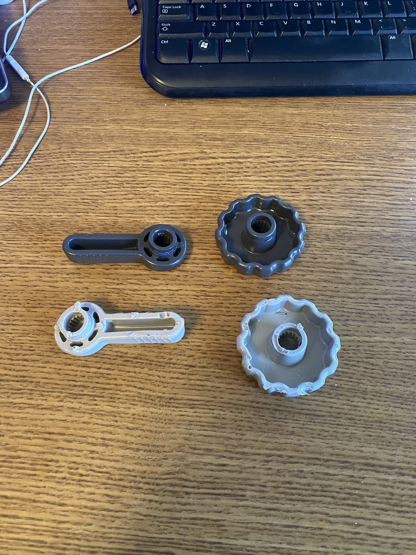

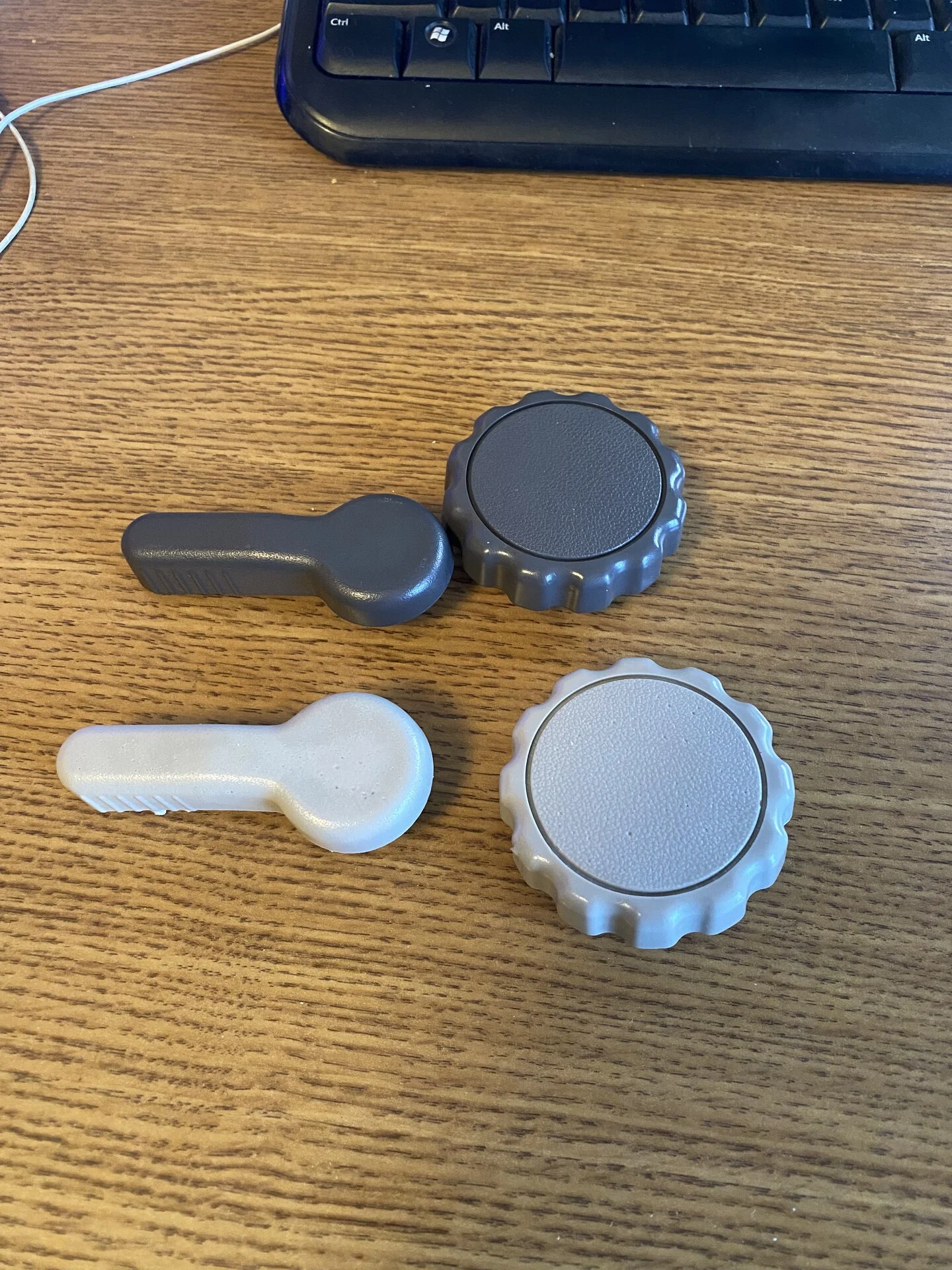

I've been interested in casting plastic parts for some time. There are a TON of 3D printed parts in the world today, but even the nice resin printers leave some tell-tale sign that it was printed. Not only that, but depending on how the part is printed, it can be extremely weak in thin areas.
After a frigid and early winter in the midwest, I needed something to stave off the cabin fever. So I pulled the lumbar and bolster knobs off my 4runner and made some copies of them. I am definitely still in the learning process, but am making big strides. The dark grey are the originals. I have some new molds curing at the moment to fix some of the bubble/flash from my 1st attempt.

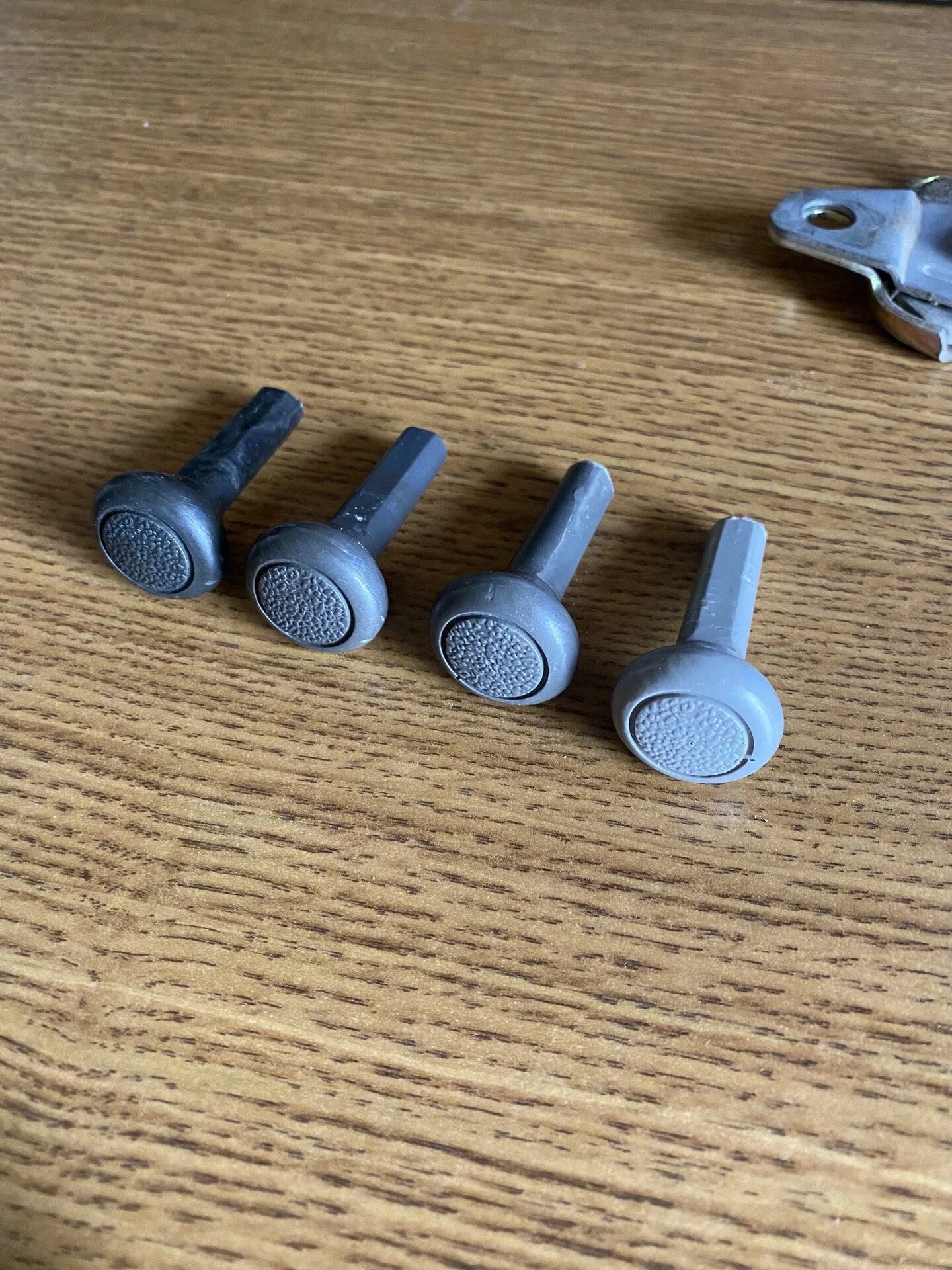

I also pulled these rear seat knobs from my 88 parts rig since they seemed easy to practice on. I'll let you guess which one is the real thing. I've also been trying to get the shade of grey correct, but regardless I think they should be sprayed with SEM color spray for some more UV stability.

The little seat knobs that you’ve already done are a good call. My rear tailgate lock top was nonexistent. And the rings that went around my front door locks (the ones you pull up to lock/unlock) have disappeared.

@sdb999 I am not injection molding these parts, these are resin poured in a silicone mold. That's, currently, how I'm doing it. That is still a very nice print job though!

@Kris I see, so you'll need an actual part in hand to pull the mold. That captures texture nicely, cool. No, I didn't have a window switch. I designed the switch housing/toggle mounts from scratch based on photographs of the part. The switch guts and actual toggles were scavenged from a Land Cruiser switch from the same error and are plentiful. Digital caliper on the LC switch base and many test parts and I finally got all the relationships/snap-fits right. Oddly enough the hardest component to source was the 8-pin connector housing and related pins.
@sdb999 precisely, I need a master part to start. Albiet there can be some pretty heavy "arts and crafts" to make a master look right enough to make a mold.
