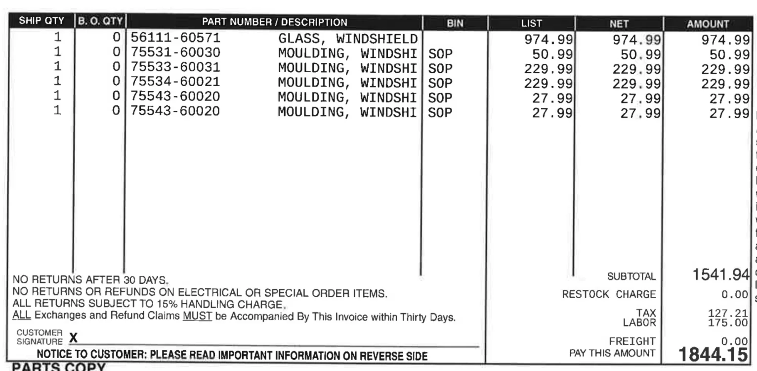

This is the quote from the Lexus dealership... Since I have to pay the $750 deductible anyways, I don't mind what they charge me.
Funny thing is the local highly reviewed Yelp glass shop quoted $350 for non-OEM glass + labor, and then actual parts cost for the moulding. So it would have barely cleared my $750 deductible.

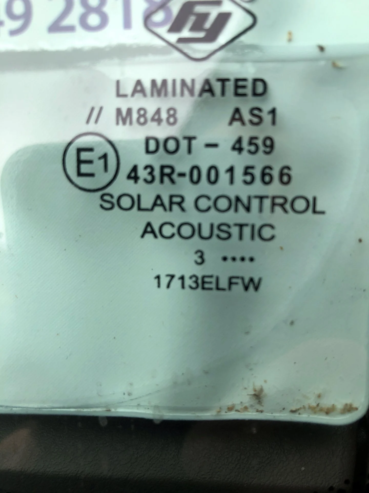

As well as the fitting, rust repairs and rivet installation arrangement try to get the upspec screen if possible. The solar control with tinted upper section and acoustic glass are highly recommended.
