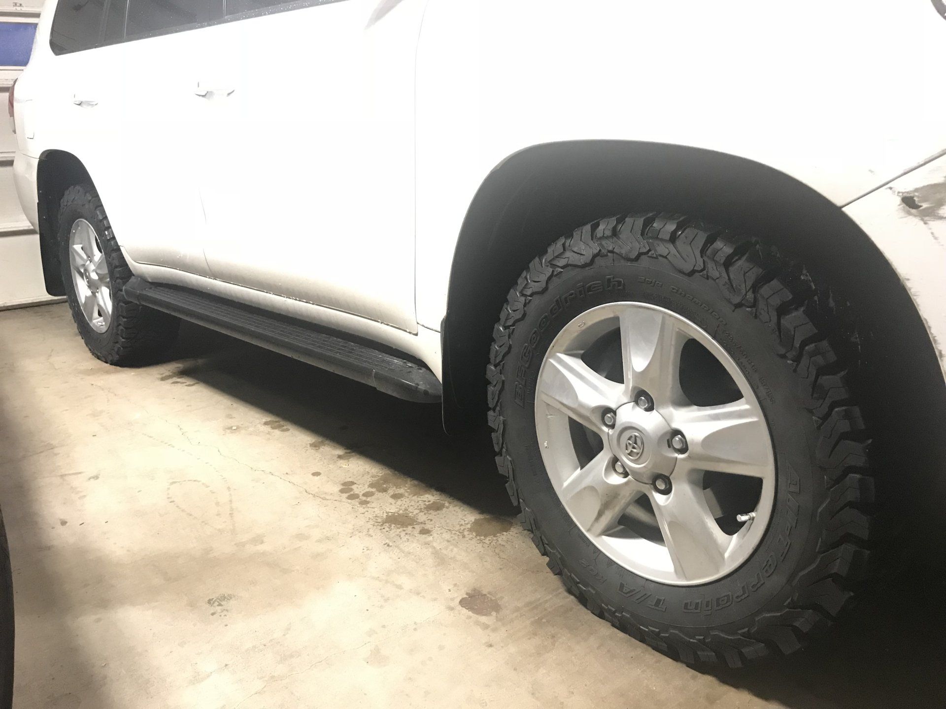

Lots of good info here but can we please see some pics of stock size (285/60-18) BFG KO2's!! Not trying to hijack just thought it would help OP.I'm going to replace stock tires very soon and I am interested.Better yet next size up(285/65-18) pics.I think I should start my own thread as I'm on the fence for both sizes.Really what it comes down to is convincing my wife,she wants pics also!
I’m the OP and I went with stock sized KO2s. I think it looks really good..I’ll try to get some better pics later in the week but here is one from my garage.
