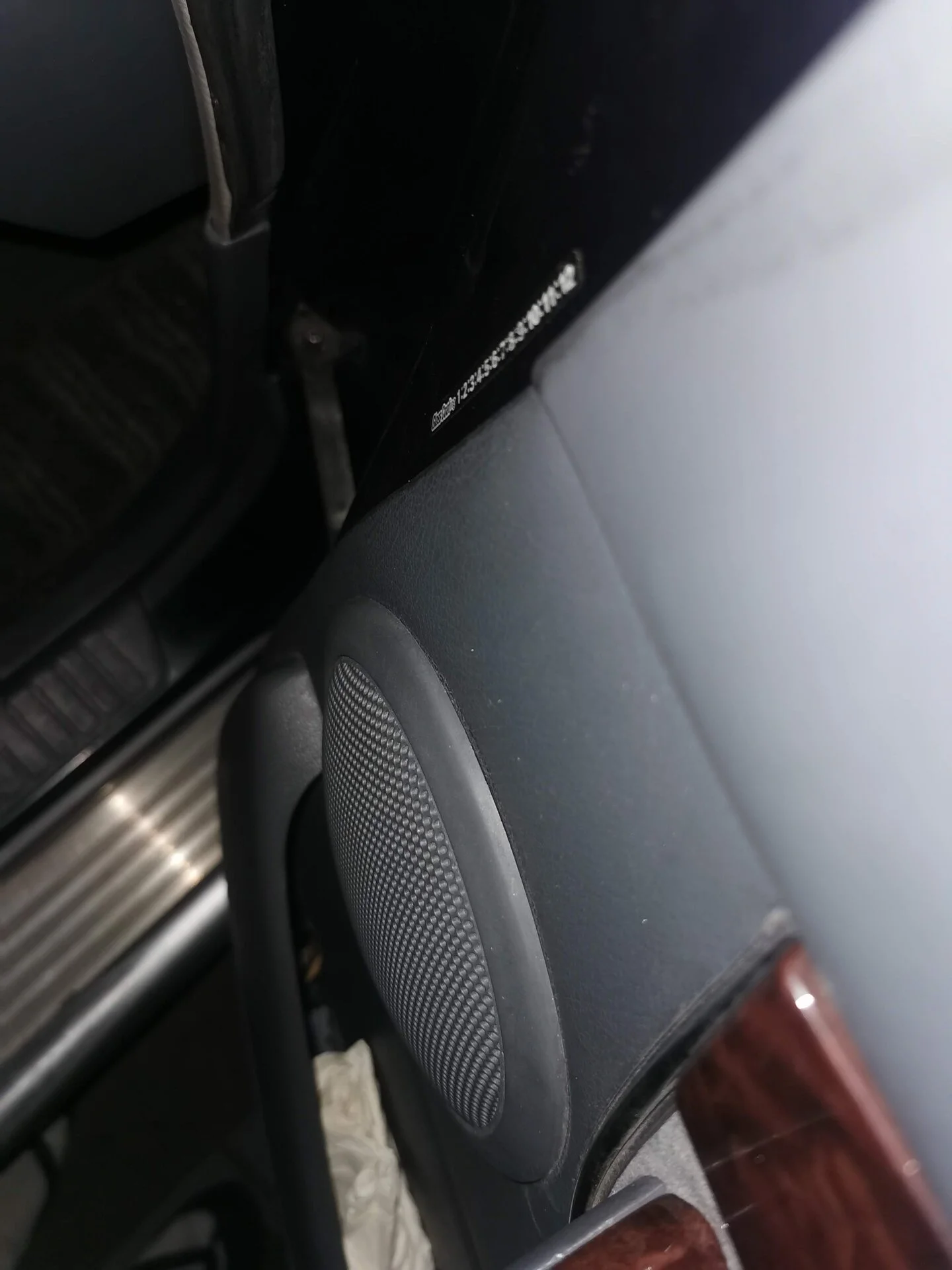

Hey everyone,

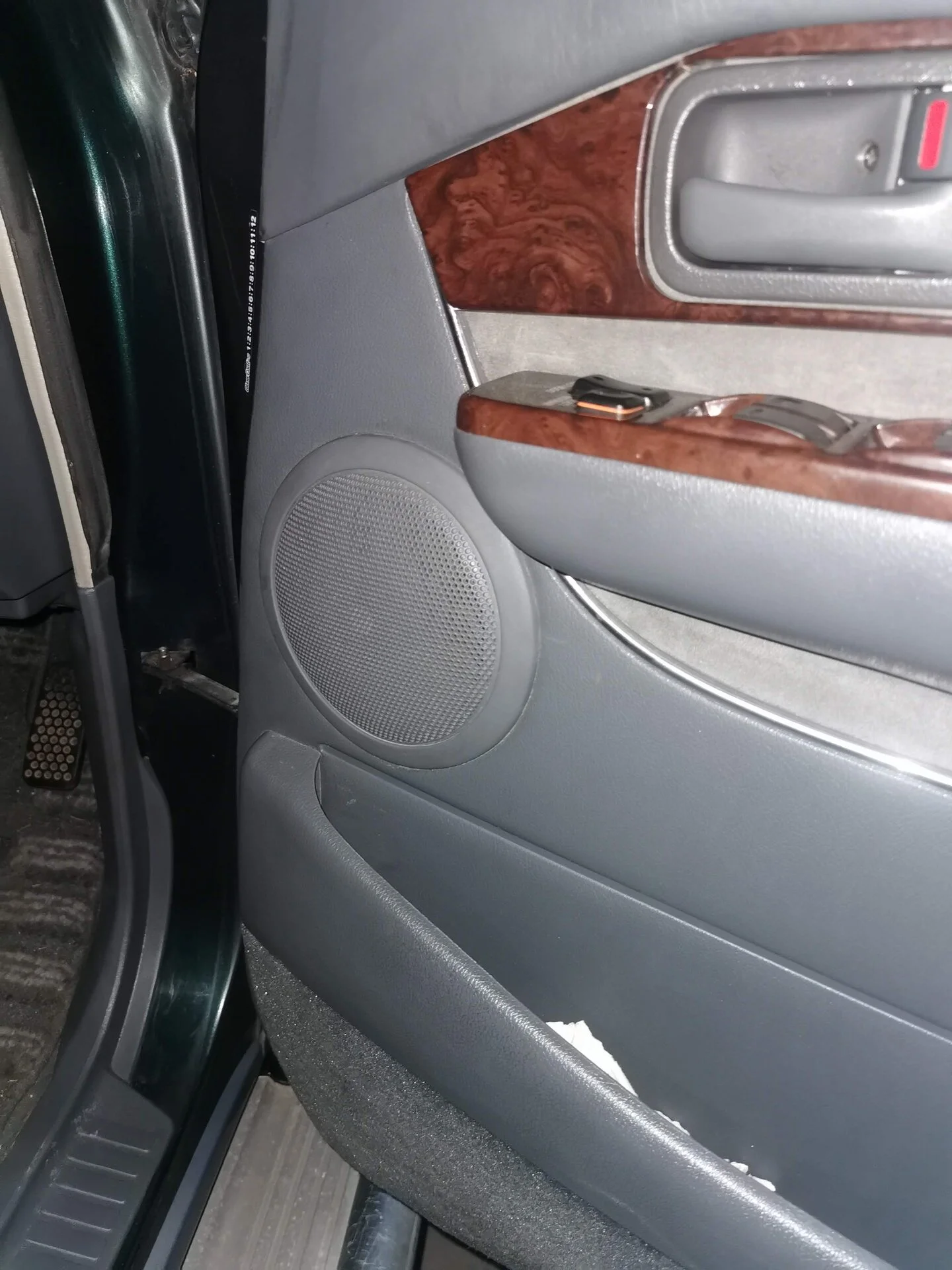

I thought I'd share the speakers I installed in my Landcruiser front doors today while keeping the original grill. Maybe it'll help someone out.

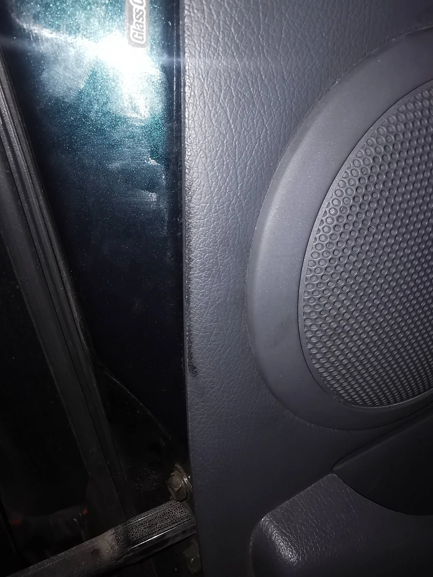

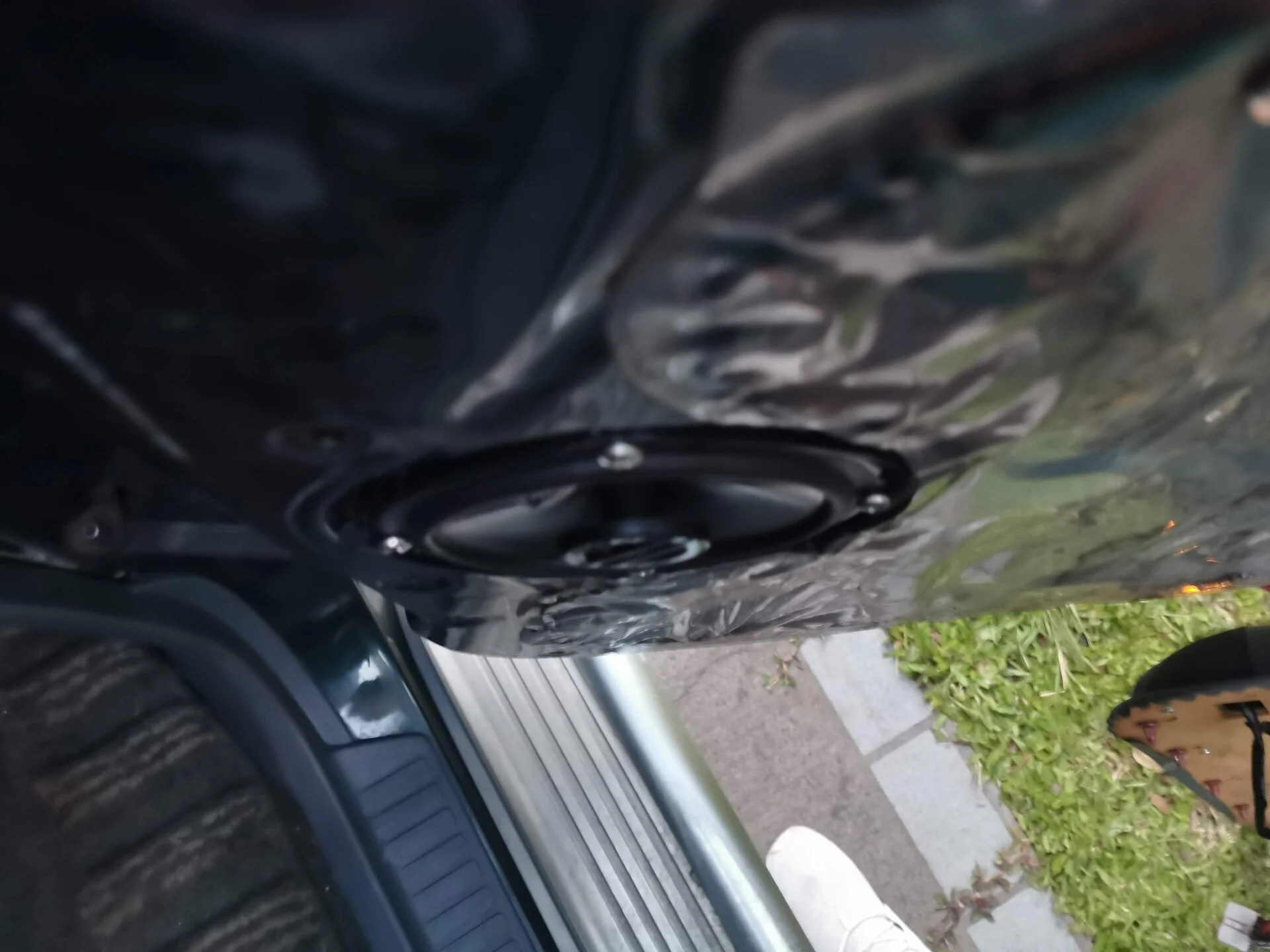

They're the Pioneer TS-G1620F-2 2-Way 6.5" Speakers. They're actually a bit too deep and just touch the window frame thing, but it doesn’t affect anything.
After removing the old speaker, I put a bit of rubber all around the edge of the hole. This acts as a spacer and also eliminates any vibration against the metal door. It's a rubber roll with tape on the back.
Then, I bent the half screw brackets on the outside of the speaker inwards and used the proper holes on the speakers.
I used G12 25mm screws. They fit right into the original screw hole, and you can screw them all the way in.

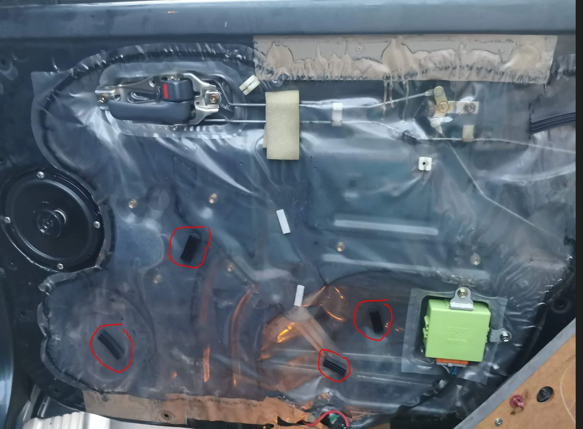

If you have foil over the door, I used pieces of the leftover rubber and placed them on top of the foil over each hole. This also helps to eliminate any vibrations from the foil.
And that's it. They perfectly replace the original speakers
