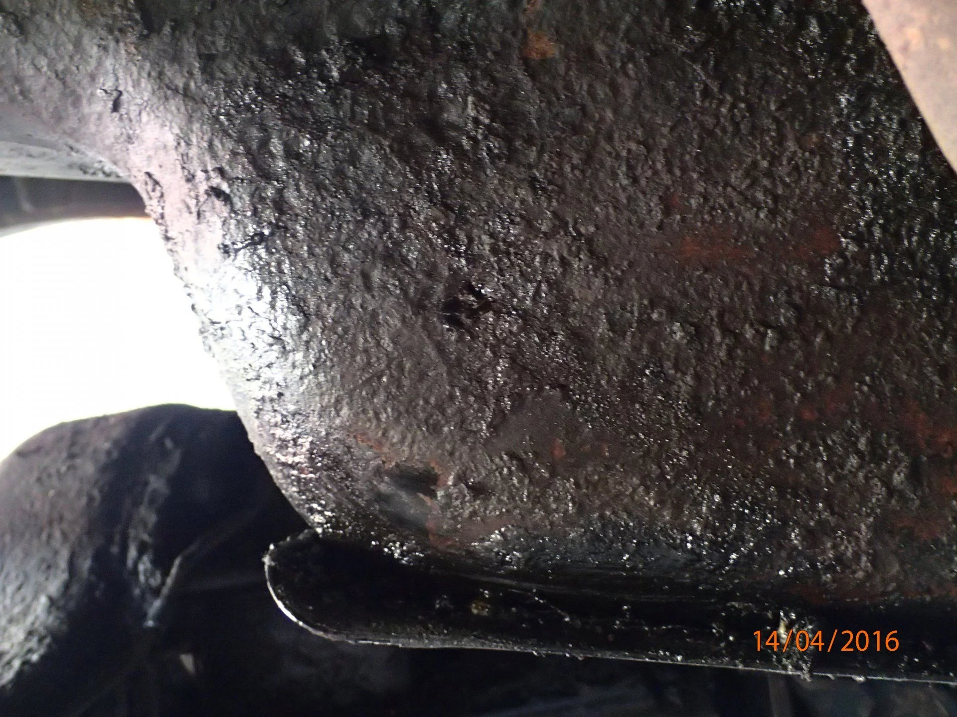

That and the welded on bash plate traps dirt and therefore moisture and eventually rusts through.

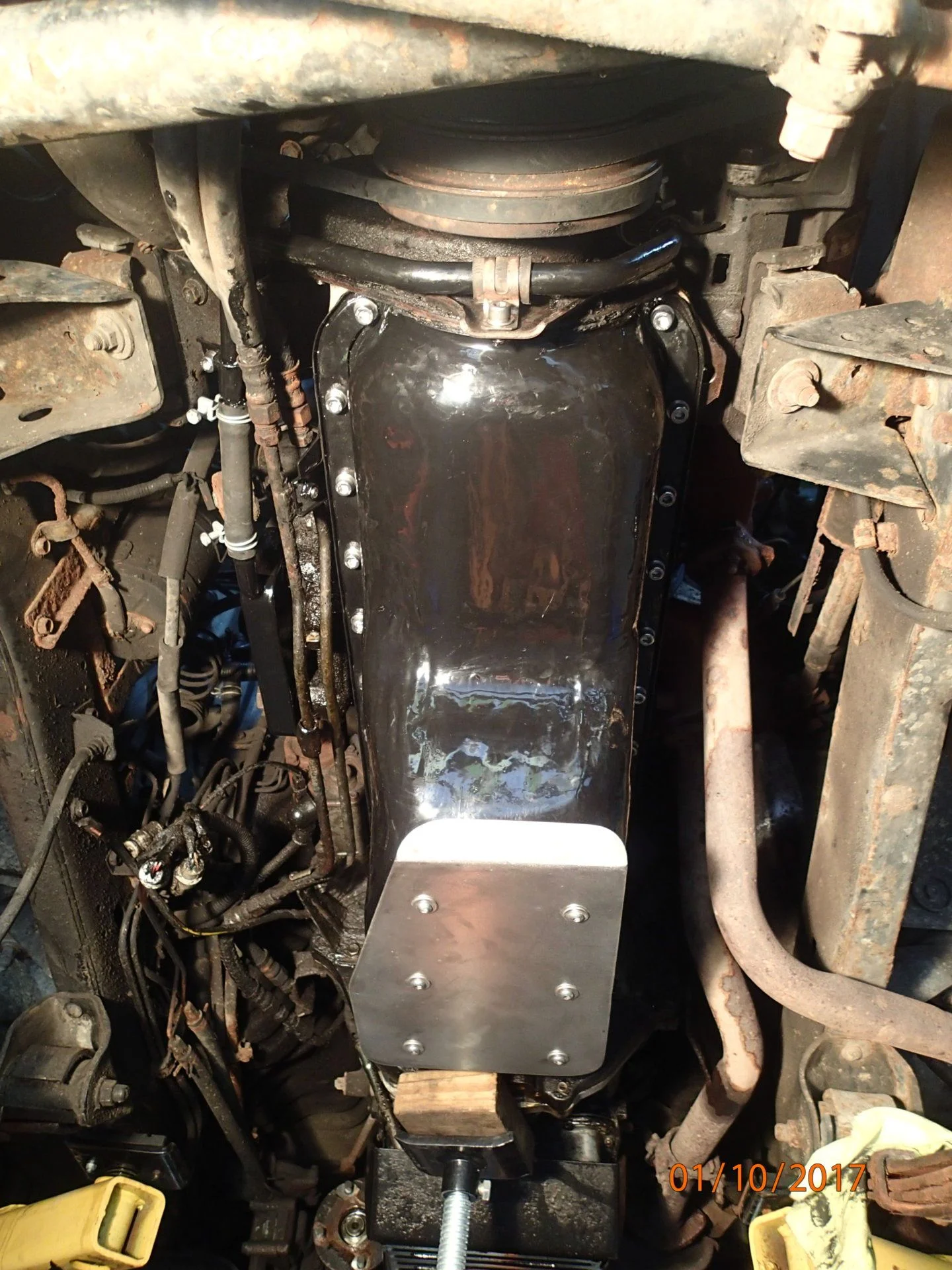

i had the rust between that weld-on plate and the bottom of the oil pan (photo above). The cure - when it was off, cleaned it very well and used JBWeld to seep down all four sides; one side at a time. If you have the $$$, just get the new pan. oh, and after 12-years or so - it's still ok.
Or if you the same disease I do you can reconstruct it with a separate bash plate with an air gap in there.
