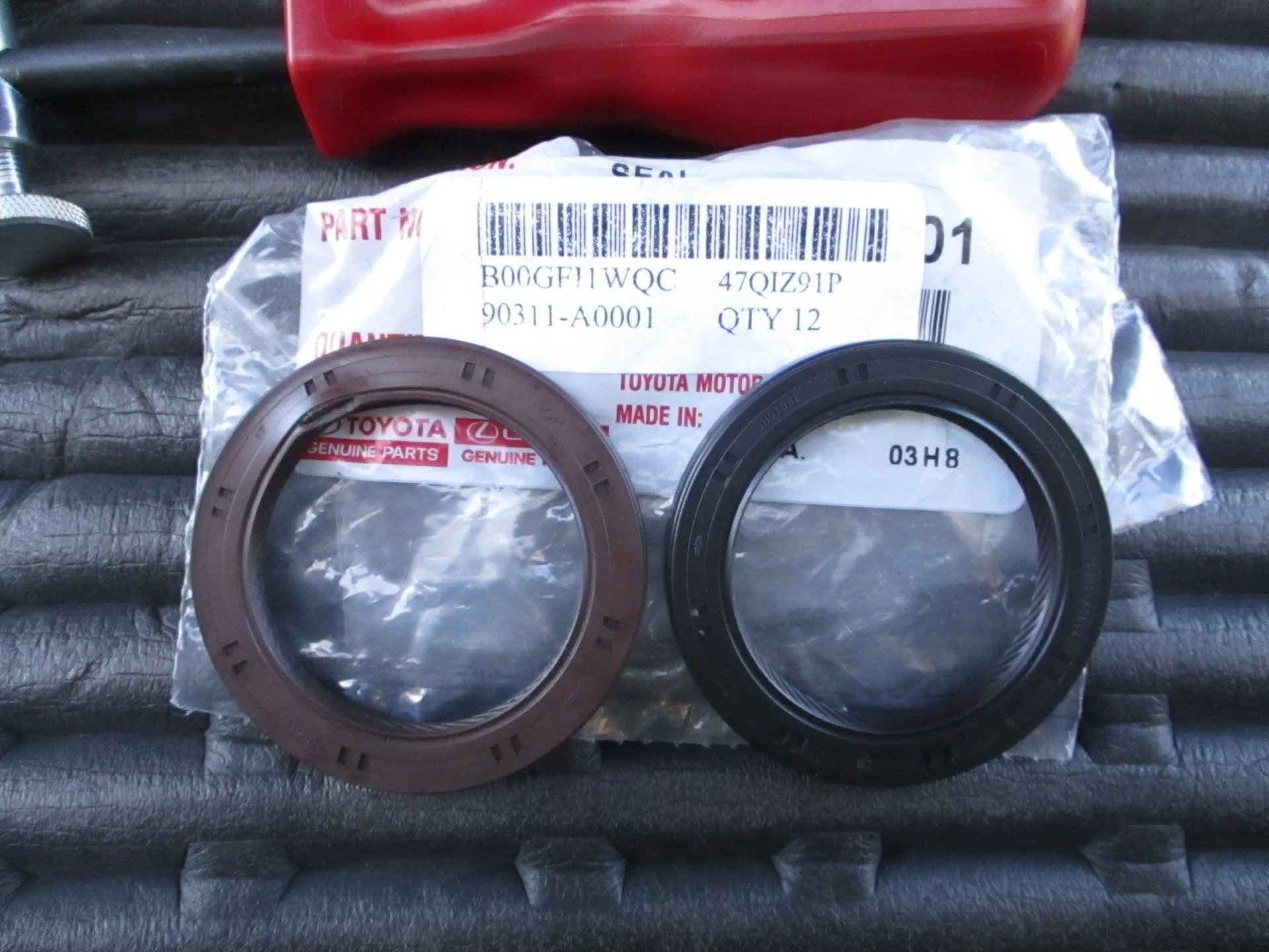

I'm guessing it was the original. I changed it at about 225,000 miles. Here's the old one and the new one.
Thanks for the reply, I changed mine at the second timing belt change 178k. Hope I'm good for another two more cycles.
