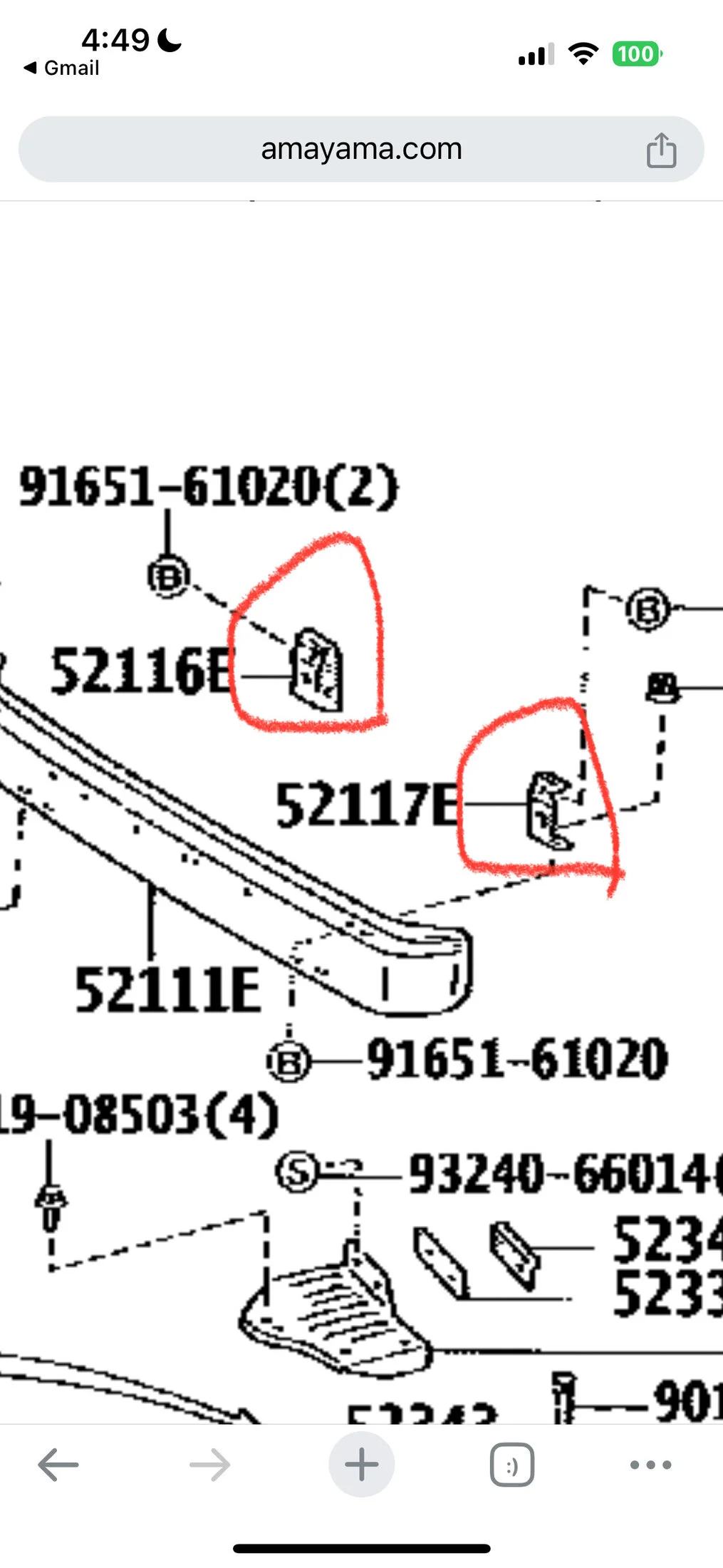

I’ve tried ordering mounts from Cruiser Parts, but they turned out to be incorrect even though they listed them as being the right mounts (I think they were described as “post-85, pre-2007 70-series bumper mounts” or similar. I also reached out to Amayama, and while they were very helpful over email, they said they couldn’t figure out what the correct parts were either. I punched in my VIN on their parts finder and it does not populate the mounts or give parts numbers for them. It shows this schematic and the mounts are circled in red, but I believe this is EXACTLY what I ordered from Cruiser Parts, unsuccessfully.

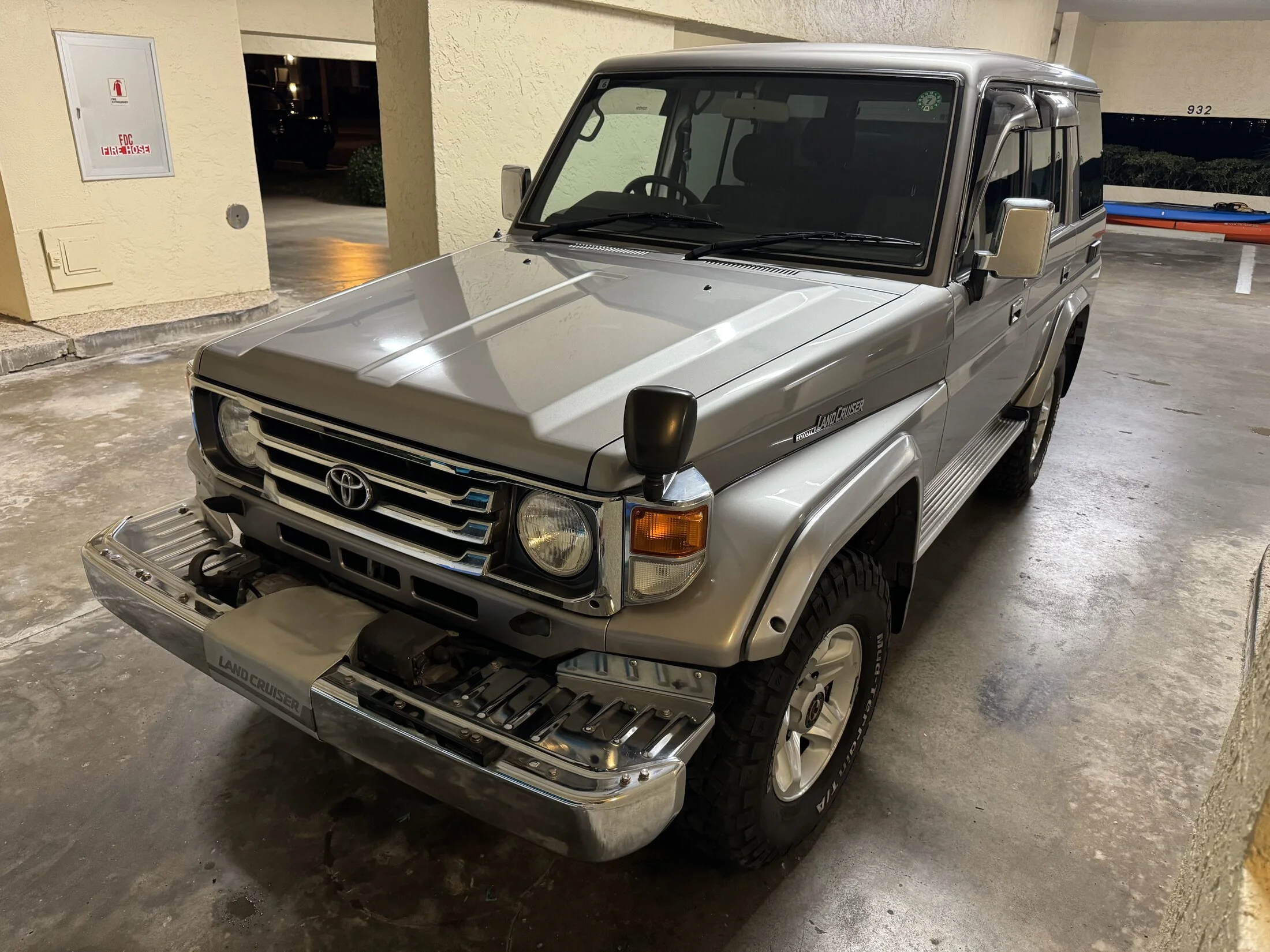

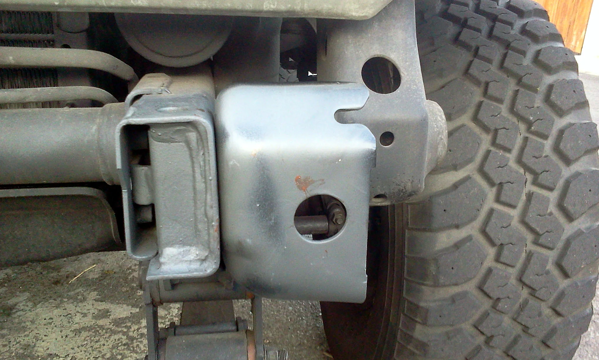

I’ve also included some pictures of the car and the current mounts with the bumper removed below, just in case that helps.

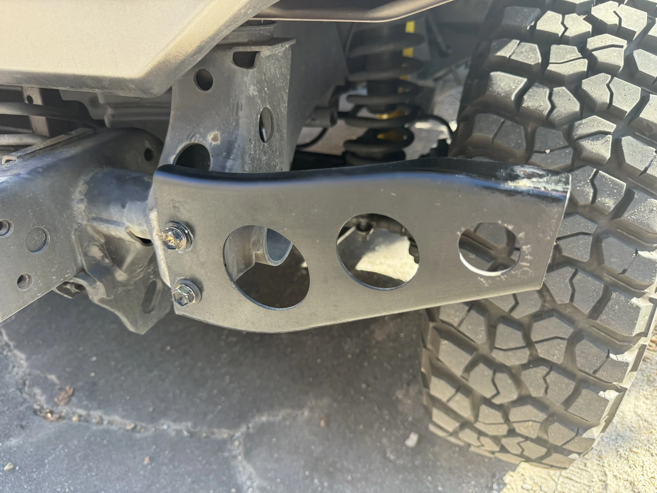

These are the bumper mounts that I ordered from cruiser parts. They definitely don’t fit.

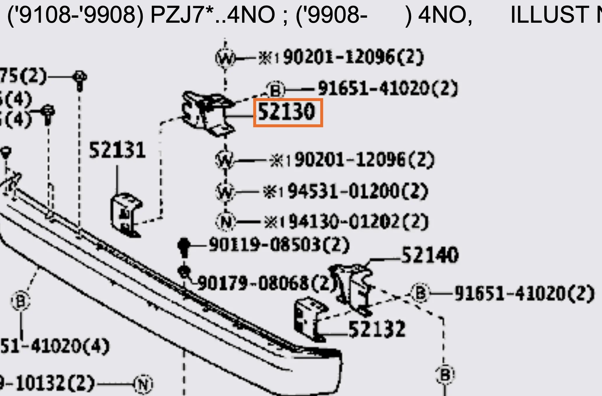

Are these the parts you are looking for? If so, it is for 8/99 builds and prior.
52130-60090
52131-60110
52132-60080
52140-60090

I just want to put in the stock, non-winch bumper. I can't find what parts I need.

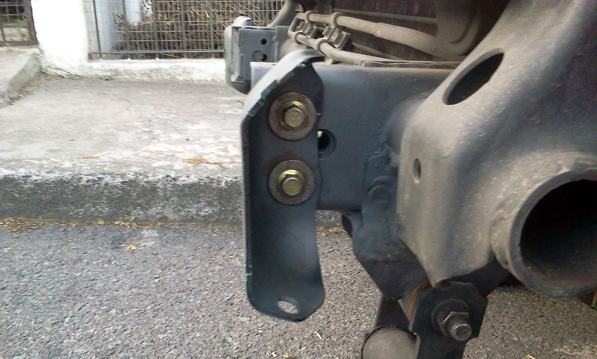

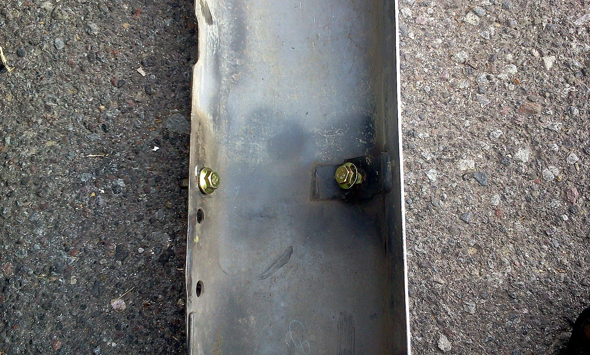

The bumper mounts you ordered, referred to as gussets by the parts catalog, bolt where the current mounts are.
This is how they go.
Left.
Right side.
The top bolt on the inside of the bumper goes into the gusset's upper notch. The bottom bolt goes through the gusset's lower hole.

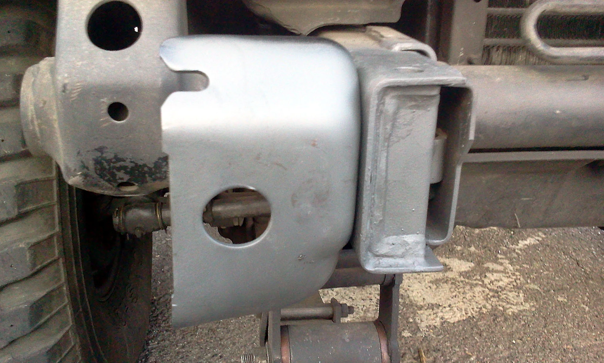

The front bumper's upper side is on the right side of the picture below.
Hope this helps.
