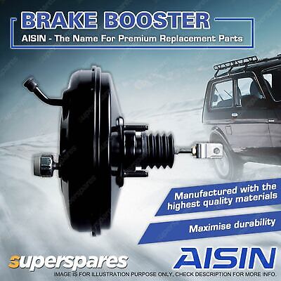

Since you're in Australia, you'll be able to find the Aisin BBT-016 booster, which should be good for any year HDJ80 as long as you have a 2-bolt master cylinder. They're going for around $320 AUD.
If you go this route, can I hassle you to ship me one? I need this for my RHD 80 series, but no Aussie shop with these in stock will ship to USA addresses!
Oh didn't see those - I'll check them out more. I wonder if they are an exact replacement for the Toyota originals? The part numbers changed quite a bit though my 80 being non-ABS might be limited to the ones it can use.
Can anyone confirm if there is actually a difference....? I have found a bunch of 90s Toyota’s seem to use the same booster (or at least share the same bolt pattern and work the same). I’ve used brake boosters from 80 series cruisers, hiluxes and even taragos in earlier 40/60 cruisers and the bolt patterns have all been identical (from memory anyway).
