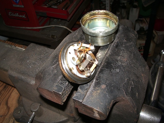

This is the inside of the oil pressure sender, the diaphragm moves the points closer together as pressure increases. Same sort of thing happening in the older fuel senders.
Yes, agree. The oil pressure gauge is 0-6V full scale, I assume the gas gauge is similar.
