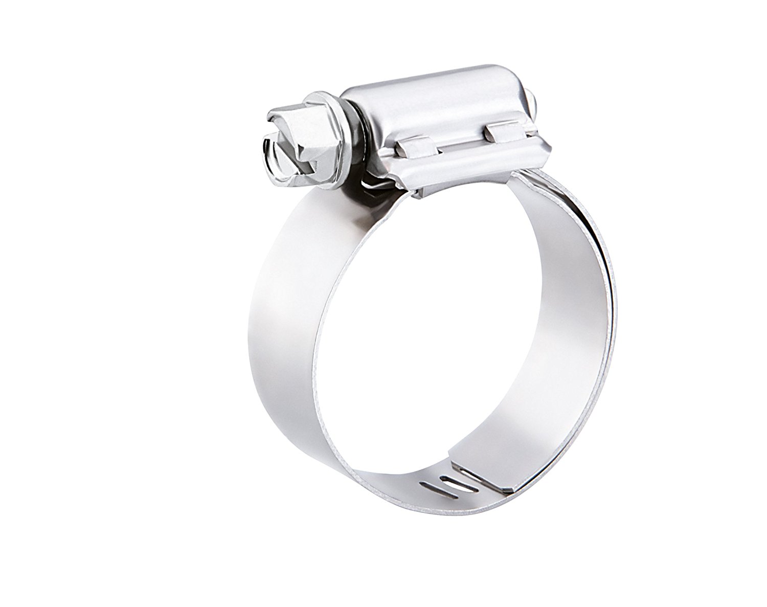

I'm probably going to use these Breeze Liner hose clamps.
Insist on factory bulk hose and hold it on with inferior worm drive hose clamps? Okay....

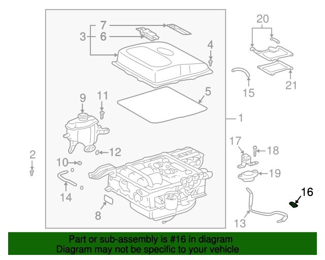

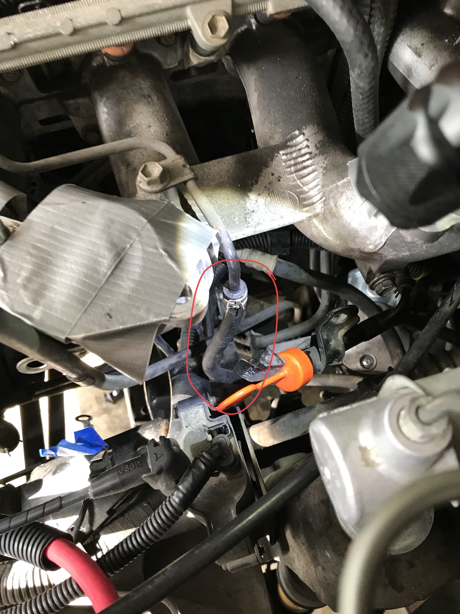

I think I screwed up and ordered the wrong thing. I was trying to replace the return fuel line hose from the FPR return line to the hardline at the driver's side fender. There are two hoses there. One is about 6" long form the FPR to the hardline under the manifold, and the other is about 25" long from under the manifold to the hardline at the DS fender. When I received my order, neither hose was 25"+ long. Which part number is for the fuel hose 25" long from the hardline under the manifold to the hardline at the driver's side fender well?
I looked all over the parts diagrams and wasn't able to find them either. :(
Does anyone else have a clue?
