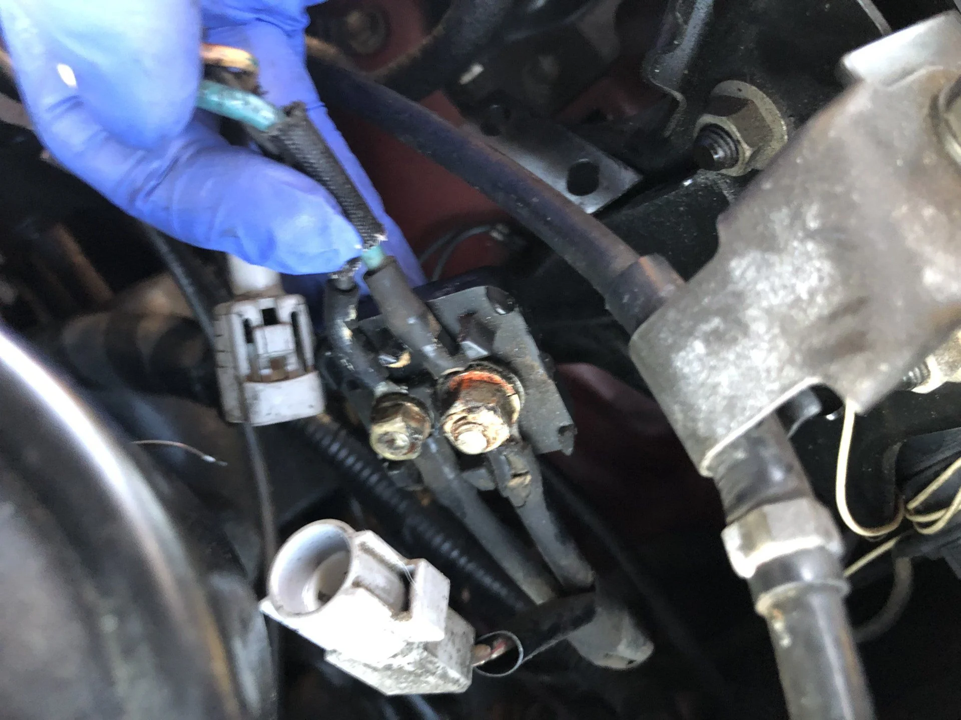

Hi all,
I just replaced my fusible link and now my 95 Land Cruiser won’t start. I left the negative and positive terminal connected and just carefully removed the fusible link. There was a little sparking, but not much.

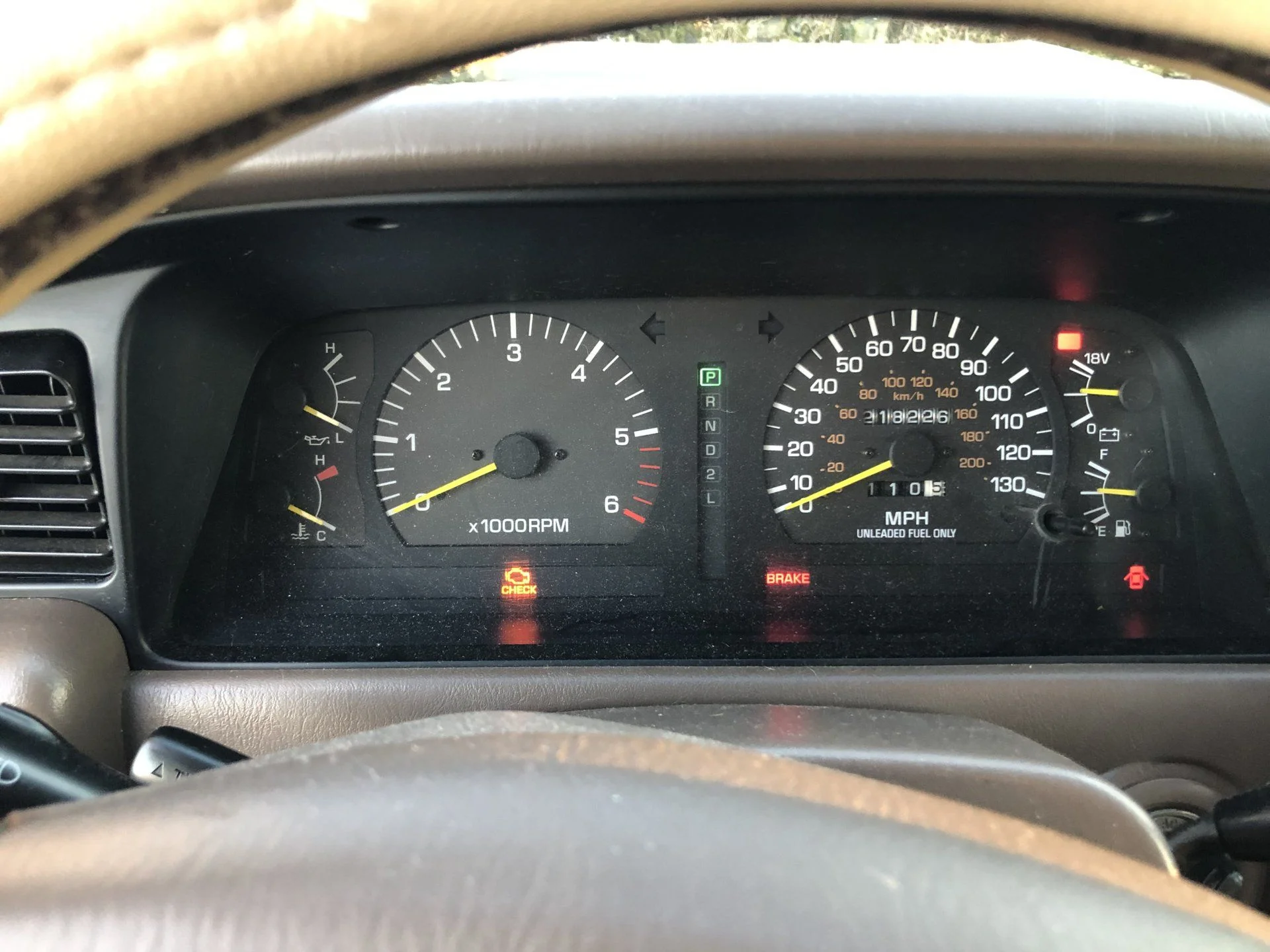

Most of the dash lights light up by the engine won’t turn over. How did mess this up easy job up?!?!
Did I blow a fuse?
Help please!
Needs to be super tight. You dont have any grease which I think improves contact. I salvaged the original grease on mine but I think dielectric grease would be fine
Did you remove the ground (and replace it) when you did the job?
I replaced the entire unit with an OEM bundle from wits’ end.
The bolts are as tight as I can get them with holding the fusible link case in one hand.
The wires are pretty damn grease free now. I didn’t save any of the old grease...rookie move. Can that cause the engine to not turn over?
Everything else happens, lights on, doors lock but it’s not turning over.
Btw I checked all the fuses and they look good.

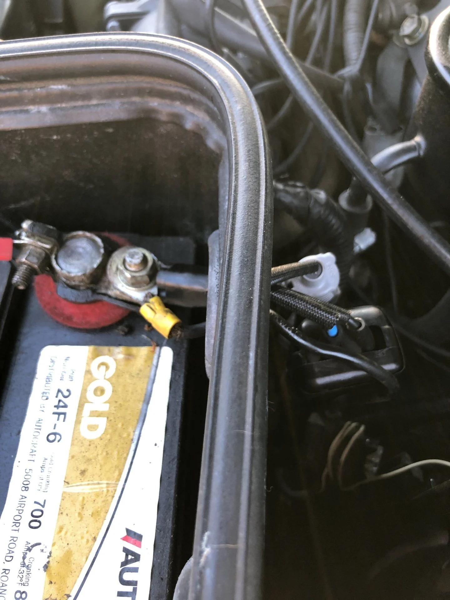

Yep! You guys are awesome! Thanks for all your help. I forgot the starter wire, it was hiding besides the battery box. Thanks!
I should stop working on my truck in the dark.
Reconnected and it cranked quite a few times then started up with a very high 3k idle that has taken a few minutes to get to 1,000 rpms where it’s hovering.
