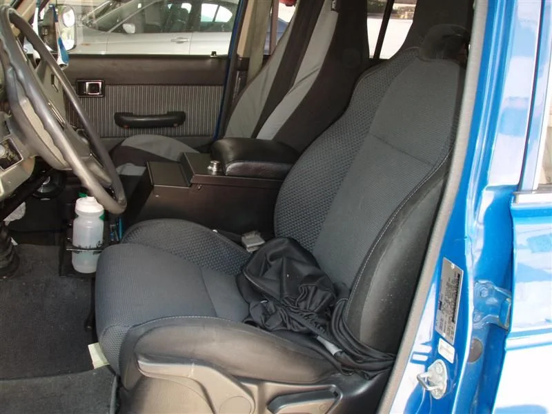

I have these on mine... with some minor fab.. they seat about 1" higher but are super confortable..specially on long drives...
attachment.php
lots of options. These are out of a Celica GT.
