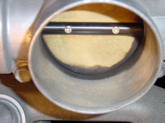

Try cleaning the throttle body. Sound like it's gummed up. Idle control is with the throttle plate. If its gummed the passages that the ecu thinks are open are blocked.

Link to the FAQ on throttle body problems ...
FAQ TB thread
LEXUSBEN's instructions on how to do the cleaning are in the thread above.
+1 on cleaning the TB.
I had a similar problem and cleaning it worked.
