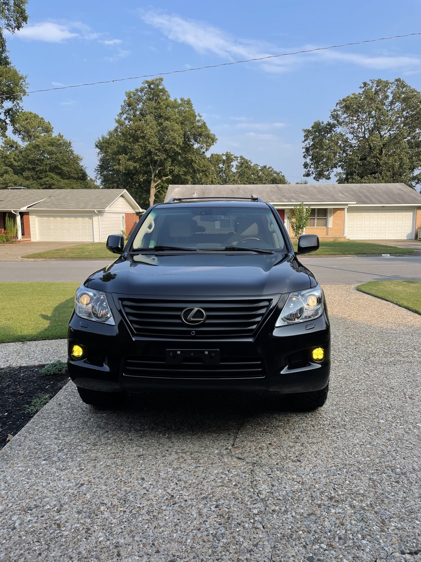

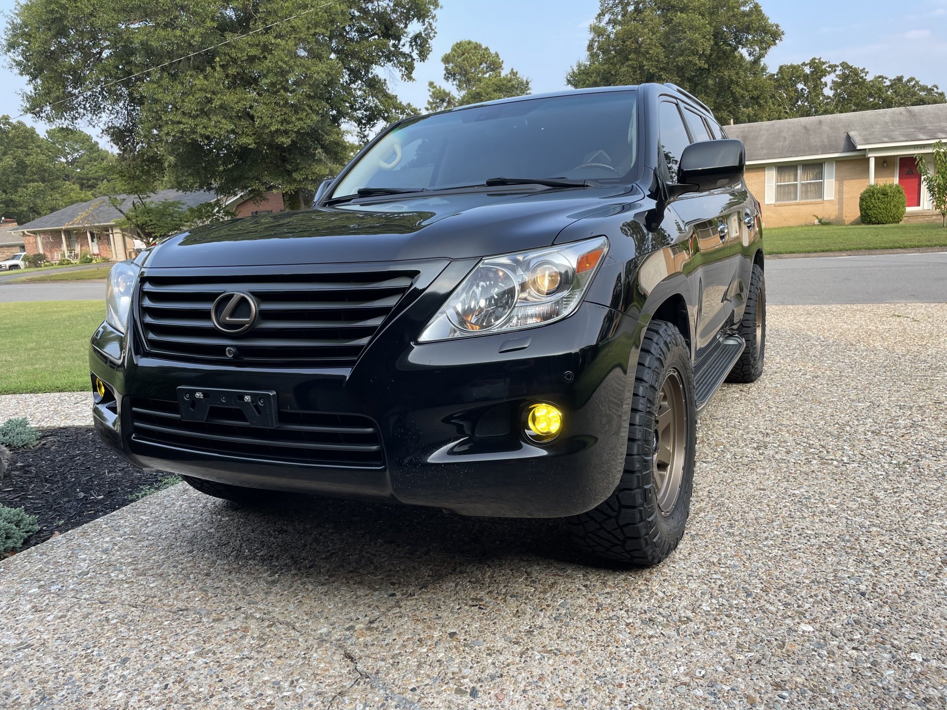

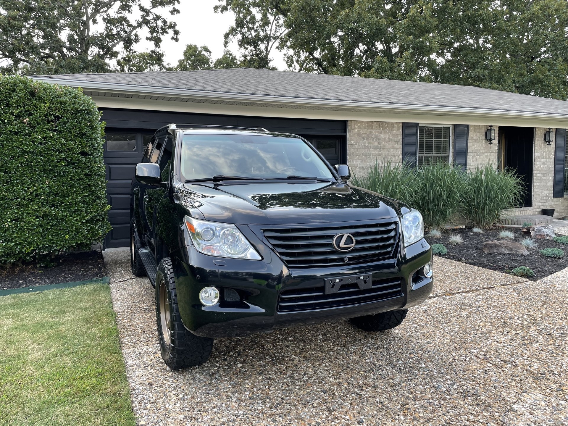

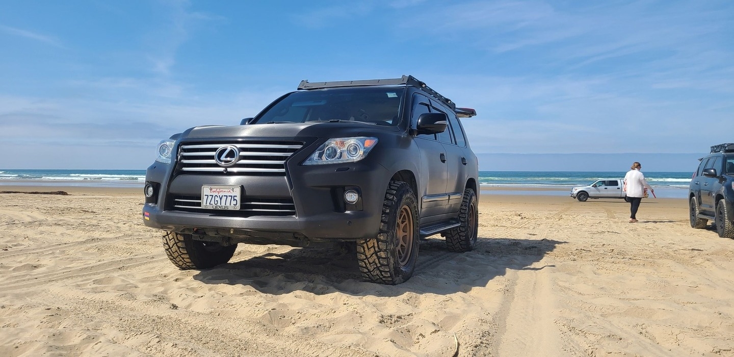

Well, the results are in. And unfortunately I cannot take credit for the paint work. After many tiresome hours of prepping, painting, wet sanding, reprepping, repainting, etc. I decided to take my parts to a professional with the right tools for the job. The aerosol cans were simply just not working for me. I think it was the touchipdirect clear coat that was poor quality giving me issues.
Thankfukly I was able to get refunded for all the paint I purchased through them; which was about $175.
Here is the final result:
Wow, looks really awesome It's exactly like I wish mine looked!
Thanks man! If you don’t mind spending the money I think it’s totally worth it. I enjoy looking at my LX so much more now. I do not advise trying to do the work yourself. Just pay a pro. I did all the disassembly and prep work so the painter didn’t have to mess with any of that. They were 100% ready to paint when I dropped them off, shy of cleaning the surfaces. Last step, door handles and fog lights!
I also need to get plugs for the front license plate and remove that bracket.

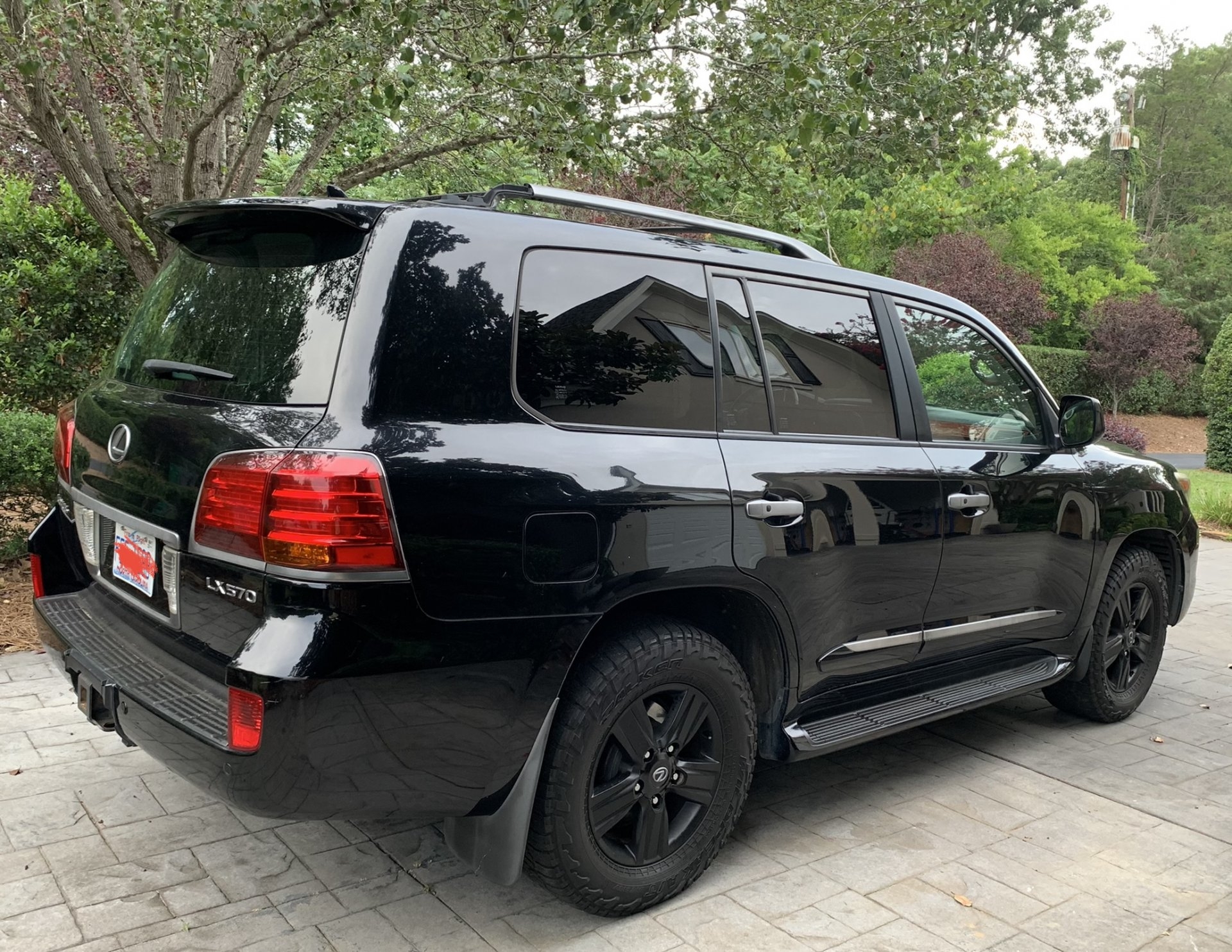

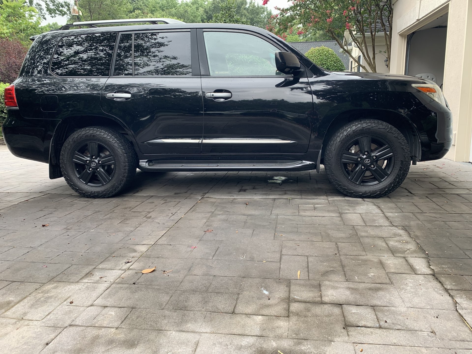

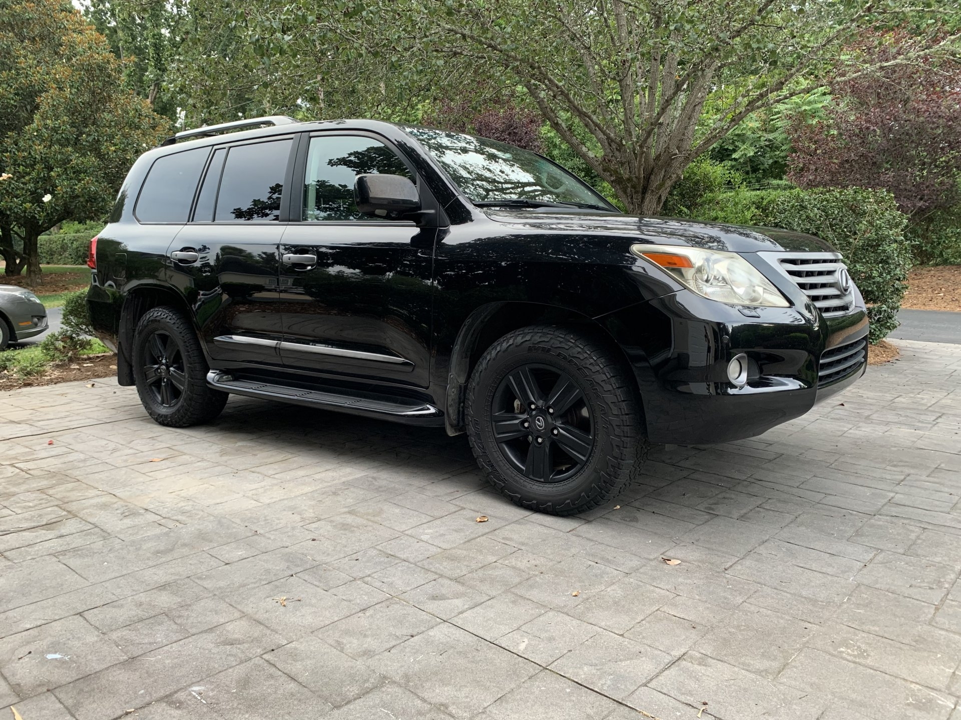

Ok I’m happy to say my deblinging and transformation phase of my soccer mom kid hauler to a proper truck is officially done, for now. The last piece of the puzzle was my stock 20” wheels, which I am happy to have figured out with some lucky lc200 help from @NHouston and some well implemented crafty emblem tips from @fjcruising …(Chinese chrome wheel caps, remove emblem, jbweld then plastidip). Now I just need to address the lug nuts.
I am quickly realizing that while I dig the look of the smoke plastidip on the rear trim, emblems, grill, and fogs… it doesn’t work very well on the handles when my kids use them… so might need to follow @Zarchery ’s lead and do those the right way.
overall I feel like the appearance has been fully transformed, I’m now driving a truck who’s capability isn’t hidden behind flashy bling.

View attachment 2750406View attachment 2750407View attachment 2750409
Looks legit! Really digging the wheels.

So, did you dip those handles or have them painted? I’m pissed off looking at my chrome handles.
I dipped them and all my chrome using “smoke” which I love the look of overall. Takes off the bling without full murdering it out. I blacked out the chrom on the base of my windows though.
I’d suggest if u have kids this is not the best option for the handles. Def starts to come off with careless usage. It’s holding up great everywhere else (fogs, grill, emblems, snake blinders, rear tails, and rear hatch)
I’d recommend taping off everything specifically the back on the handles where the sensors are, and protect the car paint for less cleanup…. Use an old goofball to pull and keep the handle open before u paint so in gets in the middle parts.
I love the look but the durability on the handles is directly tied to how careful u are using them when opening the door. My drivers handles still looks great but the other ones the family uses are starting to peel.
