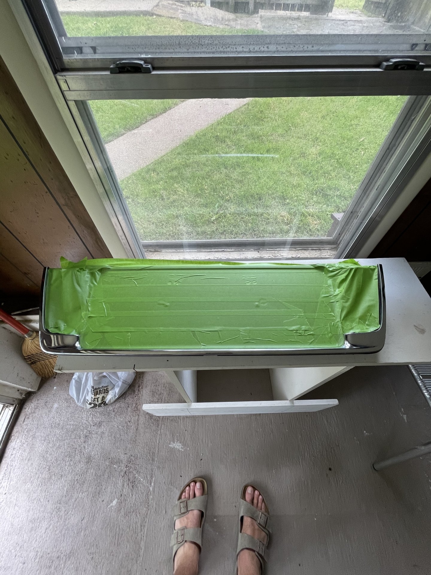

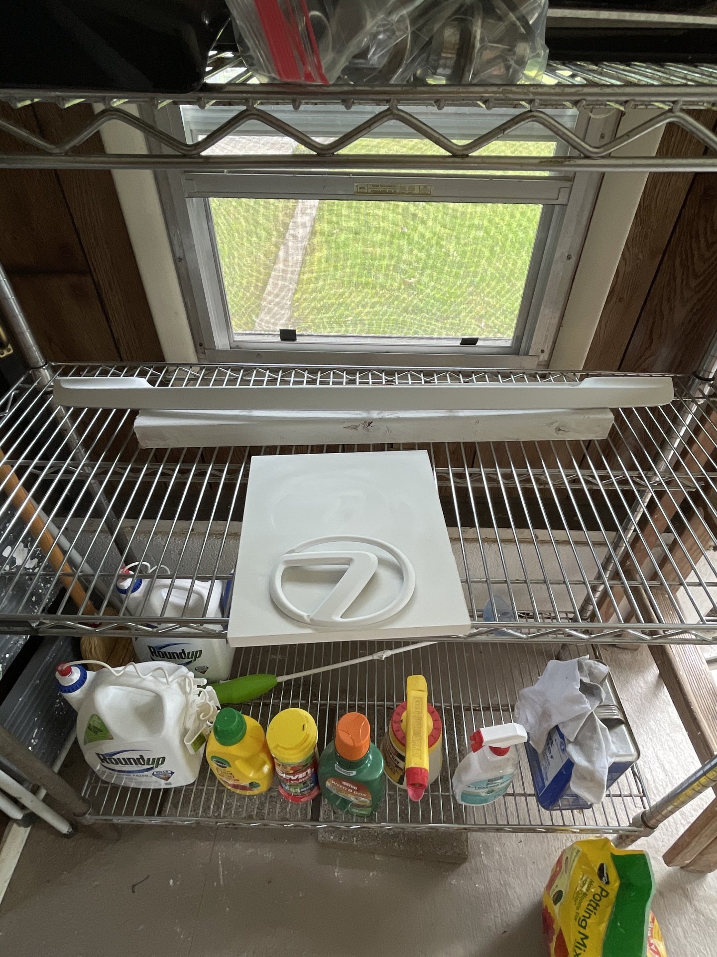

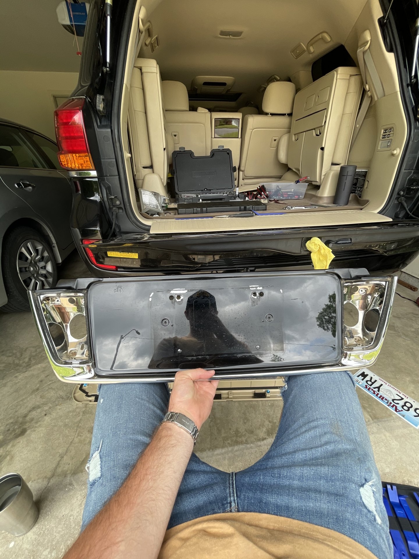

Okay, so I’m in full swing on the dechroming project. I’ve been working on the rear gates and window belt strips. Getting the chrome bits off the tailgates isn’t too challenging; but having a panel tool kit will make your life so much easier. The belt stripping is a different story. Everywhere you read people will say “it just pops right off.” Hysterical. The last thing that belt stripping does is pop right off. Ended up using a panel tool, patience, a hammer, and pure aggression to remove them and not damage them. If anyone wants to remove theirs give me shout and I can potentially give you some pointers.
Here’s where I’m at in my process:
Remove parts
Sand with 220, 320, and 400
Apply adhesive promoter
Prime
All my pieces are drying and will add pictures of the belt molding tomorrow.
