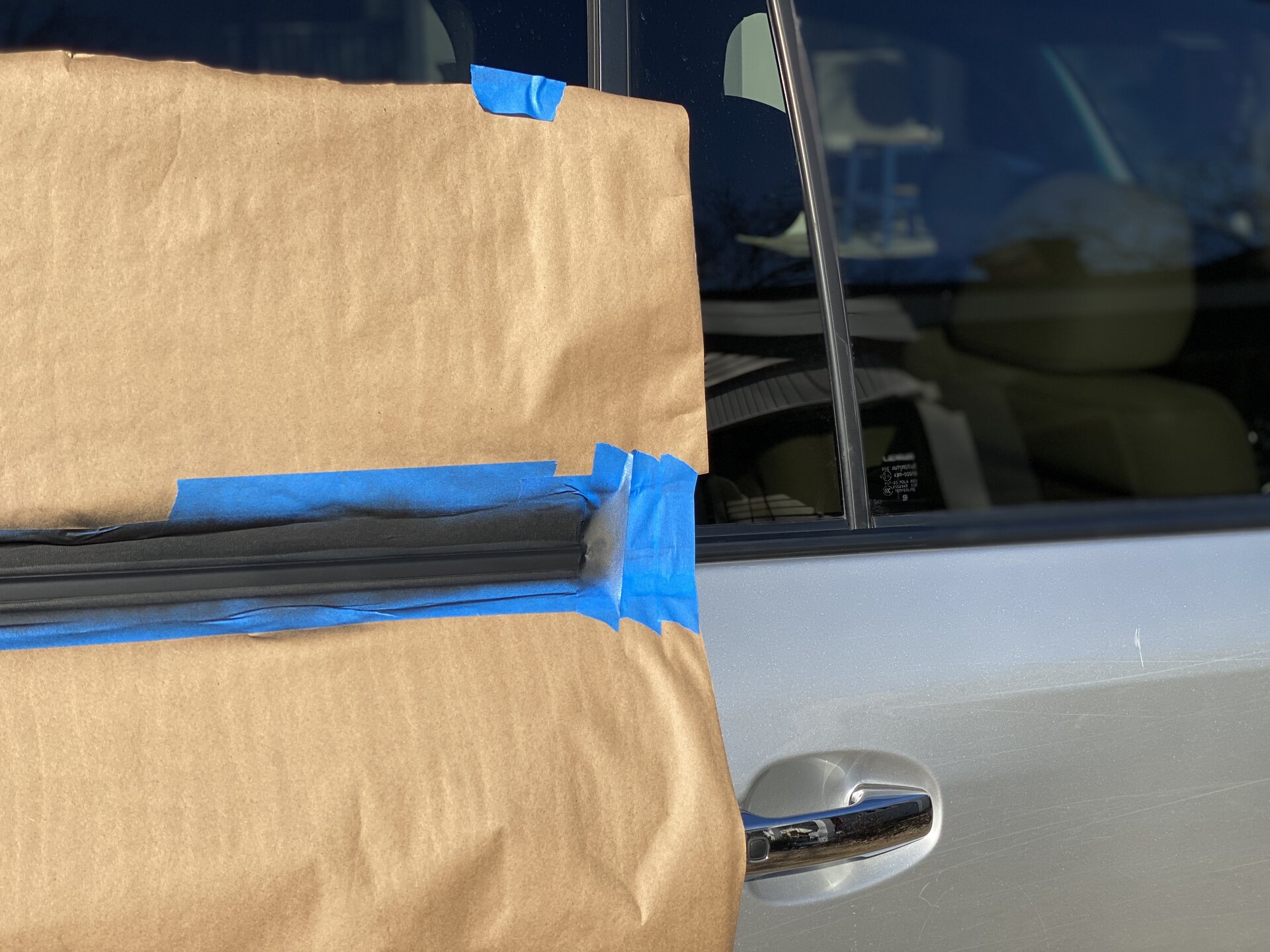

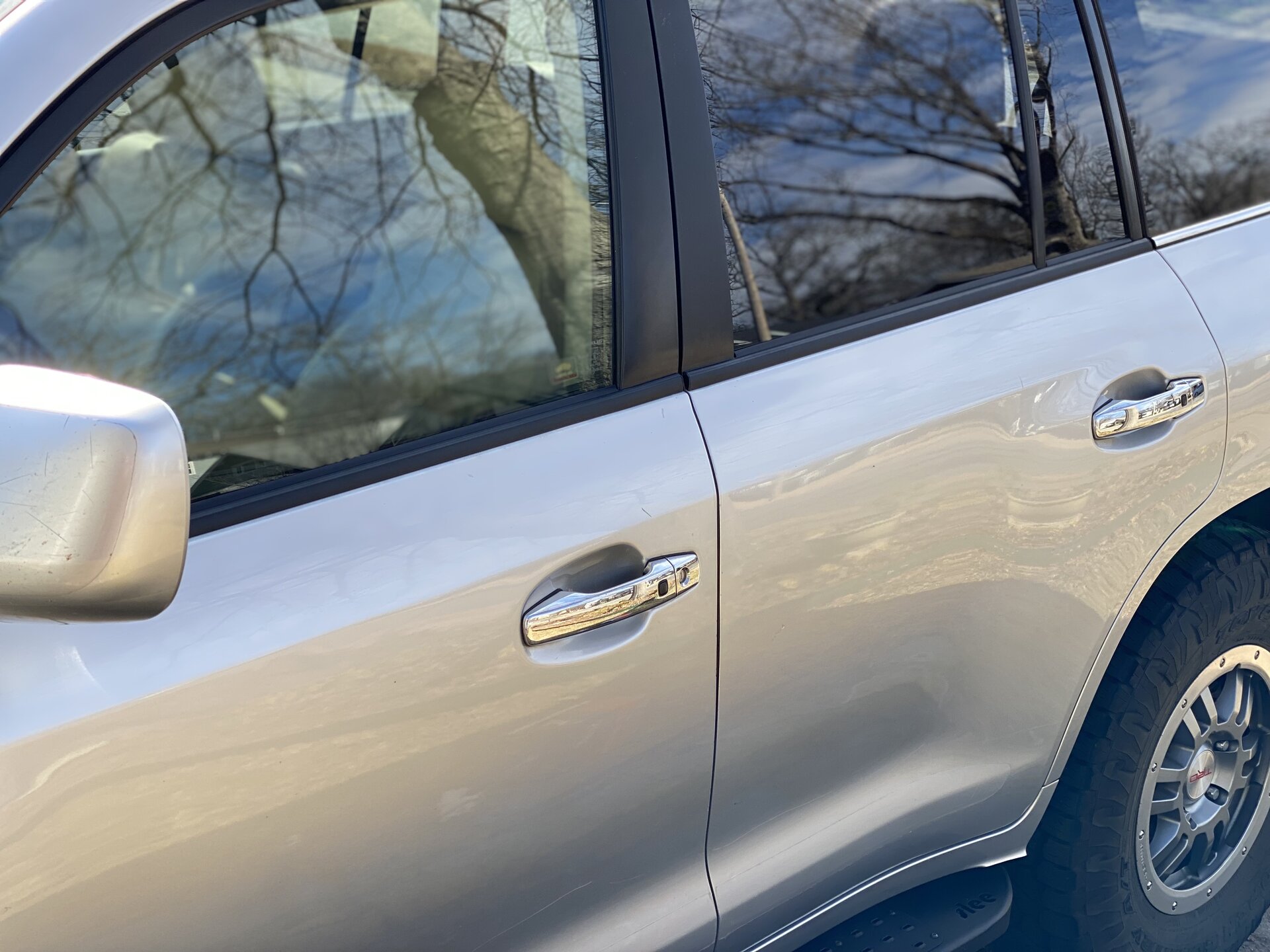

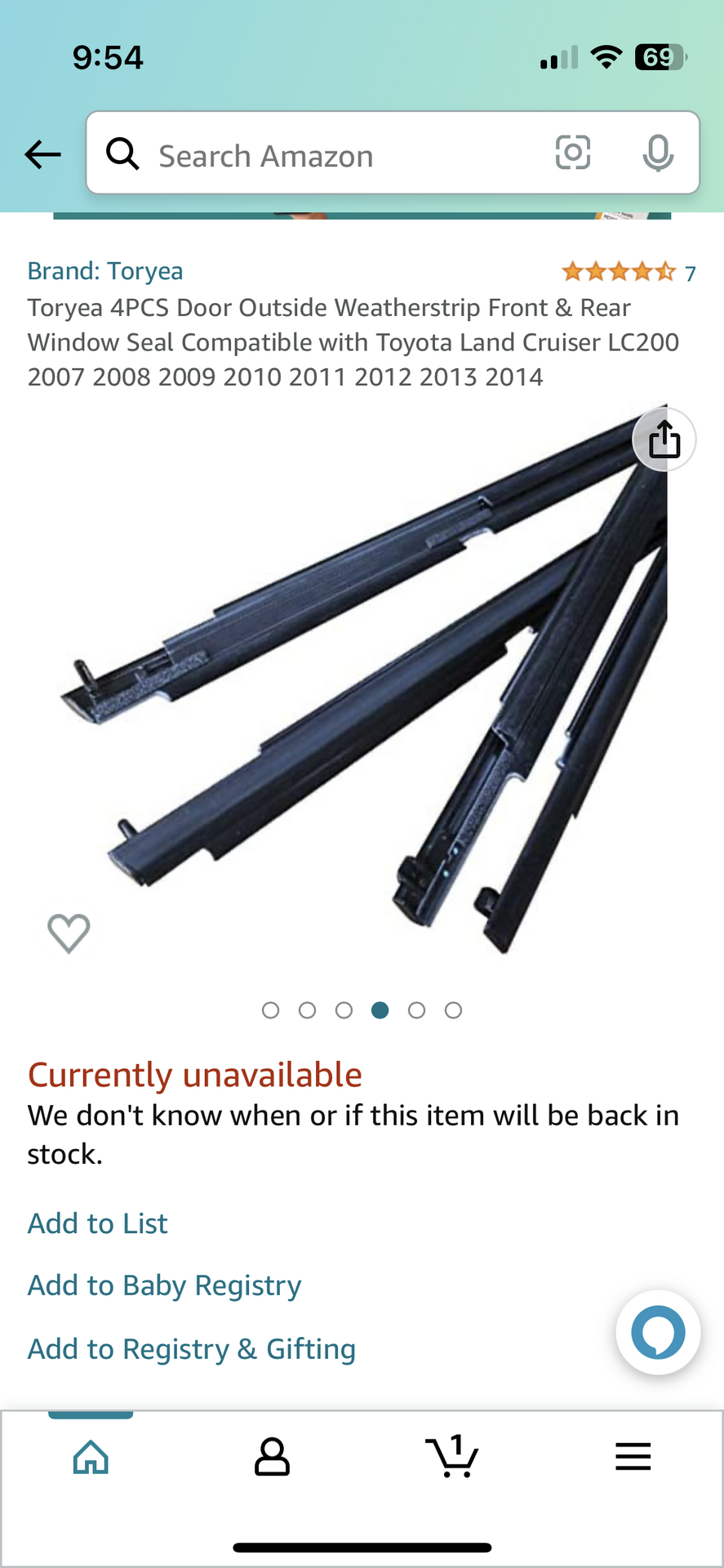

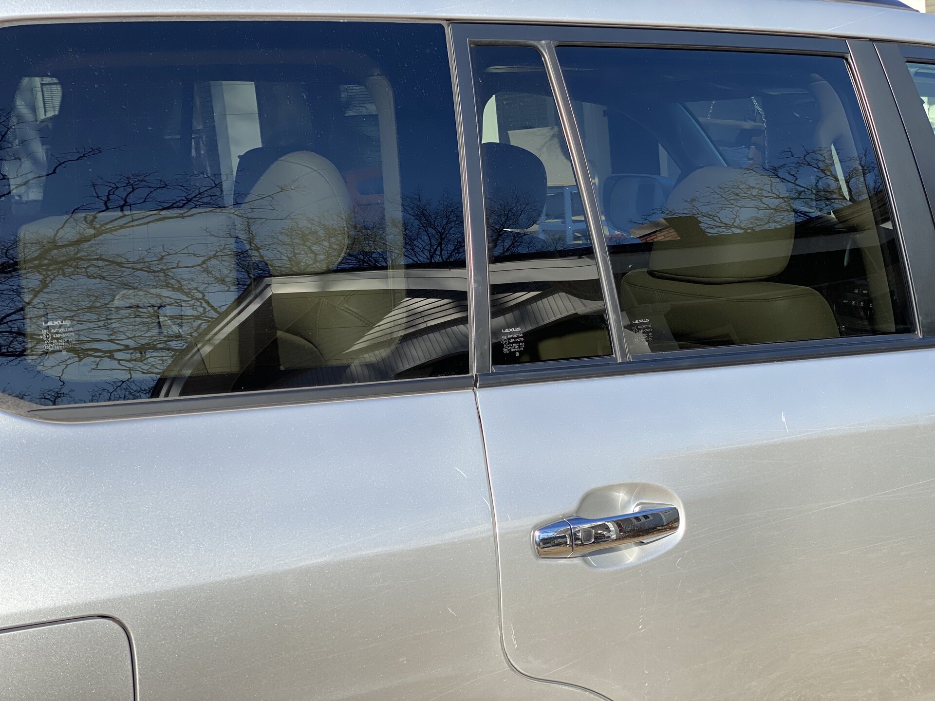

Got my Amazon cheapy belt moldings. Product looks pretty good. Lighter weight than my LX moldings, but the LX moldings chrome parts are actually a big strip of sheet metal.
took me less than 2 hours total to replace the moldings and to paint my 3rd row chrome bits. Used a flat black paint I found at ace. Lightly sanded. We will see if it lasts, but looks fine now. Pretty good match. The only trick I can offer is look at the replacements to see where the clips are and press those, it won’t move much after that. To get them off (and on) you have to roll them out of the window frame in a somewhat circular motion. Broke the clip on the first one, but rest came out clips in tact.
we will see how long everything lasts compared to OEM.
