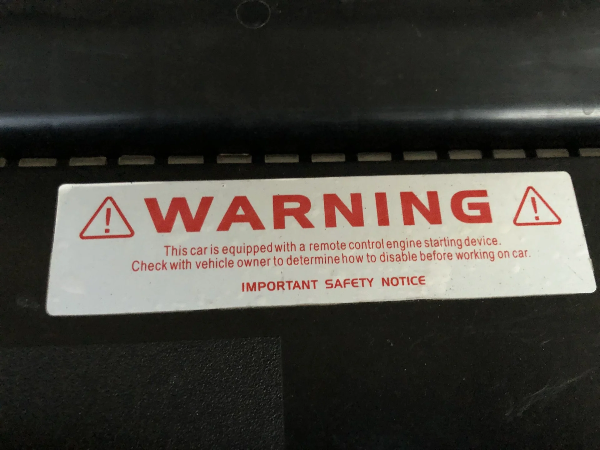

1. I have a sticker (It looks like an OEM sticker) under the hood saying this car has remote start. However, I have tried at-least 20 times all sorts of combos but can't get it to work. Any tips to figure out if the system is still there or was uninstalled? Maybe also get a build sheet (how to get one?) to confirm if this was a dealer option?

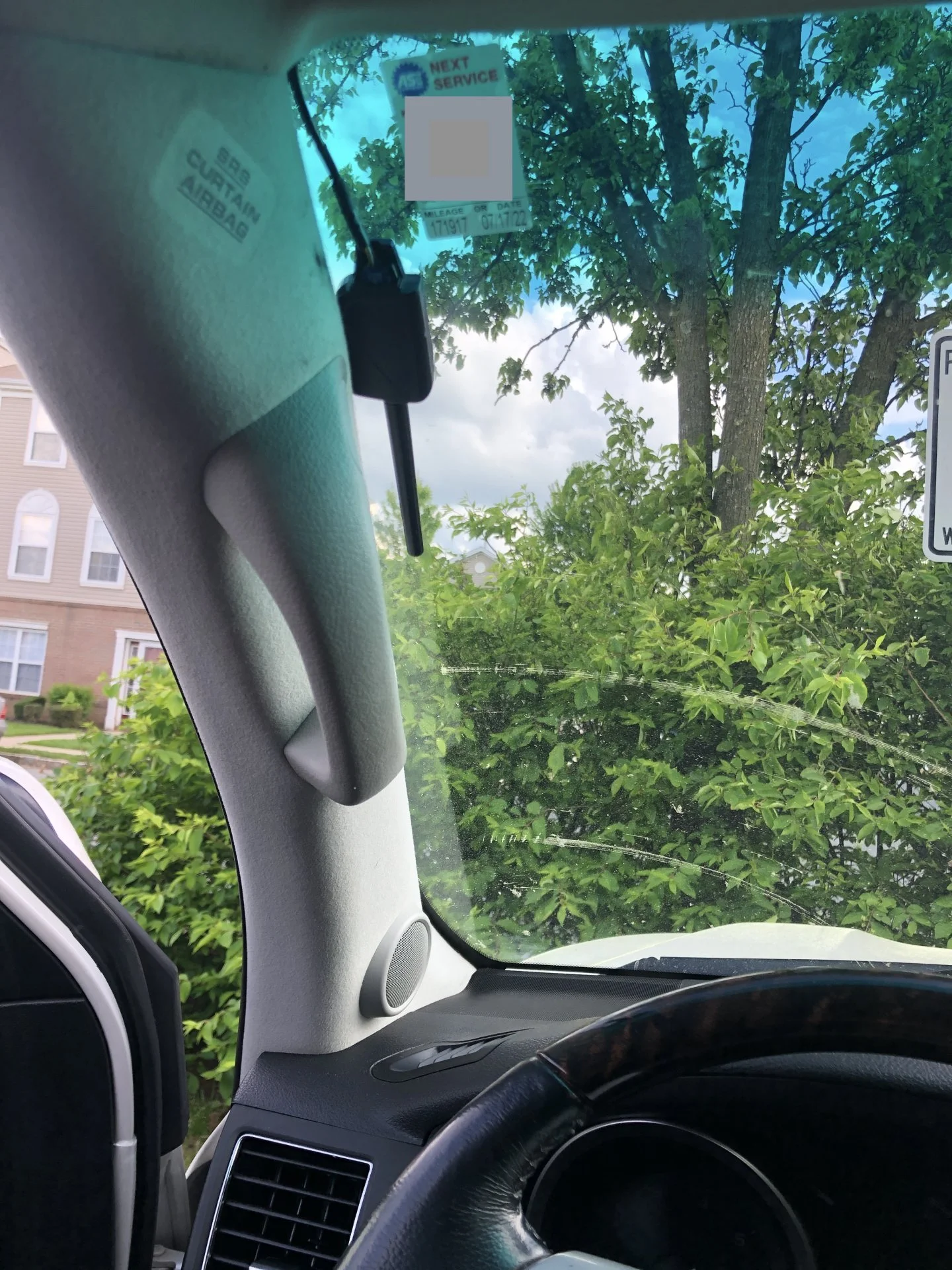

3. It looks like an additional FM/XM antenna but does anyone know what it is? I don't want to pry open panels to track it. I don't see an accessory mount or any signs of accessories inside the cabin. Worst case, I will just cut the cable, tuck it under the panel, and throw the antenna away if not supporting anything mission critical.
#1: That doesn't look like the OEM sticker, I thought it was yellow.
#3: I have an antenna very similar to that in the same spot, and it is for the CompuStar remote start system.

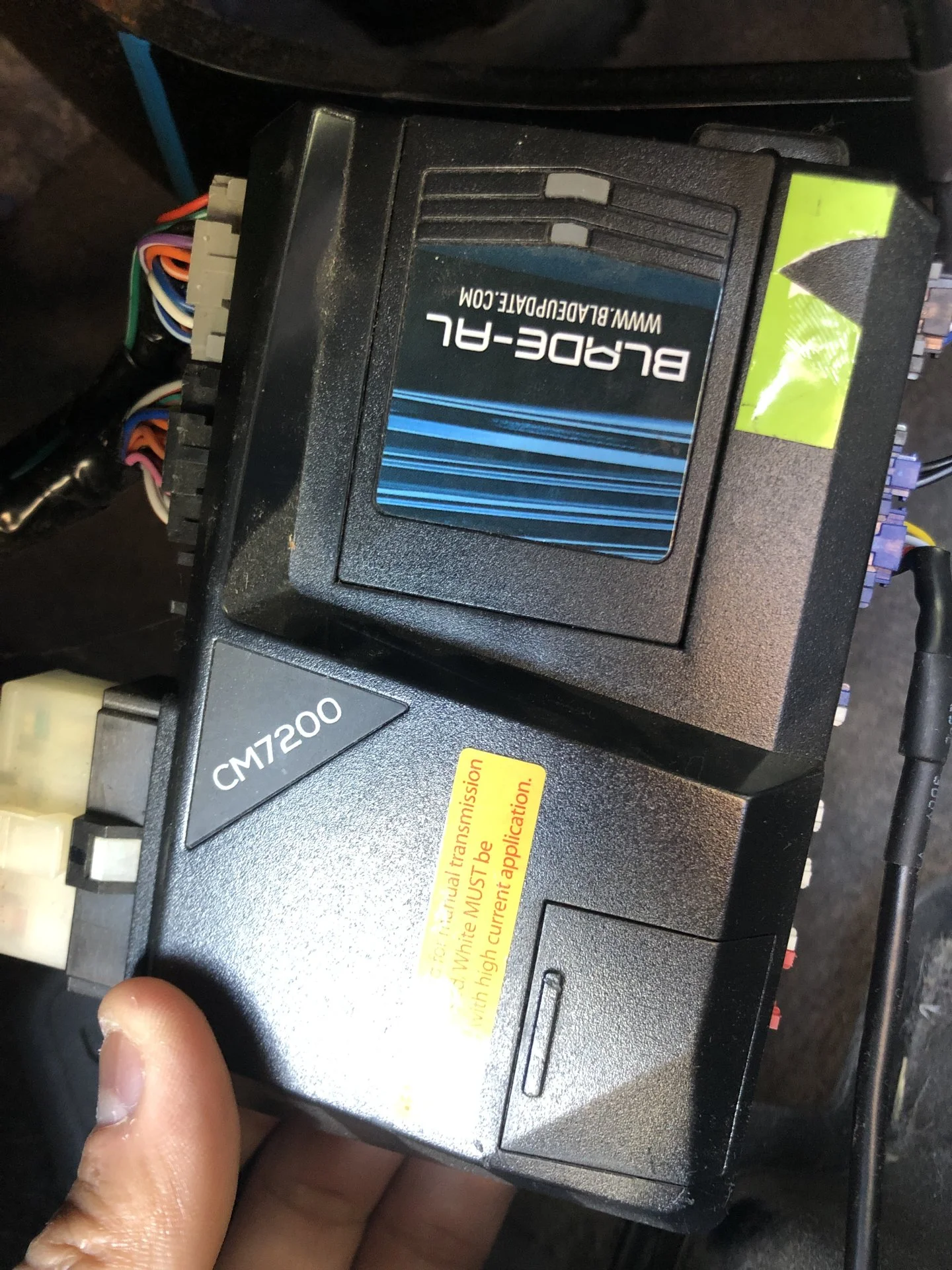

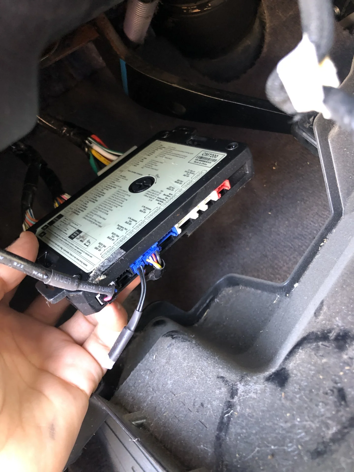

I guess I am going to remove some panels and see what make/model the system is and how to make it working again!

I know what it is!!

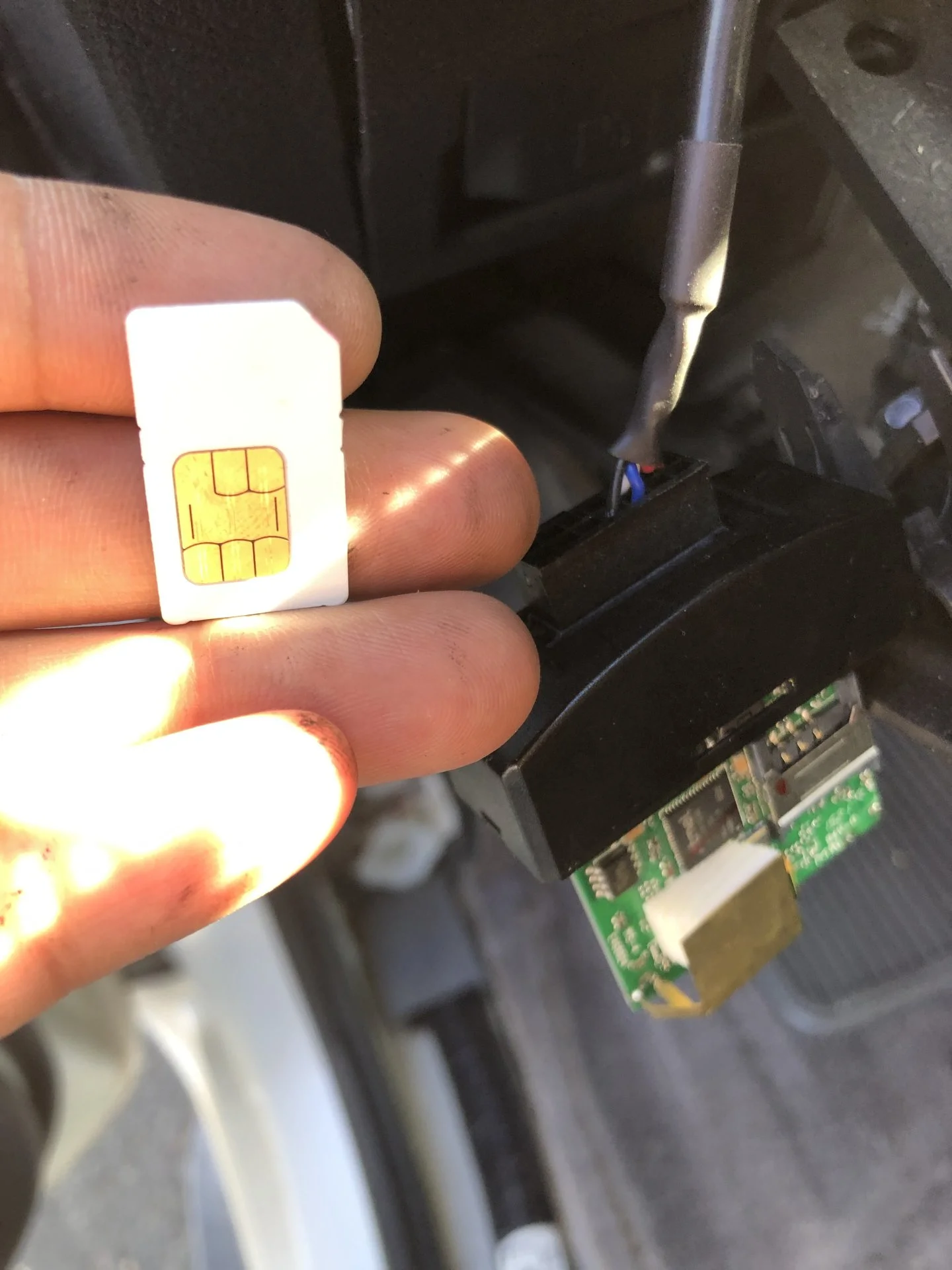

It is a Compustar CM7200 remote start unit. I pried open some panels and traced the wiring. The antenna is a 4pin antenna so the previous owner likely had a 3mile remote (still trying to contact him and get the remote). I also found a Drone 3G device underneath with a SIM. Drone and Compustar units are both connected. The combined system allows GPS tracking, geofencing, speed alerts, remote lock/unlock/starting from mobile app anywhere in the world.
I can't use the 3g GPS tracking unit because 3g isn't supported anymore. Drone is running an upgrade campaign where they will give you a new 4G device if you purchase 1year subscription from them. I will try to get that upgrade and will swap out the old 3G unit.
A new Compustar remote can be purchased and synced too. So if the previous owner doesn't send it, I will just buy one and pair it to the system. Compustar does mention that toyota OEM remote work too... but they don't in my case. Maybe they also will need to be paired first..
